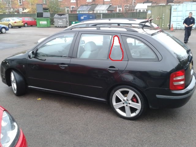

Hi guys, I need to find a window for my Skoda Fabia Estate 2003. It has been shattered. But the problem I have is, that I don't know the name/type of the window. Please help.
I've marked in red the window I'm after.
Please tell me how is it called and possibly where I can look for one, I'm based in Portsmouth.

Should be part number 6Y9845209B for clear glass.
Or 6Y9845209C for green tinted.

Standard motor trade nomenclature would be:
Nearside rear passenger door quarter light
Windscreen fitters would know exactly what you wanted if you asked for a quote like that.
I had an attempted theft of my polo classic which is a Y reg (must have been a desperate criminal) who smashed the rear door quarterlight and couldn't find a replacement  from VW or from the web. Took it to Autoglass and they found one with the correct tint etc with no problem at all.
