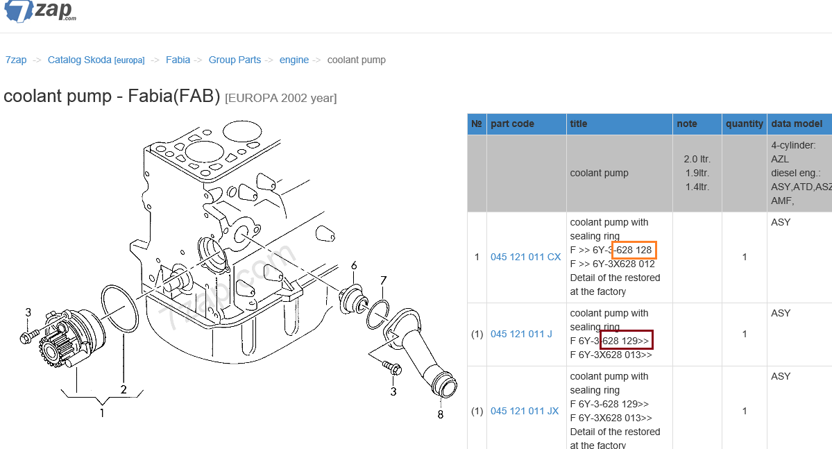

The key to understanding the chassis numbers on the 7zap pages is to discard the first 6 digits of the VIN, then turn the 9th and eleventh digits into dashes. So your VIN would become 6Y-3-738651.
If you now look at the appropriate column on the 7zap page you can see that the first part number (ending CX) suits cars with numbers up to and including 6Y-3-628128; the second part number (ending J or JX) suits cars from 6Y-3-628129 onwards, including yours.
The same number ranges appear under the 'fitment detail' tabs on the ECP website.
I think the X as eleventh digit refers to cars built in Poland rather than Czech, which yours isn't/wasn't, so you can ignore those lines.

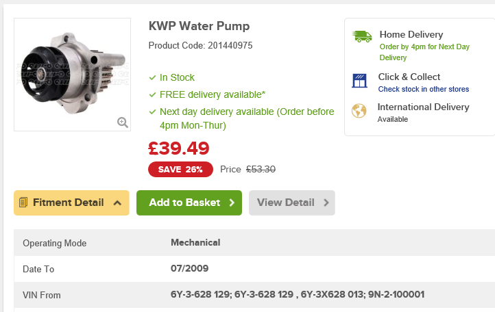

This just goes to show how unbelievably rubbish their 'Look up by reg number'  system is.  Yesterday, before knowing your reg number, I just put in your car details instead, and it gave me a choice of 4 results, two of which gave Polo VIN numbers in the 'fitment detail' section, and two the Fabia numbers, like on the 7Zap page.
Putting in your reg number instead, it gives just two results - just the ones with the sodding Polo VINs in the 'fitment details' sections!  no wonder you were struggling!
Anyway, going back to doing it with car details instead, I find this one with the relevant VIN details as per what we discussed with the 7zap page:
