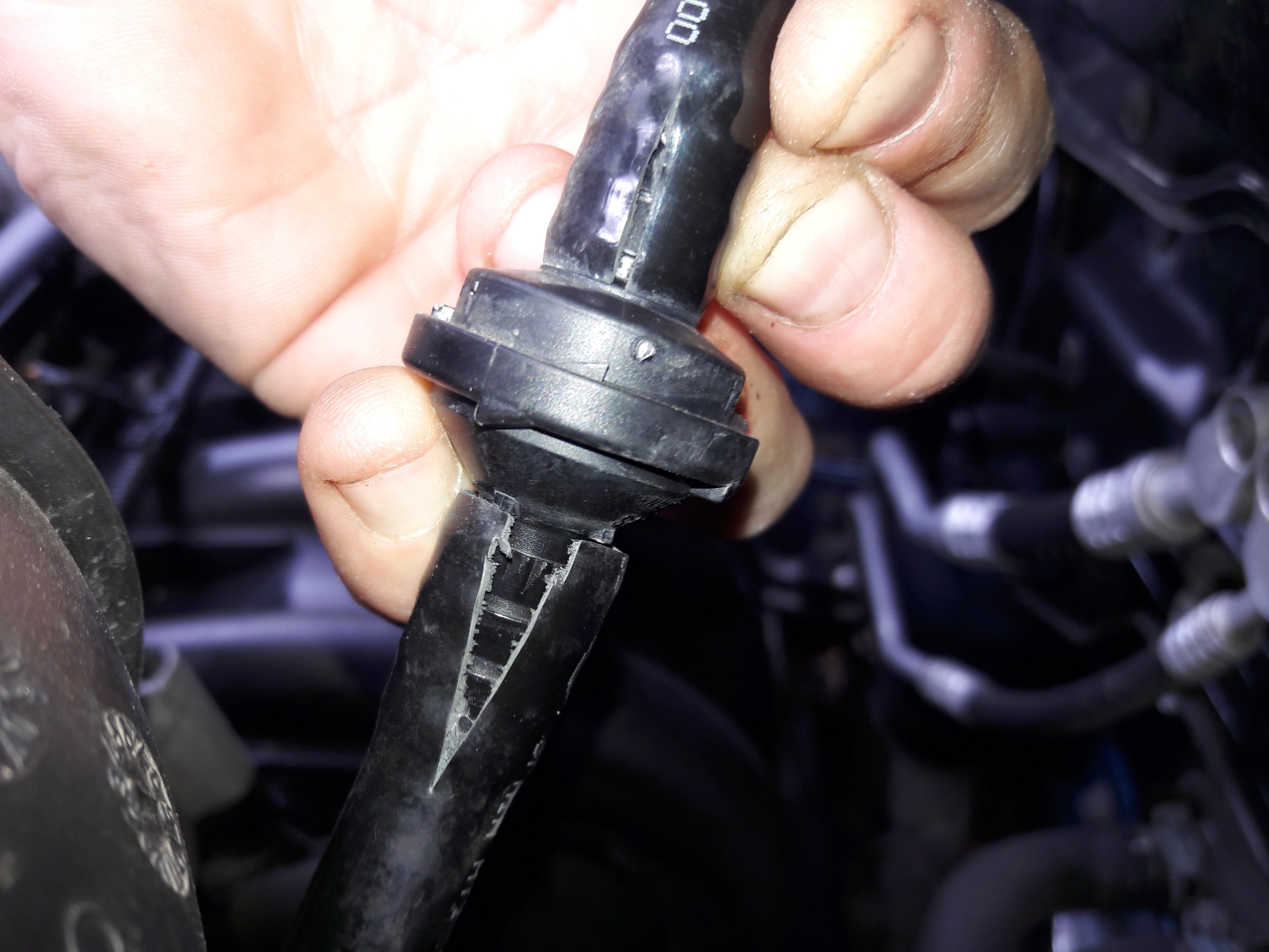

I'm not sure whether it's relevant, but it's well worth having a good look at the brake servo vacuum hose anyway; the points where the hard plastic tube sections go over hose barbs at each end, and either  side of the non-return valve, seem very prone to splitting. Just found one on a friend's 2005 Polo hanging on by a wing and a prayer either side of the NRV, whilst doing a completely unrelated job on her car.

^ Wow, look at the state of it!
