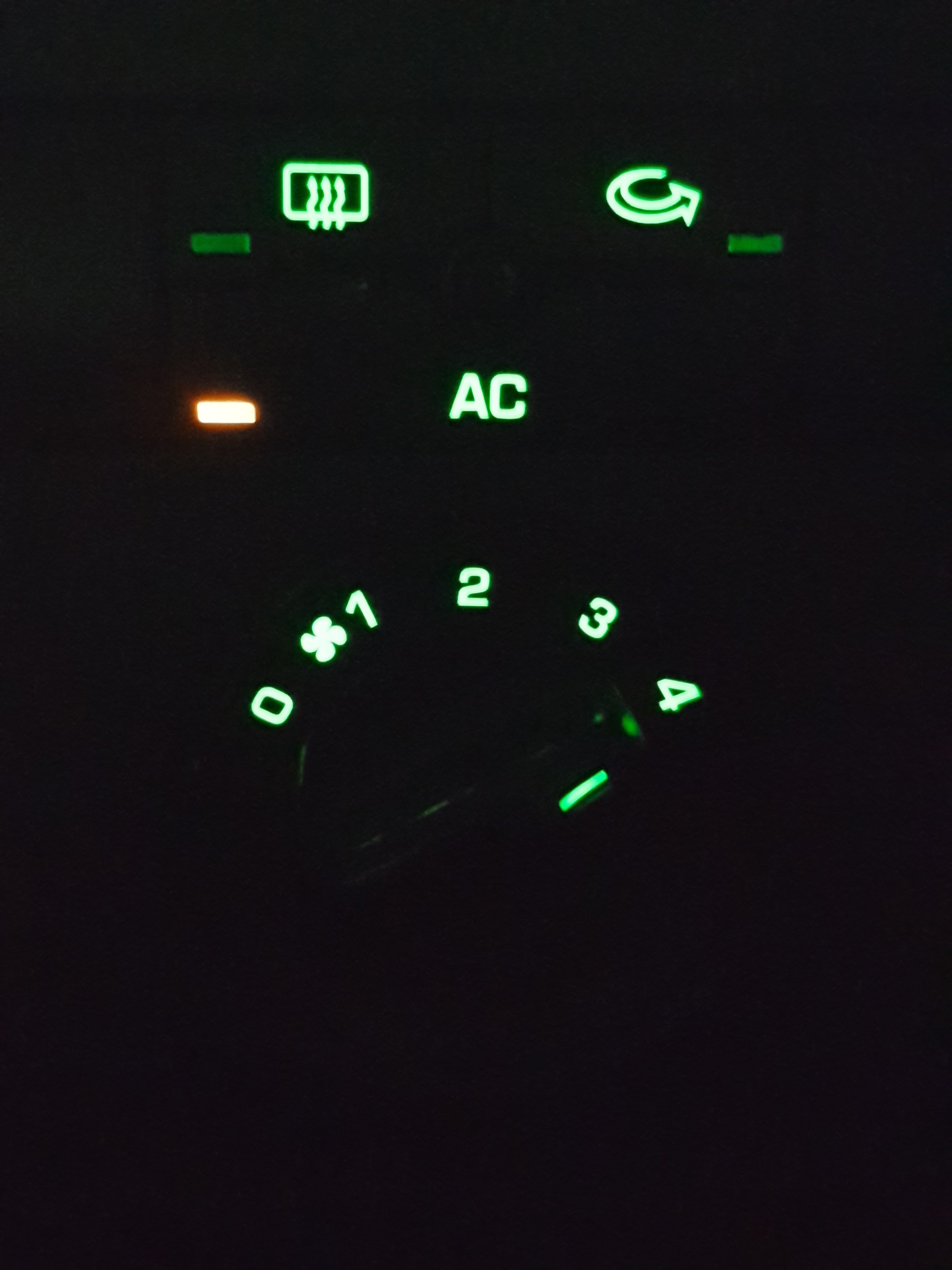

Hello, so my skoda octavia's AC isn't working properly, it only works when i put it on the "fourth mode" which is max power it simply doesn't blow any air on other "modes"...
Skoda Octavia 2008 1.6mpi
Sounds like the resistor on the fan has gone to me, change that and it will be all good.

Thank you ill do that and tell if it helps ❤

Hey, so I swapped out the resistor and the AC is working fine again so, much thanks!
That's good, thought it would be something as simple as that.
