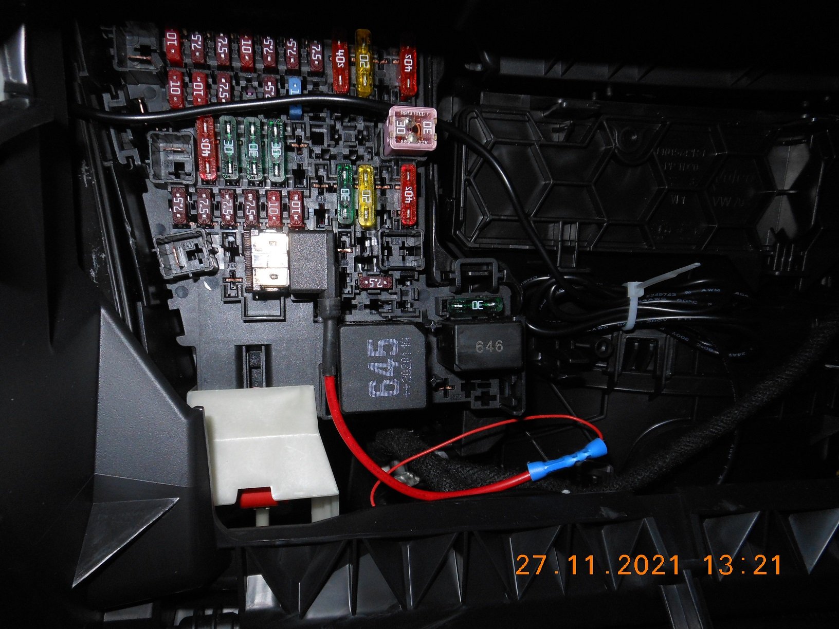

1:  I can't understand the issue with the piggyback fuse holder and blue 15amp fuse ( rear wiper ).  Yes, if you place it with the power lead coming out the bottom, that large metal electric seat fuse will stop the piggyback assembly from seating properly but all I do is place the fuse holder the other way around  i.e. so the piggy back fuse assembly now covers the brown 5amp and pink 30amp fuses to the right.  I use the piggyback fuse holders than come with NextBase cameras - seems such an obvious solution?  Perhaps the OP's fuseholder is of a different design.

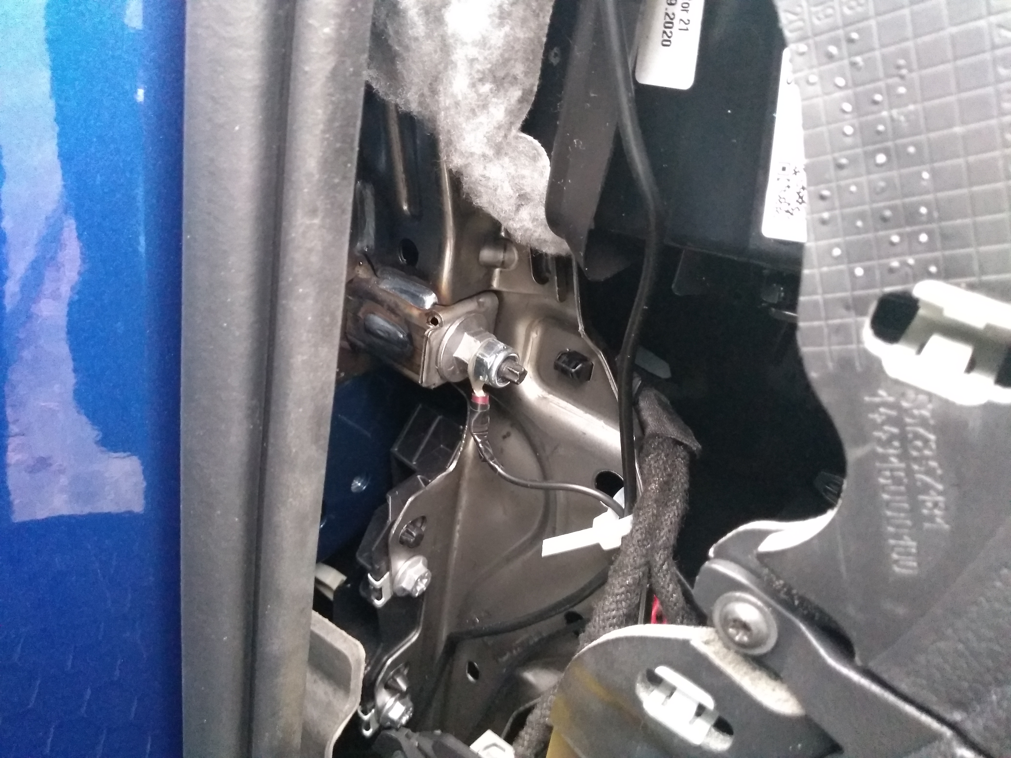

2:  I don't unscrew any bolts to get my earth. Again, from the excellent pics taken by the OP:
All I do is use an m8 nut on the exposed thread in the above pic so you end up with:
Hope that helps someone.

    The hardest part is accessing the fuse box, Skoda's instructions in the owners manual aren't the clearest.   Sat in the passenger seat (right hand drive cars) the glovebox damping arm is loc
  • This method of dash cam installation has a few benefits: The dash cam is plugged into a switched live power source i.e. the dash cam automatically powers up and powers down in sync with the ca

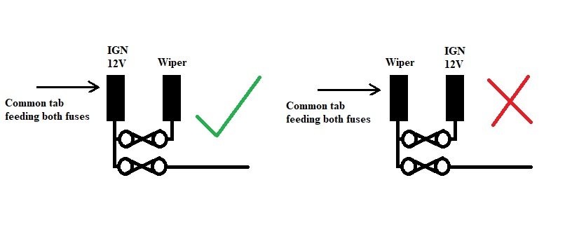

Something I couldn't find the answer to was the correct orientation of the piggy back fuse. Both ways round will actually work but electrically one is wrong and one is right. I've attached a drawing to explain it better.
On mine, the Ignition 12v terminal was on the top and the connection to the wiper was the bottom.
Thanks again to everyone.

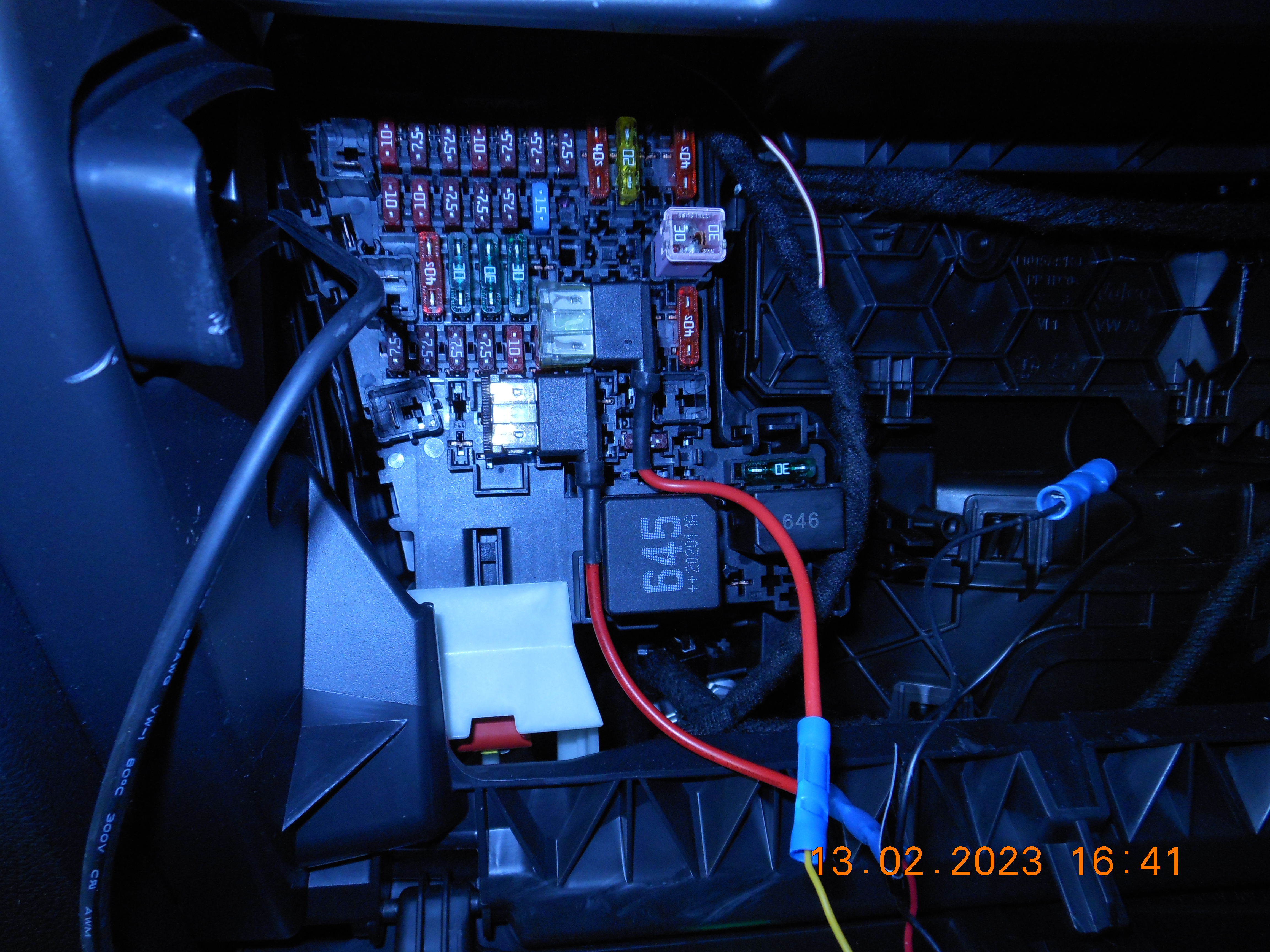

Just an update for anyone tackling this.
I upgraded my Blackvue dash cam for a new model, unfortunately the new camera needed both ignition +ve and perm +ve connections, so out with the old cable and in with the new.
Two piggy back fuses.
Ignition +ve - Fuse 47 (Rear Window Wiper)
Permanent +ve - Fuse 40 (12-volt Power Outlets)
Hope this helps someone.

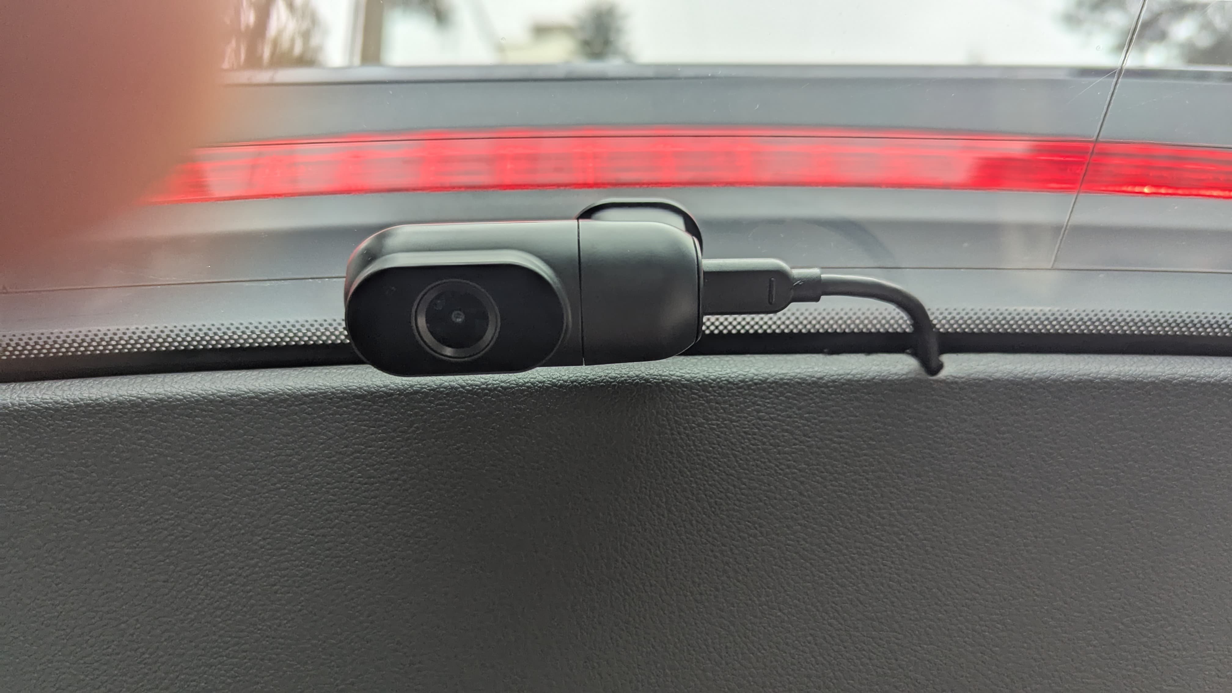

This is such a well documented guide. Thank to so much for all the pictures. It has helped me a lot. Quick question - Does your installation also include a rear dashcam? I am trying to find a safe route for the rear dashcam wires and I am considering routing it via the floor panel instead of the headliner. Can't find any documentation around that. I assume you installed only the front camera?
Hi Sudeepg, I installed a rear dashcam and threaded the cable through the roof lining. I used a glass fibre rod (as used by electricians) to pull it through. Just make sure the cable runs behind the airbags - as close to the metal body, not the cosmetic stuff.
If you check through the early posts in this thread, you’ll see where others (including me) had an issue and found a work around/solution from this forum.
Thank you Sven57. The 2023 Kodiaq, as you may know, also has the panoramic sunroof, and pulling a wire through the roof liner seemed tricky, but I will take your advice and route it behind the airbags, close to the metal body. (Just not sure how to secure it). Since the airbags deploy downwards, it should not be an issue I suppose. I wonder if the loose wires will move about.
Due to the roof lining and insulation, there’s not much room for a cable to move. Mine doesn’t have a sun roof so I don’t know how much wiggle room you will have. Please only use  glass fibre rod to pull the cable. There’s a lot of other cables and plastics that could be damaged by pushing anything sharpish through the roof lining. Good luck.
You do need to be careful routing the cable along the headlining. The DAB aerial is up there and the electrical interference from the cable has resulted in a few issues with radio signal strength for some owners. Especially if any excess cable is coiled up.

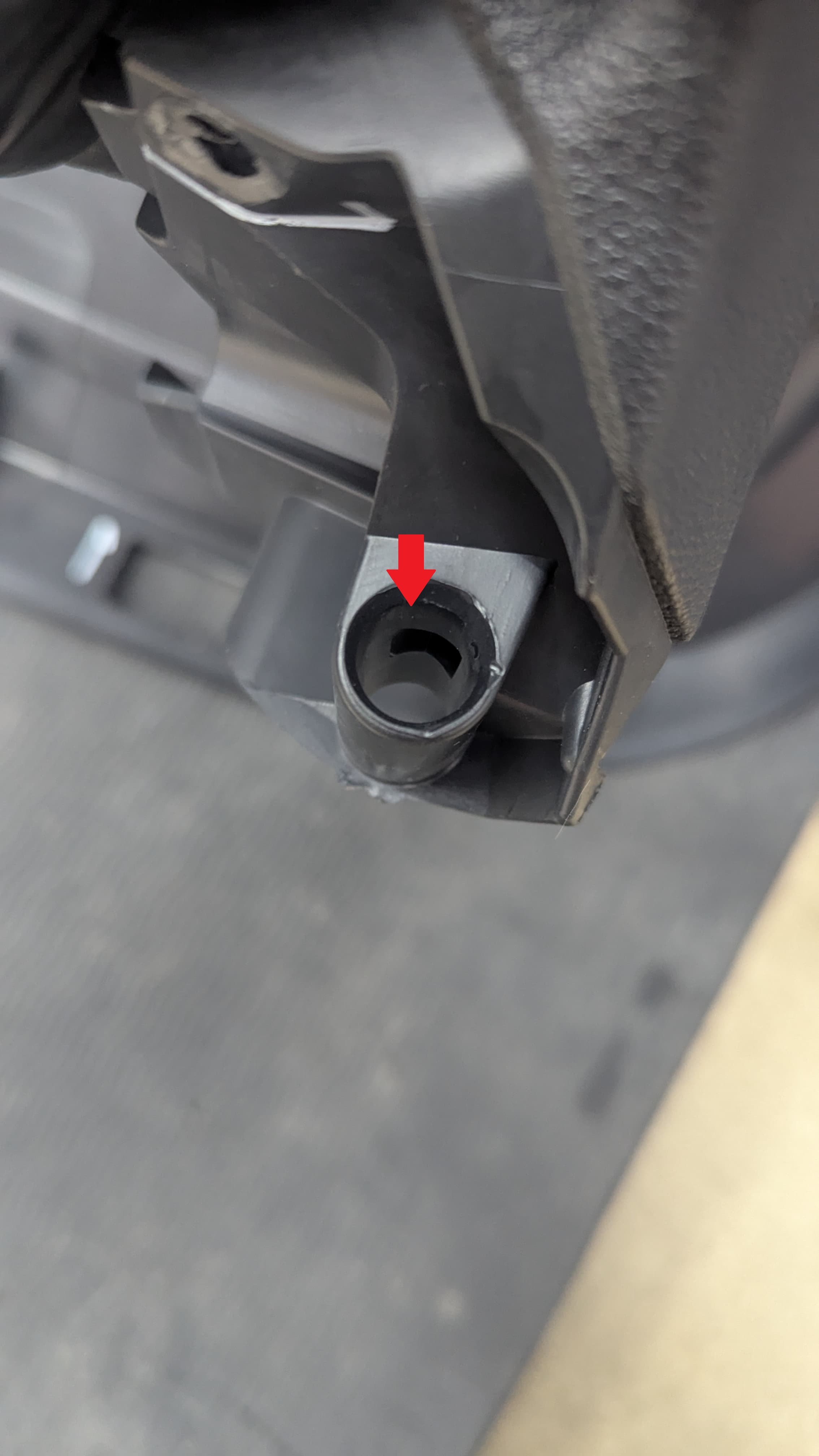

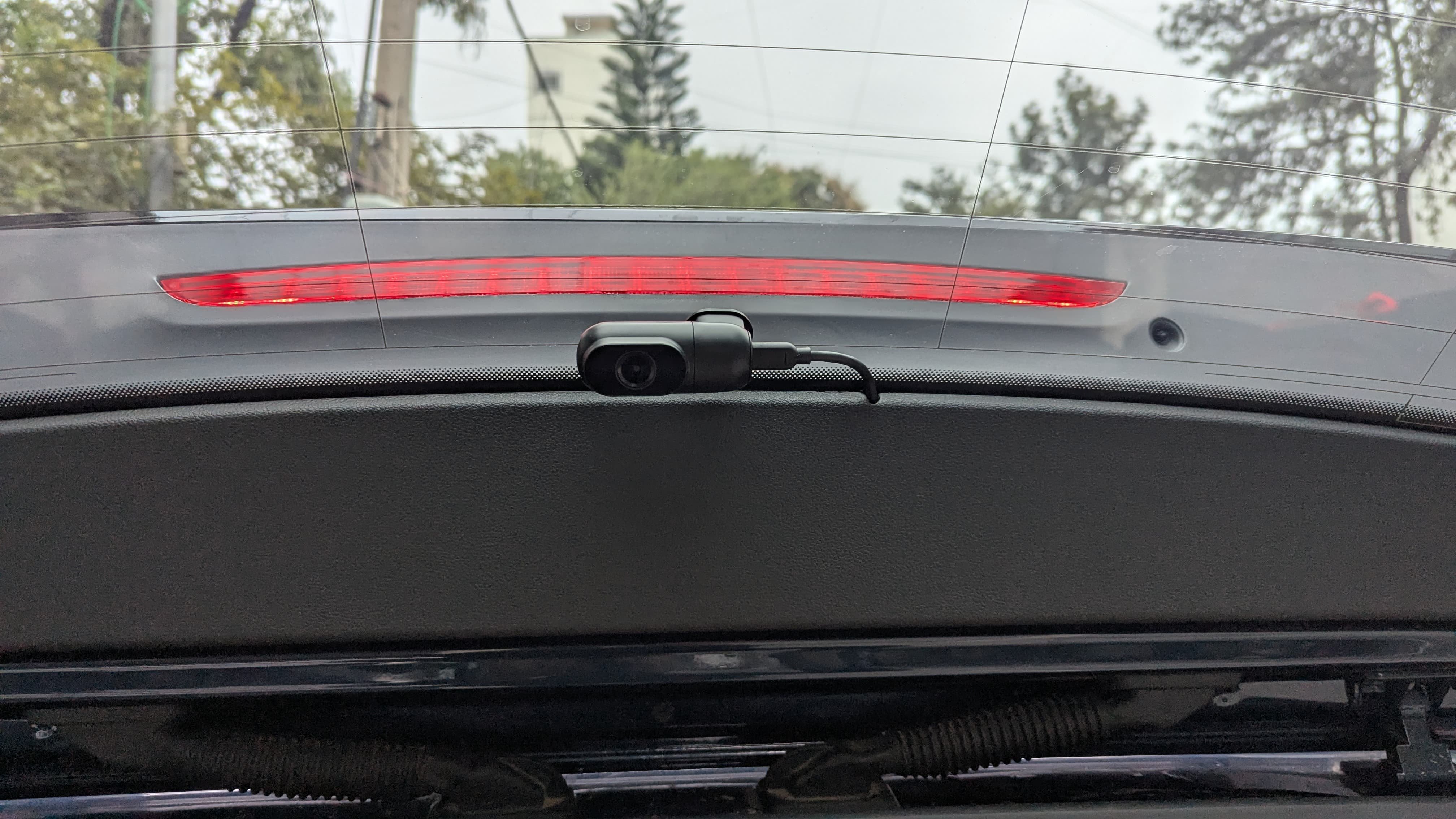

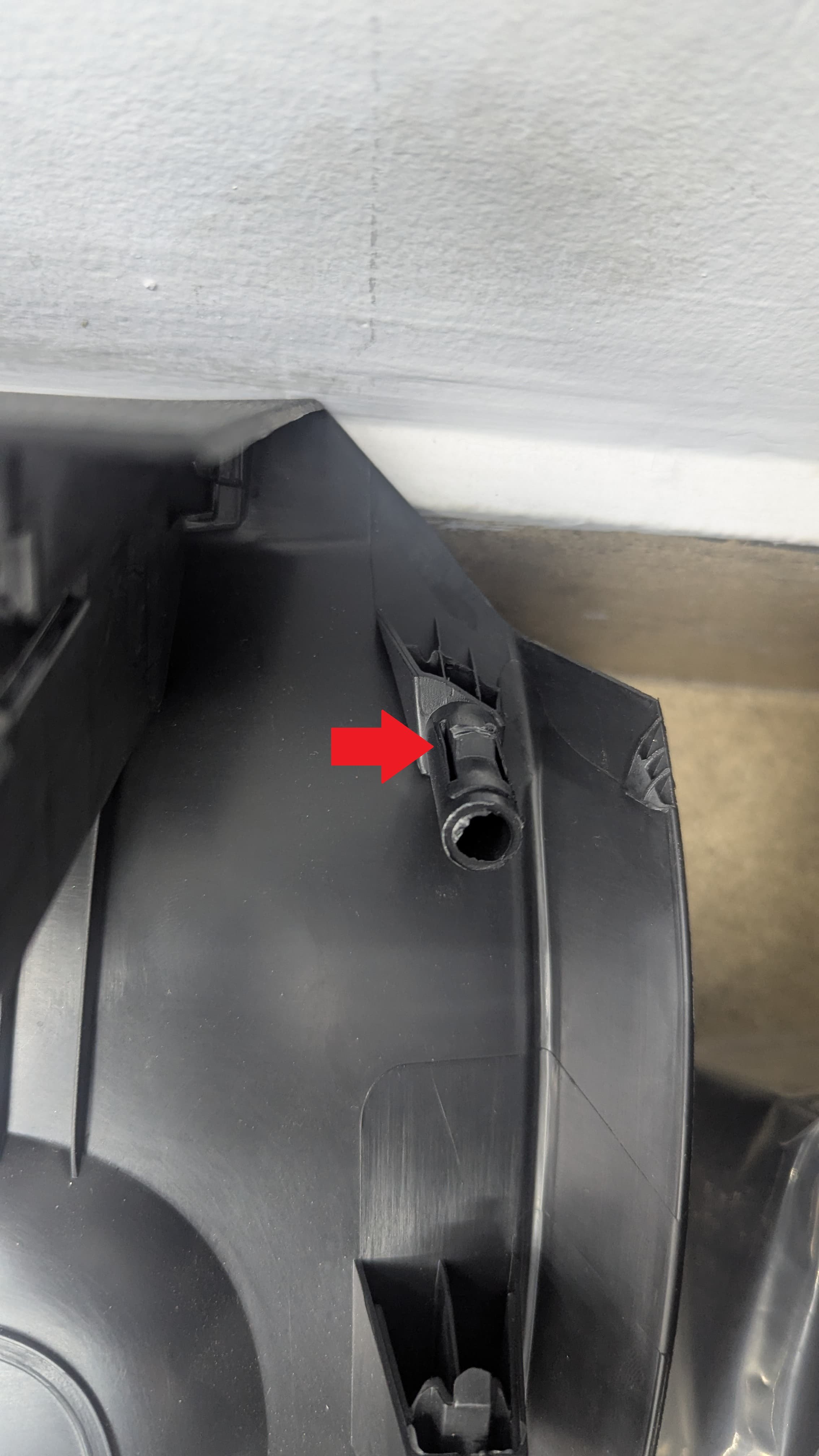

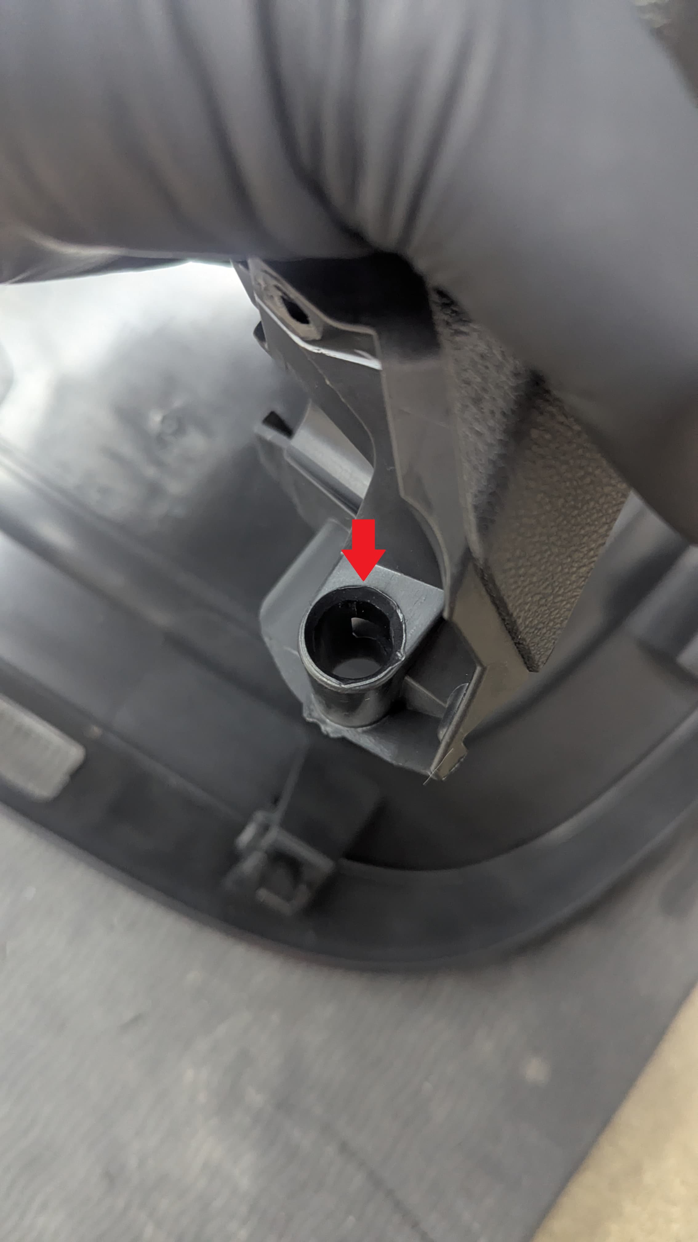

We installed the DashCam (Viofo) in my friend's car yesterday. Thank you for all the advice. It was not an easy task. Removing the rear panel was the most difficult due to the overengineered lock in the bottom of the tailgate. I will share a picture soon. Below are pictures of the installation. We made a small hole at the edge to relieve the wire of stress and then sanded the cut part to prevent shafing of wires.
We had a six meter cable for the rear dashcam which well short when we routed it through the door sil and via the roof liner towards the third row. So, we had to pass it via the roof liner behind the air bags. I believe we did a fairly good job keeping it out of the way in which the airbags deploy,
The third picture is of the fuse that we used. We did not use parking mode. Both the marked fuses are supplied with power in accessory or when the car is powered. This is on the Kodiaqs sold in India, BTW. The power side is at the bottom of the fuse as opposed to the top as noted in this thread in an earlier reply.

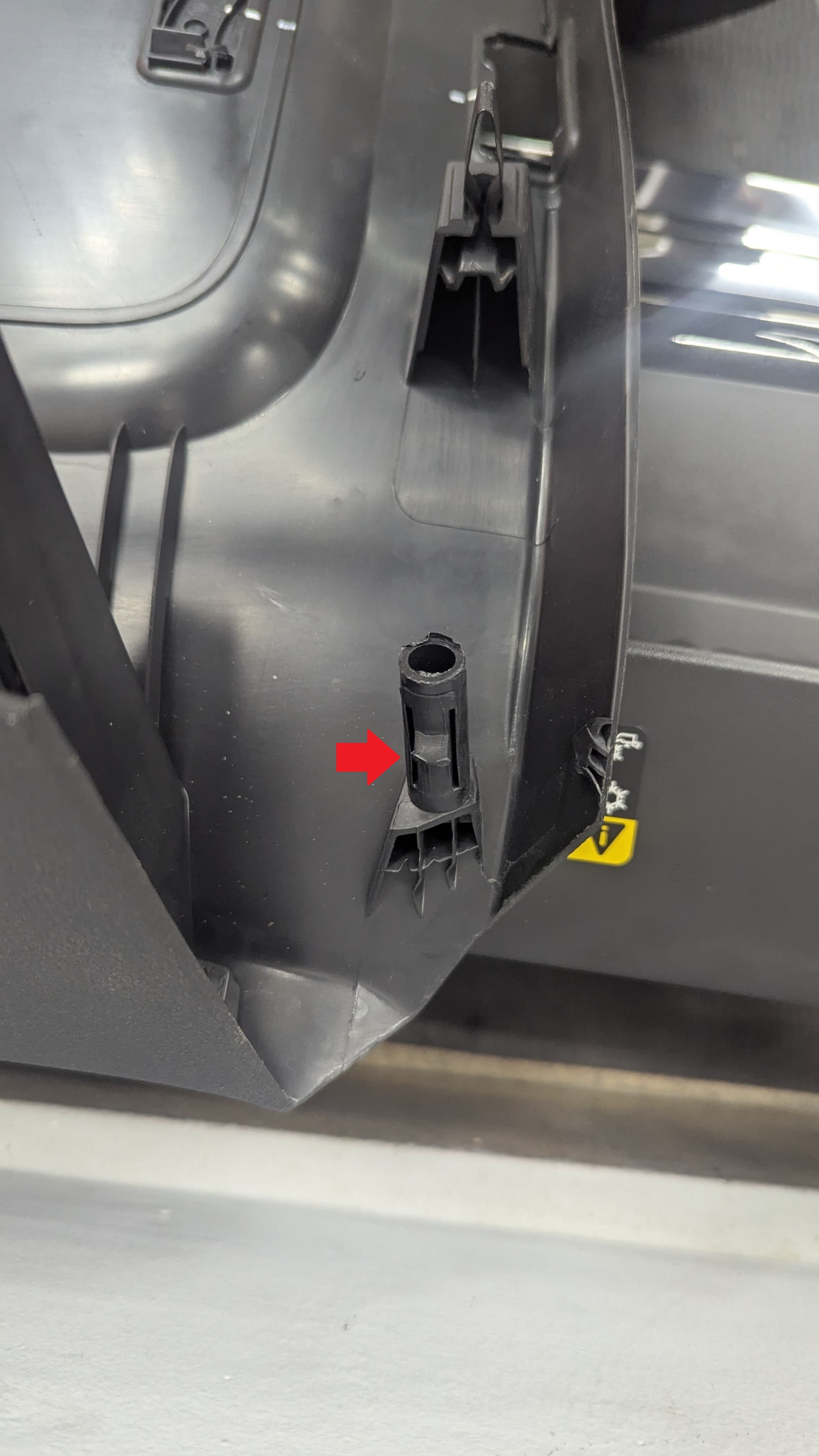

OK, so here we go with the difficult part of removing the tail gate trim. The first two pictures are from the lower part of the tail gate trim. The lock shown is near the top, i.e. near to the glass. On all other sides except both corners, you have clips, but at the corners, you have these "overengineered" locks which are extremely difficult to remove because you cannot see it. You risk breaking it if you apply too much force. Worse, without removing this, you cannot remove the top trim to thread the wires through the grommet.
The bottom two pictures show the space into which the bottom tail gate trim locks into. You will have to remove the clips of the bottom tailgate trim from the sides, somehow peep into the corners and then find and pinch the locks to release them. A small torch might be useful. If you can't, you really need to apply force just enough to wiggle out the lock. Be careful, it may break through or get some damage, which is unavoidable.
Once this bottom trim is removed, the top one can be removed after removing the two torx screws holding it at the sides and then pull out the rest of the trims.
Hope this is helpful.

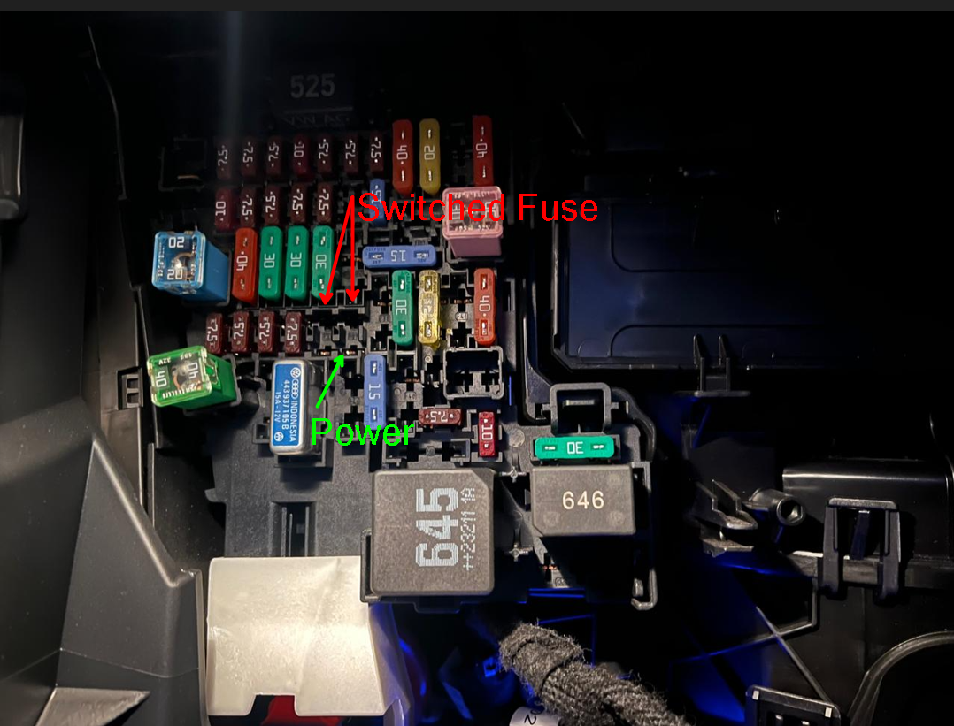

I’m trying to hardwire a VIOFO A229 Pro using the VIOFO HK4 Acc Hardwire Kit.
I’ve already connected the ACC (Fuse 47 – Rear Window Wiper) and the ground, but I’m looking for a constant power fuse to tap into for Parking Mode.
Does anyone have any suggestions for a suitable fuse to use?
Thanks
Check Fuse #40 - the 12V power supply socket fuses. They are hot all the time in my test.
I have checked it, and it appears that the power to fuse 40 shuts off a few minutes after you turn off the ignition...
Does anyone have any suggestions ?
Then I would use a multi tester without ignition turned on (wait a few minutes) and see which fuses are live. In the Kodiaq sold here, the 12V is always live and we found that using multi tester and also the dealership/service confirmed that.
