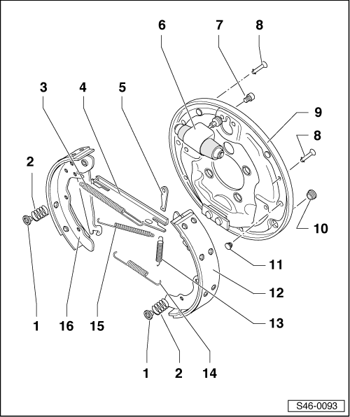

This youtube video shows the drum brake internals (the still below is the rh drum but video shows lh so rh is mirror image of the actual video). The adjustment wedge can be levered up by putting a screwdriver through a bolt hole (which should be approx at 3 o clock position for rh drum). Use a phone torch to shine into the hole and look to see the bottom of the wedge.
The lever that is stuck is the large vertical metal bit on the opposite side to the wedge behind left shoe the bottom of this is connected to the brake cable.
Again a screwdriver put in through a bolt hole at approx 7 to 9 o clock aiming towards the right you can get behind that lever and push to the left  to the release position.
Hope you understand.
If you move the adjuster, it will need to reset by pressing the brake  pedal a couple of times. Do this before driving off anywhere as the pedal will drop low and give you a fright!
