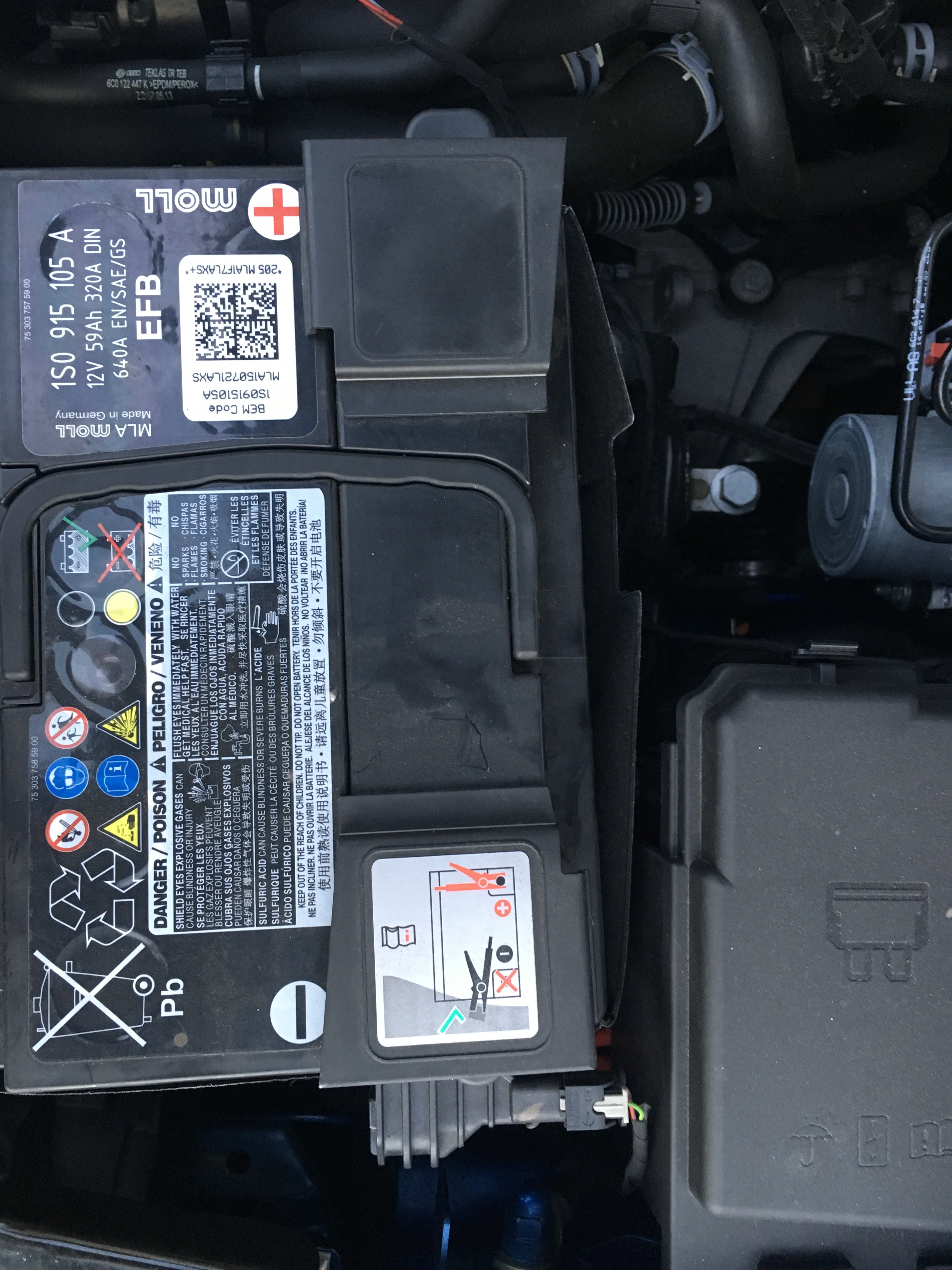

@Windy21 it will not be financially beneficial to buy a battery tester to just check that battery, I was in the unfortunate position of needing to prove  what was causing a battery drain in a car I was looking after so I opted to be independent and buy a CTEC battery tester, otherwise I would just continue through life checking a battery's voltage  under differing conditions to make my mind up as to if it was Okay or Duff.
EFB just means Enhanced Flooded Battery this slight update to a normal lead acid battery ie Flooded Battery was to provide a cheap and cheery upgrade so that cars with auto stop/start function could survive a reasonable length of time before needing to replace the battery, I'm guessing here with the figures, but from slight memory, a normal lead acid battery will last 1500 engine starts and only tolerate a charging voltage of 13.4Volts, these EFB ones will last 15,000 engine starts and tolerate roughly 17Volts charging for short periods. That ties in with what is now required now with smart charging systems and stop/start conditions.  The more expensive AGM version, again just rough questimate figures, will last 45,000 engine starts and a similar charging voltage/treatment.  Modern cars with smart charging don't seem to aim to keep the battery fully charged, they sacrifice that for well "undercharging" and "supercharging" and in normal usage that seems to work for most people, at times stop/start will get inhibited to protect the battery charging.
From your picture you will see at the -VE terminal, there is a ribbed black plastic part with a small connector plugged into - that is the battery management unit that communicates to the charging controller what is happening to the battery - removing that disables stop/start for ever, but I just stick with playing it by ear, if I land at lights and know they will be changing soon, I'll switch the stop/start off.
Edit:- if I were you, and you feel that your dealer is grudgingly replacing that battery, I'd be noting the capacity and CCA rating of that battery and not accepting any lower numbers appearing on the replacement one!
Another, yawn, Edit:- also make sure that they fit these covers onto the replacement battery, a well as plugging the battery management lead back in, my wife's Polo came back from its second service and it took me a couple of days to work out that the stop/start was not enabled and it was summer weather, so I had a quick look and found that the battery management signal lead had been left unplugged, so plugged it back in and stop/start started enabled again.
