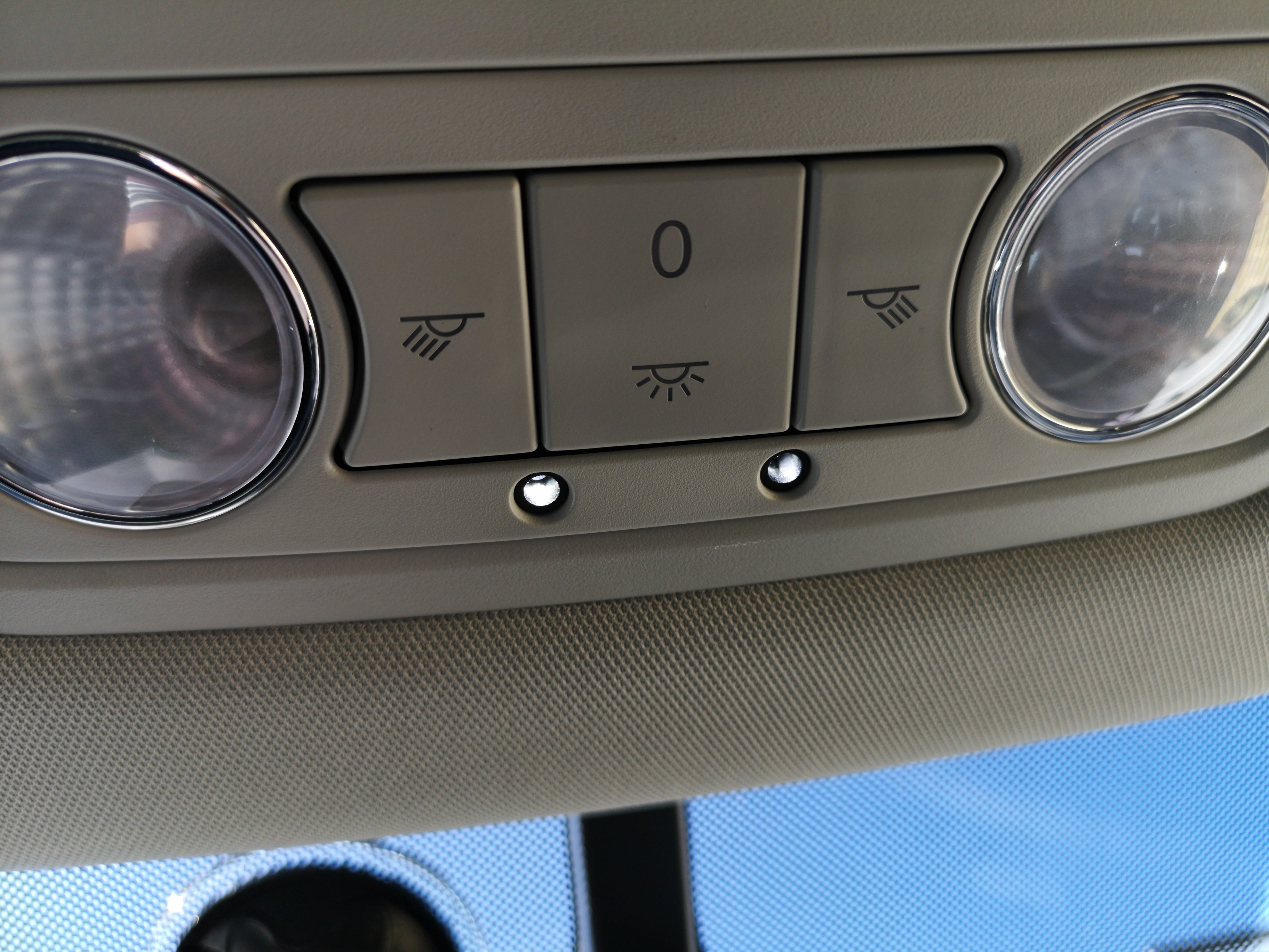

Also, someone on here tipped me off that if you look up there are two small LEDs that come on within the interior light cluster when the headlights are on. They are a quick and easy way to check I wouldn't have spotted without help
I think that may have been me @Cd1yat
Thanks @don_kiddik, will have a look next time it's dark for that, our Lexus(s) always showed on the instrument panel when headlights were switched on and like others I find the knob down the side in totally the wrong place especially as in the early days I kept knocking it with my knee when getting in and out of the vehicle and then changing the settings

Can you put a picture of the two interior LEDs that come on with the headlights as I can't find them and I'm curious where they are?  To be fair I haven't actually driven in the dark yet!
Here you are @Marchincus
They Do not exist in the EU Style version with the Sun roof.

Thanks @don_kiddik that explains it as it is a different interior light setup on the edition.
