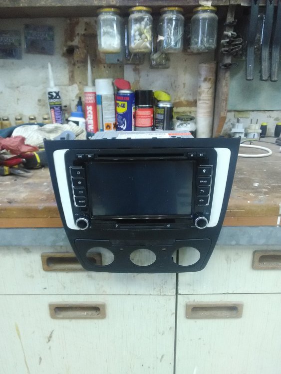

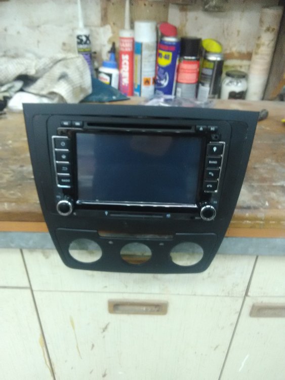

In case anyone is still reading this thread, I've just fitted one of the Vanku Android 10 units in my VRS after a brief experiment with one of the REALLY cheap far East specials (sound was abysmal so binned that straight off).
First impressions are good - sound is probably actually better than the original HU, having Maps etc available for nav is so much better than using a vent phone holder, and being able to take calls from it is super handy.
Lessons learned:

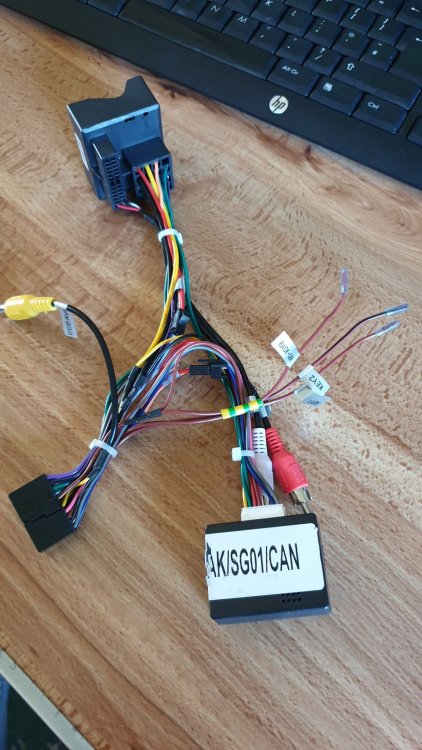

I got lucky that my canbus is a later revision that doesn't drain the battery, but wasn't even aware that was a thing until after I'd fitted it. Would have been smart to check that first really.
You need a whole bunch more stuff than just the head unit - I got a Connects2 canbus quadlock - ISO adapter so wouldn't have to mess about with wiring into ignition switched fuses, and needed a double din cage and fascia adapter and it's still not quite right. Need to do some extra sanding, I think.
Oddly, fitting this actually brought my insurance down a bit when I declared it - no idea why, but there we are.
Hope that helps anyone still looking at this thread!

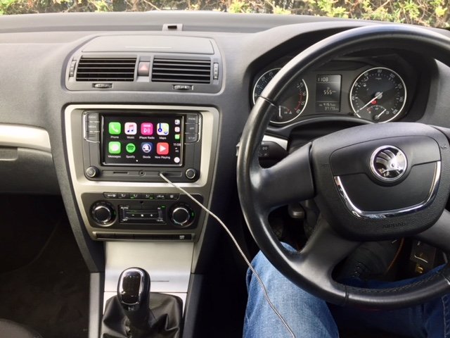

It was only till recently that I found out that you can buy a new centre console section designed to fit the shape of the vw family of head units. The Rcd series. Now if I'm not mistaken they run the same vag group software. Being vw there are plenty around at decent prices and they will do everything you want.
They are are 225.00 I bought one for a vw we have and it is fine no battery drain.
Hope this helps..?
Ps being a vw fitment across a broad range of vw vehicles its resale will be much better too. Oh and you just go in and change the vw for skoda start up....
