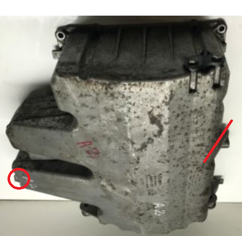

@VWD hauling this back on topic, I've just been looking at images of the AMF sump on ebay (this current listing has some nice photos), and there are some unusual features that may explain your lack of success. What angle was the car at when you extracted the oil?
It looks to me like you'd want it quite steeply nose-down to get the most out via suction tube, as the sump has some projections out the back which look like they'd harbour a fair amount of oil, and it looks like the dipstick tube 'socket' at the front will guide whatever is poked down it to one of the shallowest areas of the sump. I'm not sure what angle the engine sits at in the bay, but it looks like the various slopes of the bottom of the sump may make it quite a tricky one to correctly place the extractor tube at the deepest point.
It looks like the first point it hits will be quite a shallow area, then depending how the tube bends, and how far it gets pushed, it might go to the deepest part, and then possibly past and up the other slope towards the sump plug?
Presumably the engine does tilt backwards a fair bit in the bay, otherwise you'd struggle to get all the oil out via the sump plug with the car level on a lift?
This  image shamelessly borrowed from the above listing, has a red line that I've added showing the path that the dipstick tube will guide the extraction tube in on, and a red circle showing the sump plug. The slopes are quite nicely illustrated.
Wino - thanks- explains a lot. The tube included was 6.14mm external. and 1m long, but at .5m felt like it was catching on something. I could push it deeper into the sump, but this gave no appreciable amount of oil. I'd sat the car so that the front of the sump was angled lower than the rest, but even then all I got out was 2.5 litre.( I'd previously  marked out an old 5l screen wash container ).
