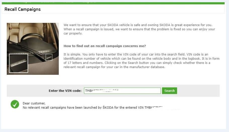

I am going to call Sparshatts again and quiz them about any possible recalls, just to cover this and get it on record.
The person I spoke to was fully aware of that recall as soon as I mentioned 34H5 so hopefully it would have been done if required.
His words were "only a very small number of cars required this".
Got through to the same chap and he checked (Skoda system working this morning) and apparently no recalls required for my car none ever issued. No recalls have been performed as a result.
At least that is something that the recall wasn't missed!
