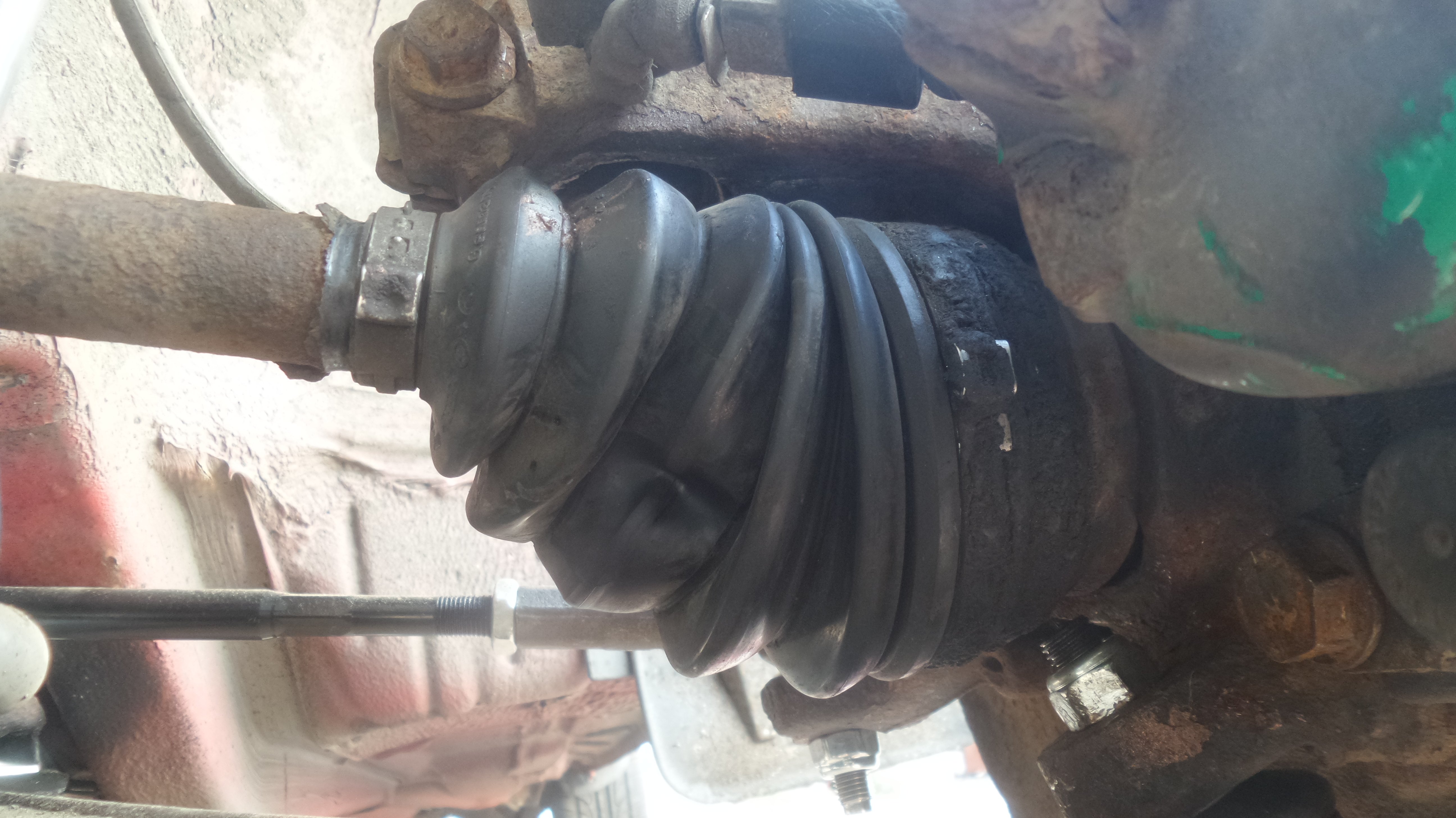

@Andy B my money is on a driveshaft or CV and from how you described it being caused it makes sense
Looks very much like mine is my O/S outer CV joint.
It doesn't click constantly only when the gear is selected and its almost as if slack is being taken up rather than just being tight
I know your noise is different but them bearings can go in all manner of crazy angles, check the photo below of when my N/S outer fell apart, bit of extreme example as the wheel wouldn't even turn but the noise was terrible
Check the driveshaft and hub splines for wear/slippage.

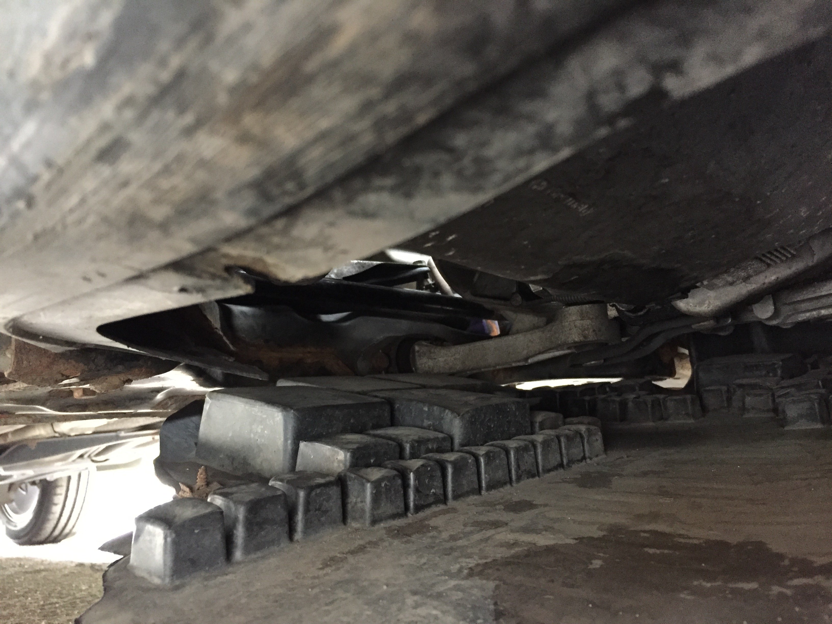

One of the usual suspects if there is excessive movement is the dog bone mount that sits between the gearbox and the crossmember.
Hope this helps. Dave
The dog bone looks ok to me (and there’s a pic on this thread) but I’ll have to look into it further when I have help and tools. I’ll need to check the clutch engine interaction at that time as well.
