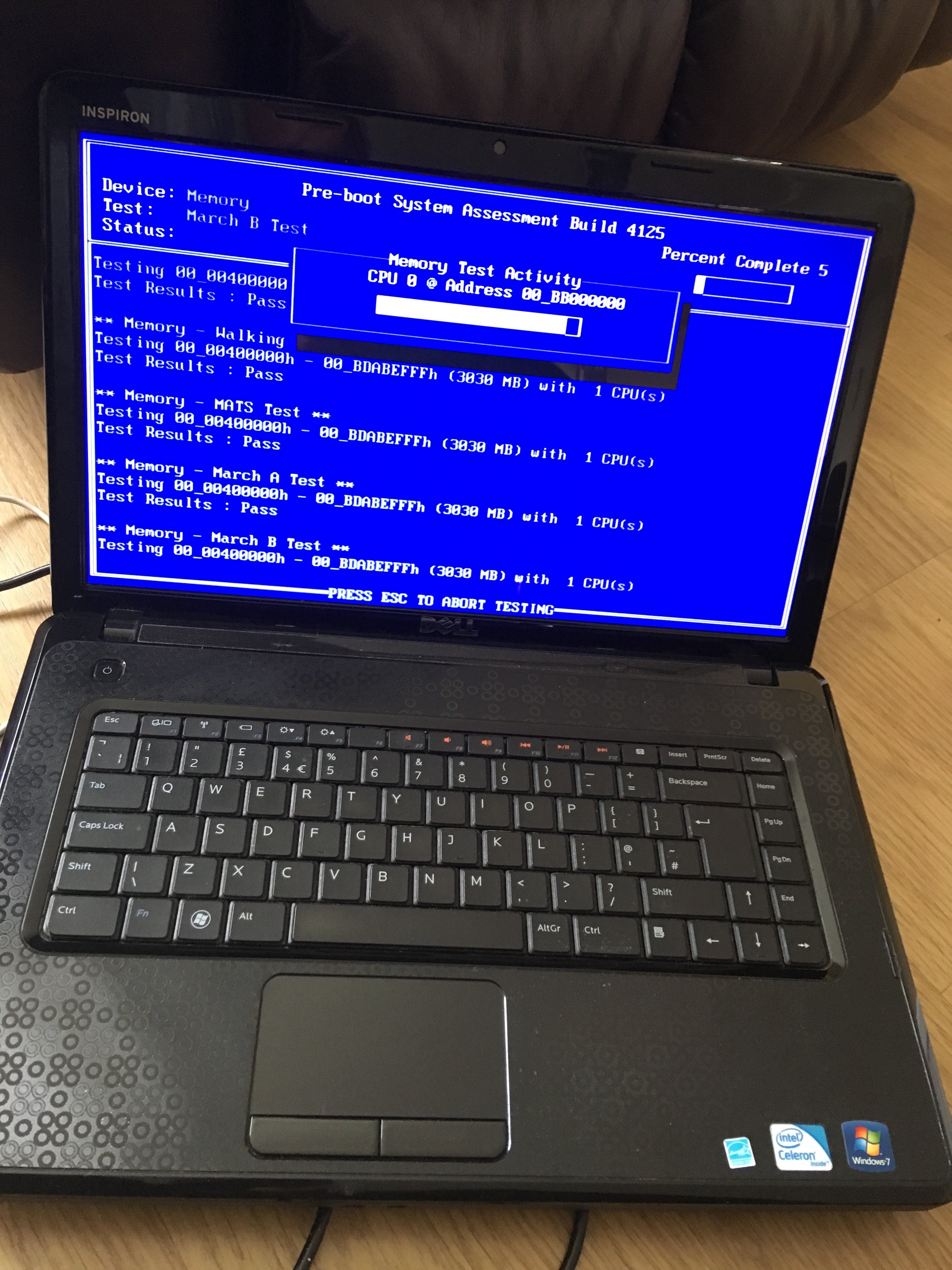

Rather than just bin it, I thought I'd fire it up out of curiosity.  After some loud beeps, it's now running a Pre-boot System Assessment.

All I get to is 'No bootable devices--strike F1 to retry boot, F2 for setup utility Press F5 to run onboard diagnostics.' F1 just repeats the same message, F2 does get me to some options, none of which appear to make a blind bit of difference, F5 already done and it said everything was fine.

dead easy to change the HD, however Dell have built in diags so turn on and immediately keep tapping the F12 key after a bit it will boot up and you can use the cursor keys to select diagnostics let it do its tests and see what it finds
John
John
Thanks John, that's doing just the same as F5, but I'll leave it running again.  If it's running all these tests, I presume that must mean it's accessing its hard drive?

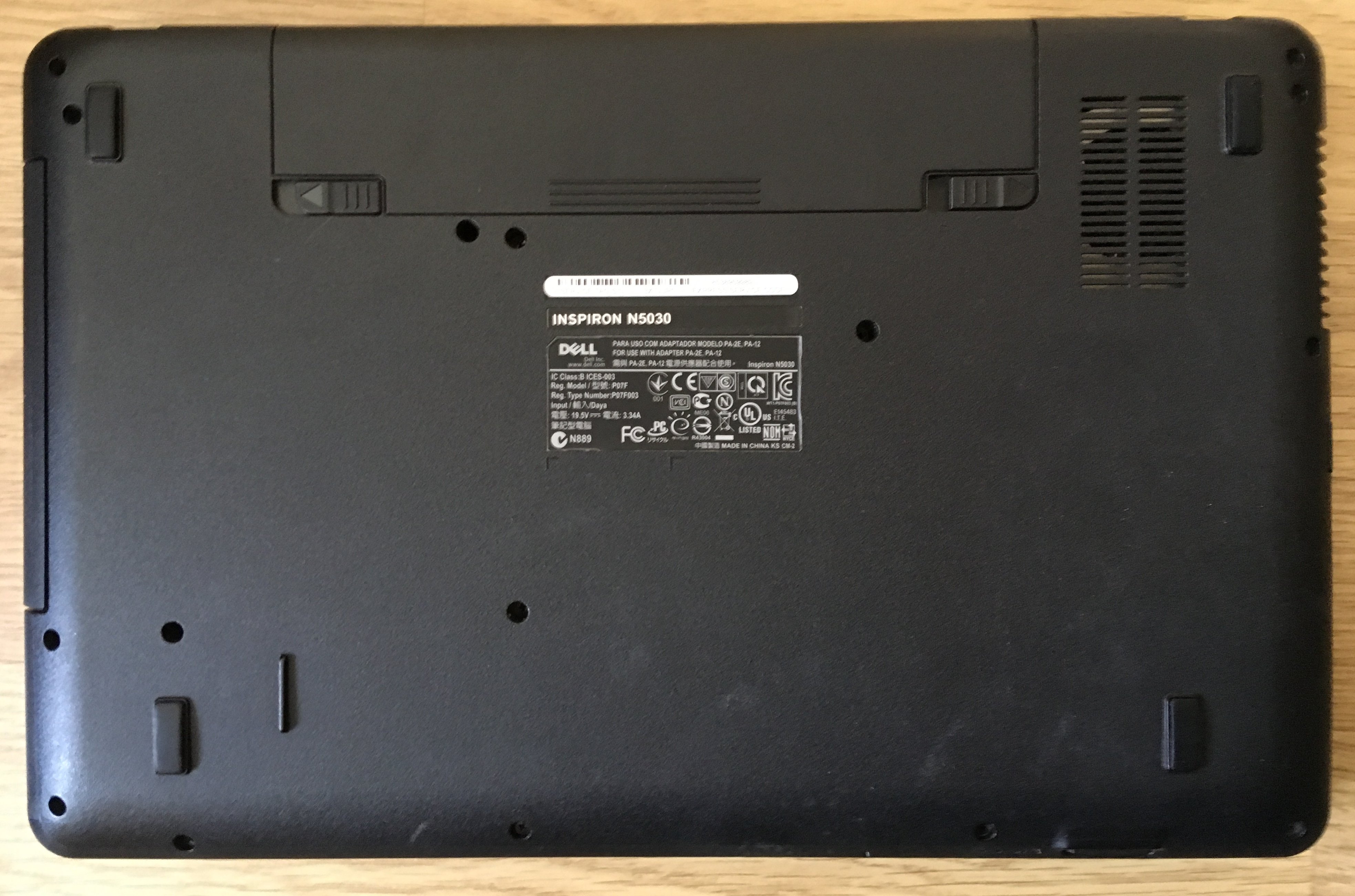

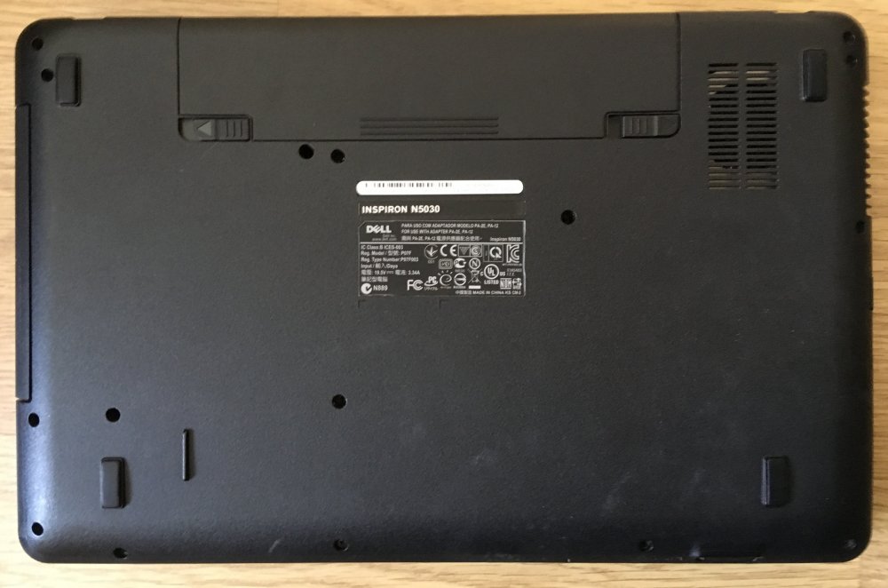

No little flap, lots of screws and perhaps more importantly, no OEM Windows sticker - why on earth would a teenage girl leave something useful like that on it :thinking:
Think I'll go have a look at Youtube and see how adventurous I'm feeling.
Gaz

This notebook isn't as easy as a HP or some other Dells unfortunately (which have the harddisk in a seperate compartment, or a cover which you can easily slide of). you have to remove all screws and lift the top cover (with keyboard) up to get access to the inside..
See youtube:
Its not a hard job, as long as you're carefull and pay good attention to all screws (and remember where they came from)
Looks like a full strip-down to get to the HD on that model

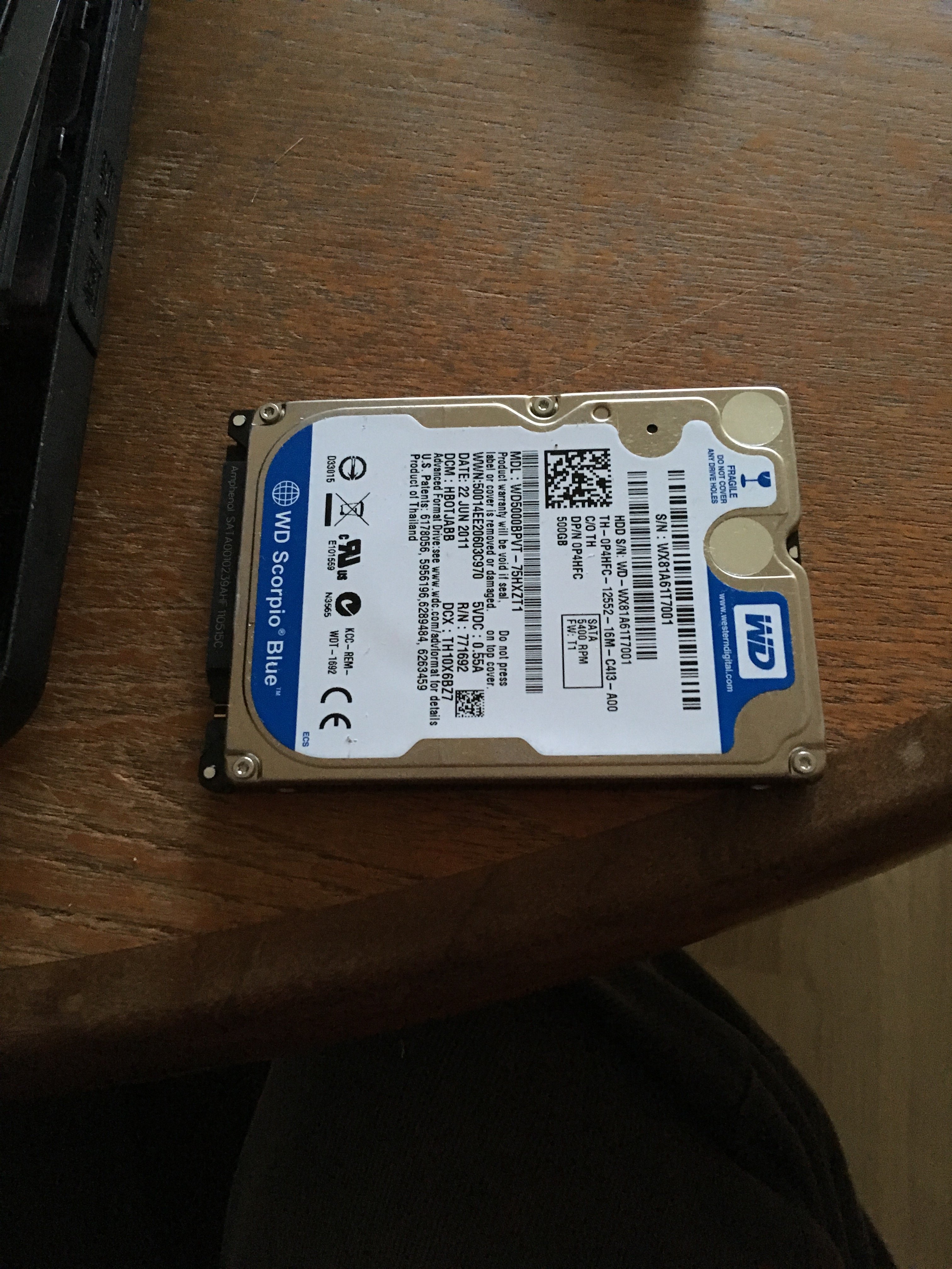

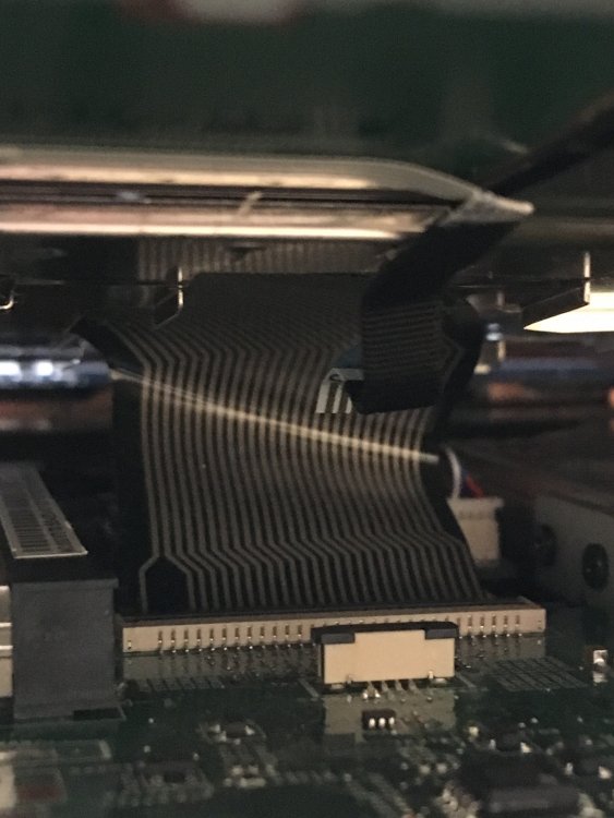

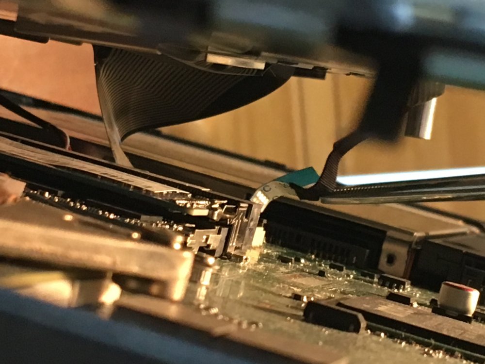

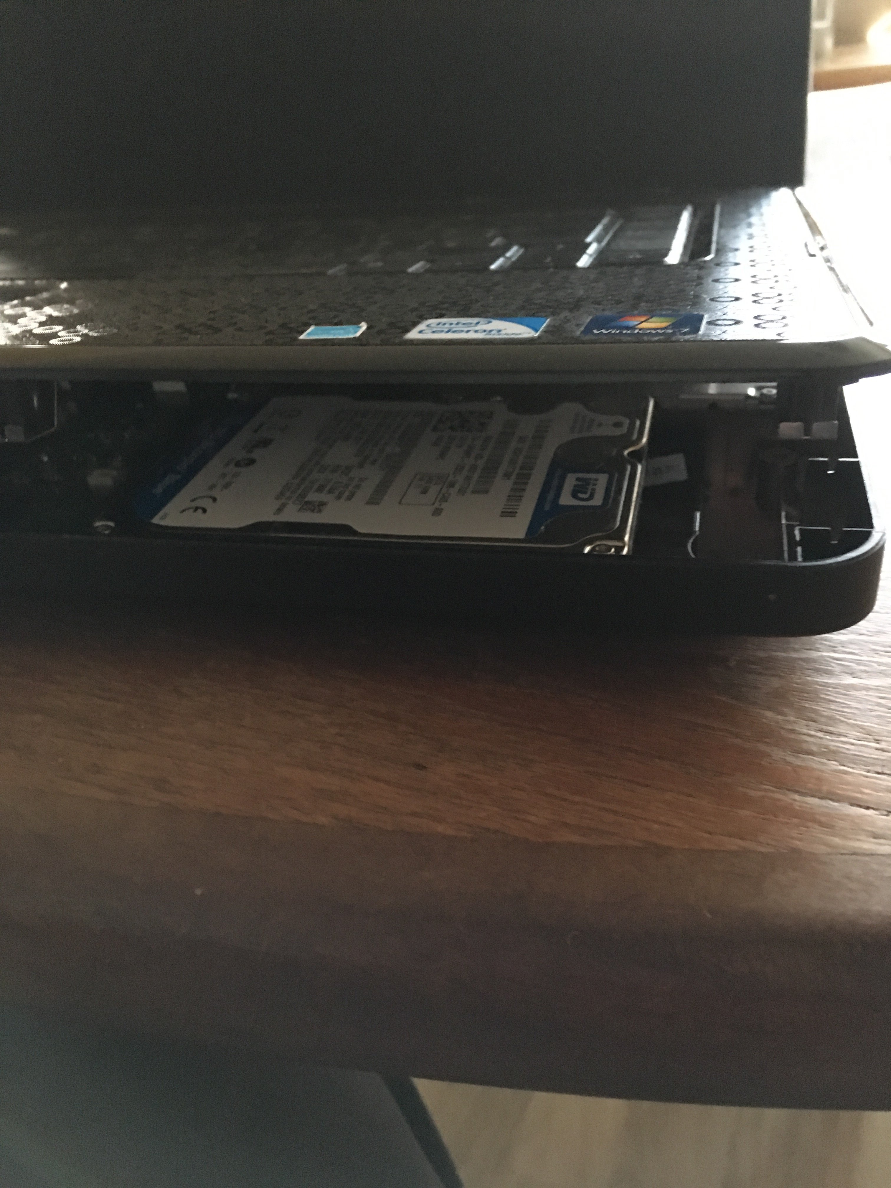

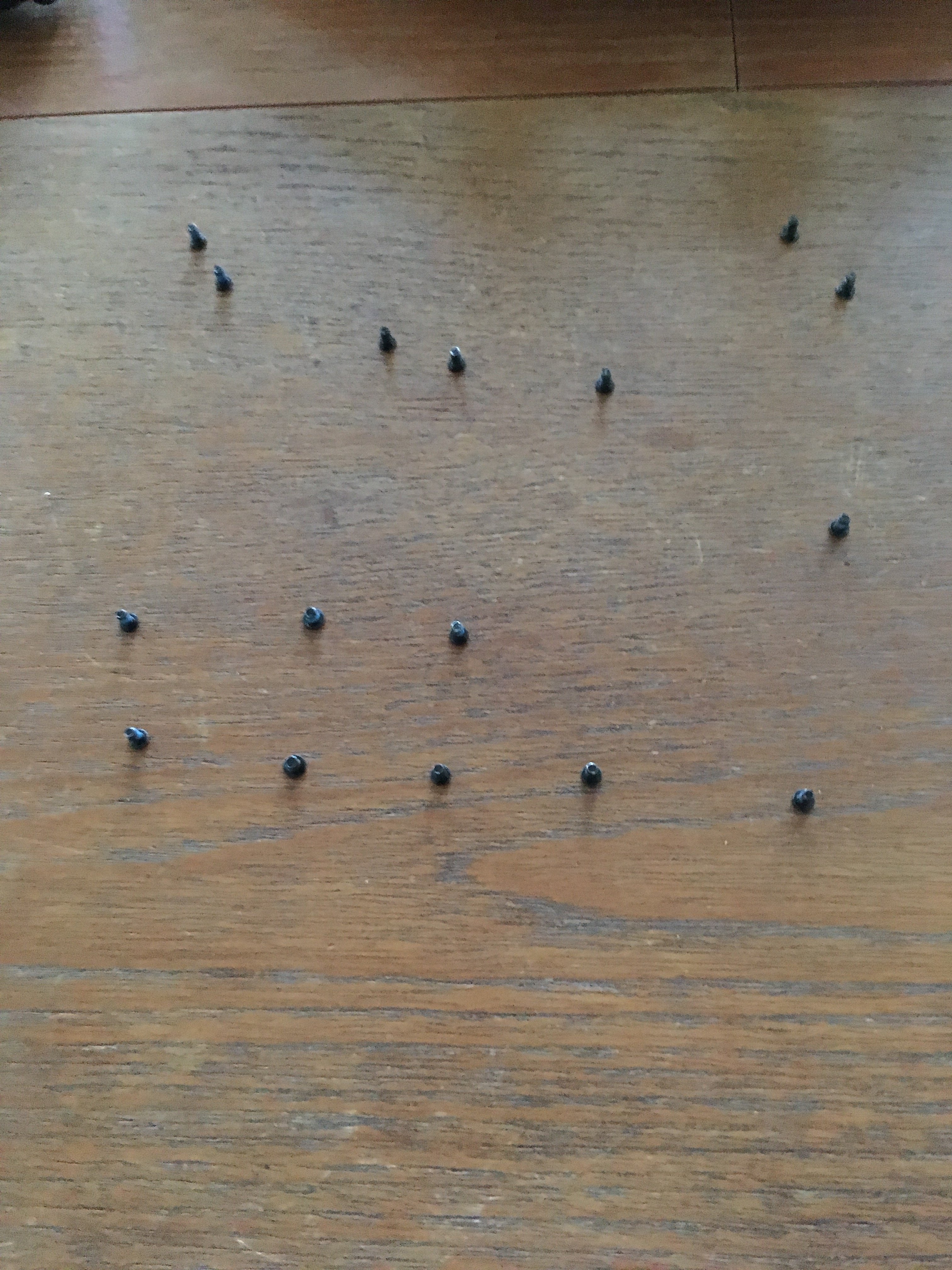

In for a penny (all screws present & correct):
Peek a boo.....
Out ya come.....
I was with Aspman until i saw which one it was.. stupid Dell changing the really easy access port!
I really wouldnt be surprised it just got a knock and dislodged the hdd.
Can get 2 1/2 external cradle to then make it a usb drive on another computer to check if it works once out, assuming the full seating check fails. If it doesnt work as an external its dead. If it does, then the laptop mount may be faulty.
I recommend get a sheet of paper, draw the layout of the underside on it and mark screw positions. Remove a screw and put it on your paper layout. Easy way of tracking them. Same on inside. Dell have a habit of using 17 different size screws when they could all easily be the same..
I was clearly typing while you were pulling it out :D

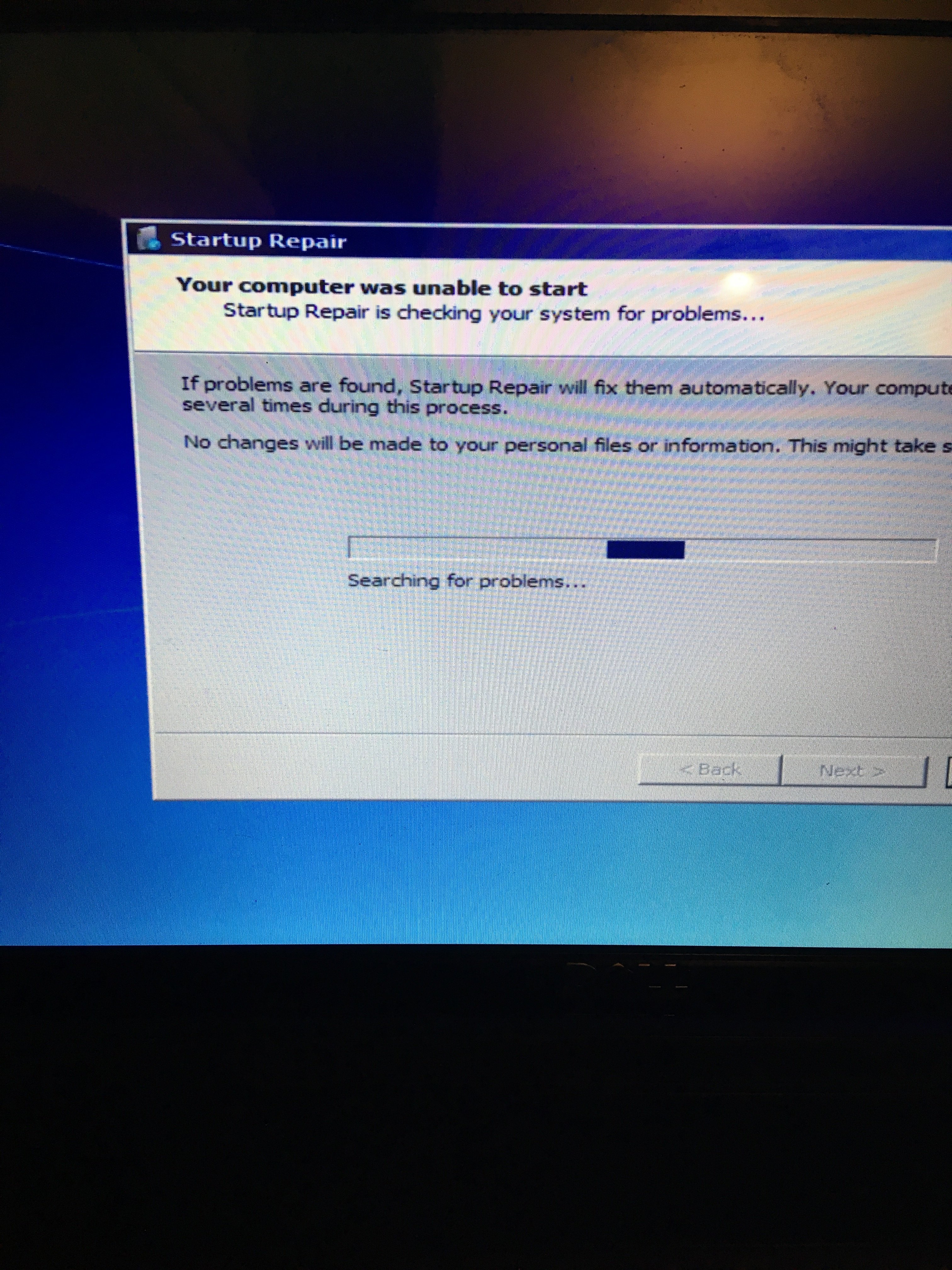

Well I gave that a go, and now we're currently here.....
Well I never - fingers, toes and other things crossed B)
