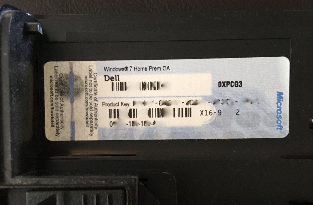

Whoa, whoa, hold the front page.  There's a label underneath the battery - is this what I'm looking for?.....
(numbers obscured coz it seemed sensible to)
Gaz
Edited by V6TDI
Yes, that's a "Windows 7 Home Premium" license key.
If you use the "Dell" installation disk then you don't need a license key as it recognises the laptop as a Dell device and activates automatically.
If you use standard Windows 7 Home Premium installation disk then that key should activate it.
What it doesn't tell you is if it's a 32-bit or 64-bit version of Windows 7, as these are often on different disks. I'd guess at 64-bit, given the age of the laptop,but Icould be wrong.
In theory that key should also activate Windows 10 Home. I have managed to use a Windows 7 key to do a clean installation of Windows 10 on a laptop, so it should be possible, although Microsoft don't really comment on that.
