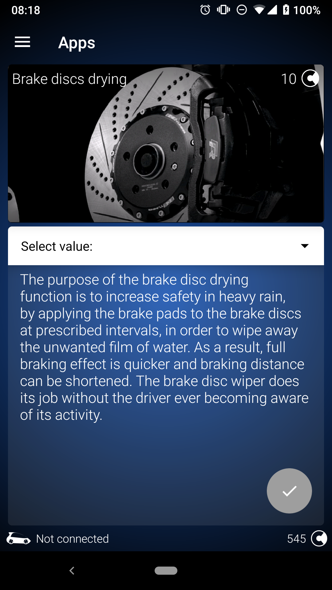

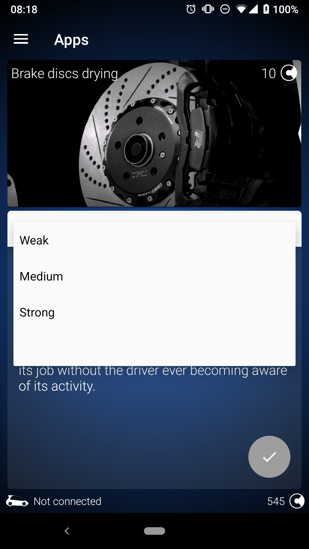

Some manufacturers actually now have brake drying tech on their cars but unsure how its triggered.
This can be enabled via VCDS and OBDEleven but I completely stayed away from it as I thought it would result in the pads wearing quicker.
I doubt that brake disc wiper will cause any additional significant wear, driving style will make a much bigger difference. Plus pads aren't exactly expensive and that initial braking bite could easily help avoid a serious accident.
For example, I enabled it about 85k ago on my MK2 and haven't had any obvious issues with accelerated brake pad wear. The pads have done at least 100k (my ownership) and are likely original giving 150k so far :)
Good to know - even more so that the pads have lasted that long :D
