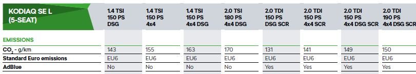

I would rather have a TDI with SCR sitting ticking over in front of me and around me in gridlock traffic rather than a 1.4 TSI / TFSI be it warmed up or coolant at 90*oC and oil not yet at that.
At least the new engines coming will have a GPF. but still likely have the Emissions Controls inhibited at low ambient temperatures like Winter Commutes in the UK.

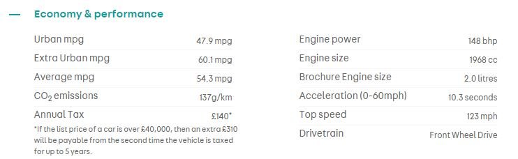

All those vehicles that got lower EU Test figures with low Co2 g/km and lower VED because they had Stop / Start which is more often inhibited / disabled in low temperatures and yet when even in for a UK MOT they are tested with at 'Operating Temperature' engines.

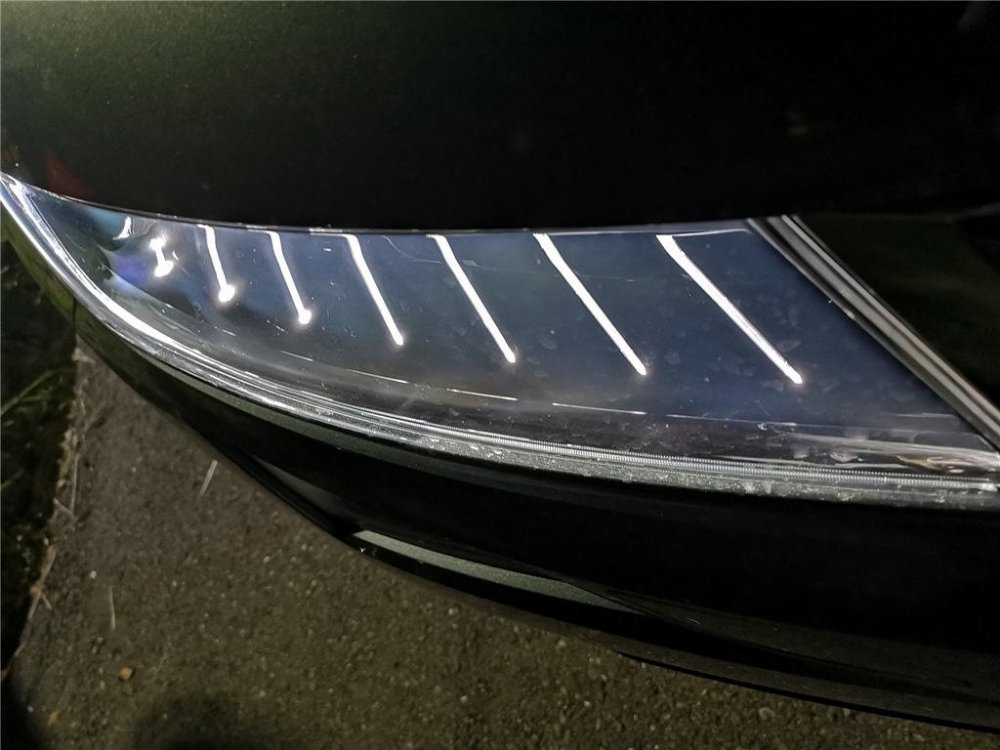

My Kodiaq has LED headlights with a relatively low power draw, but those with halogen headlights will dim whilst the engine starts.

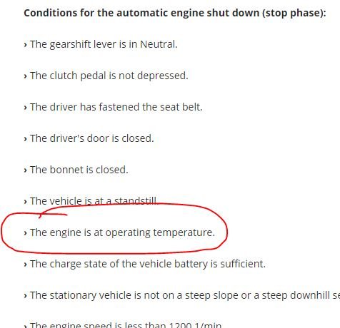

One of the prerequisites for the operation of the stop phase was that the engine is up to operating temperature...
I can confirm that on my previous 2016 Octavia (TDI 150PS non-SCR) and current (2018) Kodiaq, that this is now not the case.
As with everything, technology progresses I guess.
I was on the understanding that Skoda always recommended setting off from a cold start straight away, rather than letting the car idle (i.e. when defrosting etc.), in an effort to minimise engine wear. This is down to the fact that driving the car got the engine up to temperature quicker than if it was stationary / ticking over. I think it is widely acknowledged that the greatest amount of engine wear occurs during the early stages of a cold start.
It might be considered that having the stop start operate prior to the engine reaching operating temperature could exacerbate engine wear by delaying the engine warm up process.
Of course there are other elements affecting the stop start. If it is cold enough for the additional engine wear then it is also likely the driver will be calling for heat via the Climatronic system, which would prevent the stop start from activating until the engine is able to produce enough heat to satisfy demand, thus minimises engine wear.
It's all pretty complicated, and the obvious preference would be to simply let the car do its thing.
