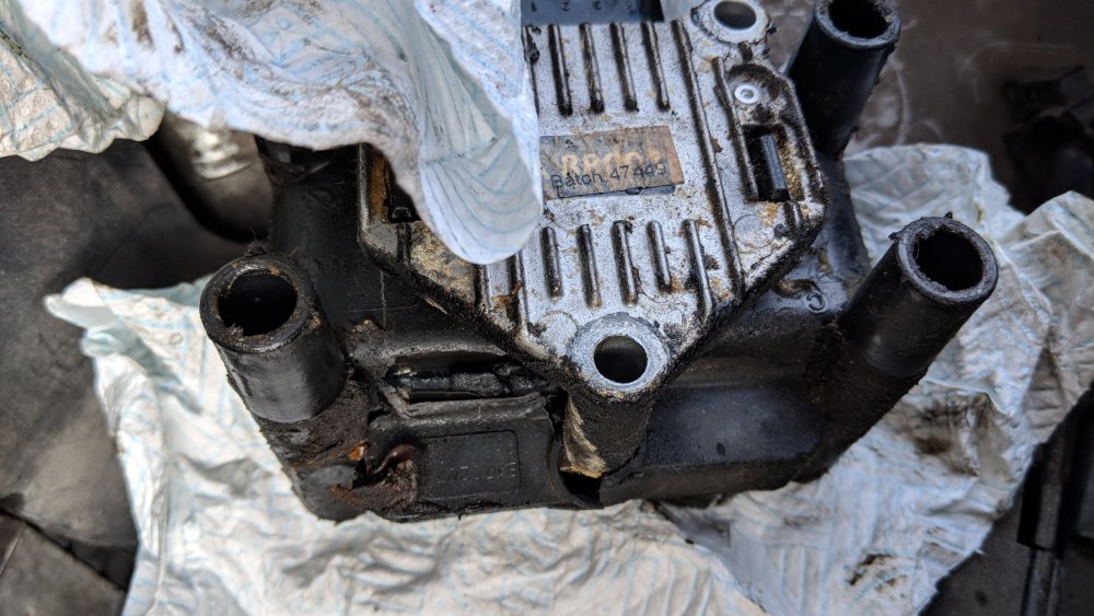

  • and now a coil pack as the car dropped onto two cylinders today (fortunately not far from base) - spot the problem(er large hole) - picture attached! Don’t think I've seen a coilpack like this before. Hopefully it hasn't spiked the CPU or the CAT. Wasn't driven far when it happened.

Coil pack from ebay restored full health - easypeasy fix. I was worried with the way the coil pack had "exploded"  other damage had been done. Hopefully CAT is OK as it was only driven short distance on two cylinders with the other two chucking fuel down the exhaust.
