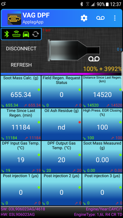

Hello. I posted this in the Yeti forum by accident. Mkii Octavia 1.6cr. Ran the Vag DPF app and these are the results ...?!?! Something is clearly rather wrong here. Is it that the DPF has been removed? I bought the car @14500km ago ... last year ...
This car has been nothing but trouble really. Can anyone confirm that this looks like the DPF is missing? If not what is going on? I did this because the MOT is coming up in mid october so I wanted to see where I was at beforehand. I can't see that I can sell if without a DPF, unless I was completely unscrupulous (as the dealer who sold it to me may or may not have been)

As far as I can tell it isn't possible for it to have gone 14,000 kms and have 0.00 soot, not unless it's some kind of immaculate combustion miracle. The big worry is that I just paid £700 to have a new injector fitted, the last thing I need is this on top of that!
looks like missing DPF to me..
should use real VCDS diagnostic to see status..

try to run engine and in idle acceleator pedal to bottom, to max and see egr percentage.  (high pressure egr closing )if it stays on 100% it is closed too.. (disabled)

The App is maybe the issue.

I do put Miller's ecomax in, mainly because I've still got a bottle full from when I was having injector issues! The thing is that it doesn't seem to be doing regens, or at least not that I've ever noticed. Most of my journeys are 70 odd miles so I assumed that it would be taking care of itself. But then the general worry regarding the new MOT regs meant that I thought I'd investigate. The app says it hasn't done one since - in distance  terms - I bought it.

I also have a 1.6 TDI with CAYC engine. Mine regenerates around every 700km.
During regeneration the idle rpm is not 800 as usual but 1000 and the oil temperature can rise above 100°C. Try to check out these regularry to catch a regeneration event if it occures.
It's often, mostly even, idling at 1000 ... but other than that I can't say I've ever caught it doing a regeneration
Well, the constant 1000 rpm for idle is strange. I'm not a map expert, but it is suspicious to me.

Just by way of a follow-up, whatever has or hasn't happened to my car it just passed its MOT with only a couple of minor advisories (pads and rear tyres). I'm still convinced that the DPF has been removed, as well as the App showing no regens and me never noticing any the exhaust is also quite noisy once it's warmed up. Whatever, it's passed and I'm happy. Probably keep it for a while now. I like it.
It passes in all countries, only if when they will trying to read obd2 settings. But they are not able to do that yet.. just basic things..
If you get any smoke when you boot it hard it’s most likely that the DPF has been removed. Since it has passed an MOT don’t worry about it. I would be tempted to use the same MOT garage next year.
