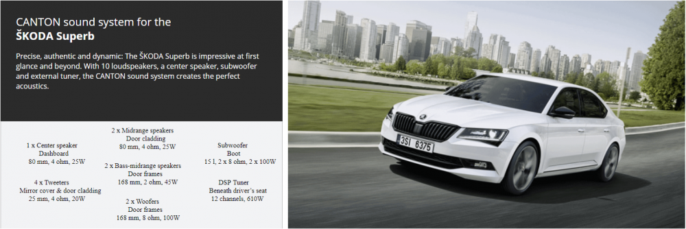

it also worth noting, with regards to the Canton Speaker system, the following differences across the Skoda models:-
Model Centre Speaker Mid Range Speaker Bass-Mid Range Speaker Subwoofer Tweeters Woofers Amplifier
Octavia 1x 25W, 4 ohm, 90mm - 2x 100W, 8 ohm, 168 mm 2x 100W, 4 ohm, 168 mm 4x 20W, 4 ohm, 25 mm 2x 45W, 2 ohm, 168 mm 570W, 10 channels
Superb 1x 25W, 4 ohm, 80mm 2x 25W, 4 ohm, 80 mm 2x 45W, 2 ohm, 168 mm 2x 100W, 8 ohm, 151 mm 4x 20W, 4 ohm, 25 mm 2x 45W, 2 ohm, 168 mm 610W, 12 channels
Karoq 1x 25W, 4 ohm, 80mm - 2x 80W, 8 ohm, 168 mm 2x 100W, 8 ohm, 151 mm 4x 20W, 4 ohm, 25 mm - 570W, 10 channels
Kodiaq 1x 25W, 4 ohm, 80mm - 2x 100W, 8 ohm, 168 mm 2x 100W, 8 ohm, 151 mm 4x 20W, 4 ohm, 25 mm 2x 45W, 2 ohm, 168 mm 570W, 10 channels
According to https://www.canton.de/en/skoda-en Superb Woofers in front doors are 2x 100W:

I mean the one in the trunk (boot). What does it mean that it is 2x8 ohm, 2 x 100W ? I thought there is one bass speaker in the trunk...
it uses dual channel voice coils - hence the 2x 8 ohm.
