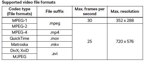

looking at the manual looks like as say a codec issue and maybe bitrate or framerate too high  - file size was 720x576, total 2060kbps, 30fps so proably latter too elements over spec.  will try see if able to convert again and try when get a chance.
All my video files are 720 x 576 25fps .mkv videos. The Columbus can see and play them on a NTFS/exFAT and FAT32 formatted pen-drives or SDXC cards (128GB) but can't see them on my Samsung Galaxy S8.
