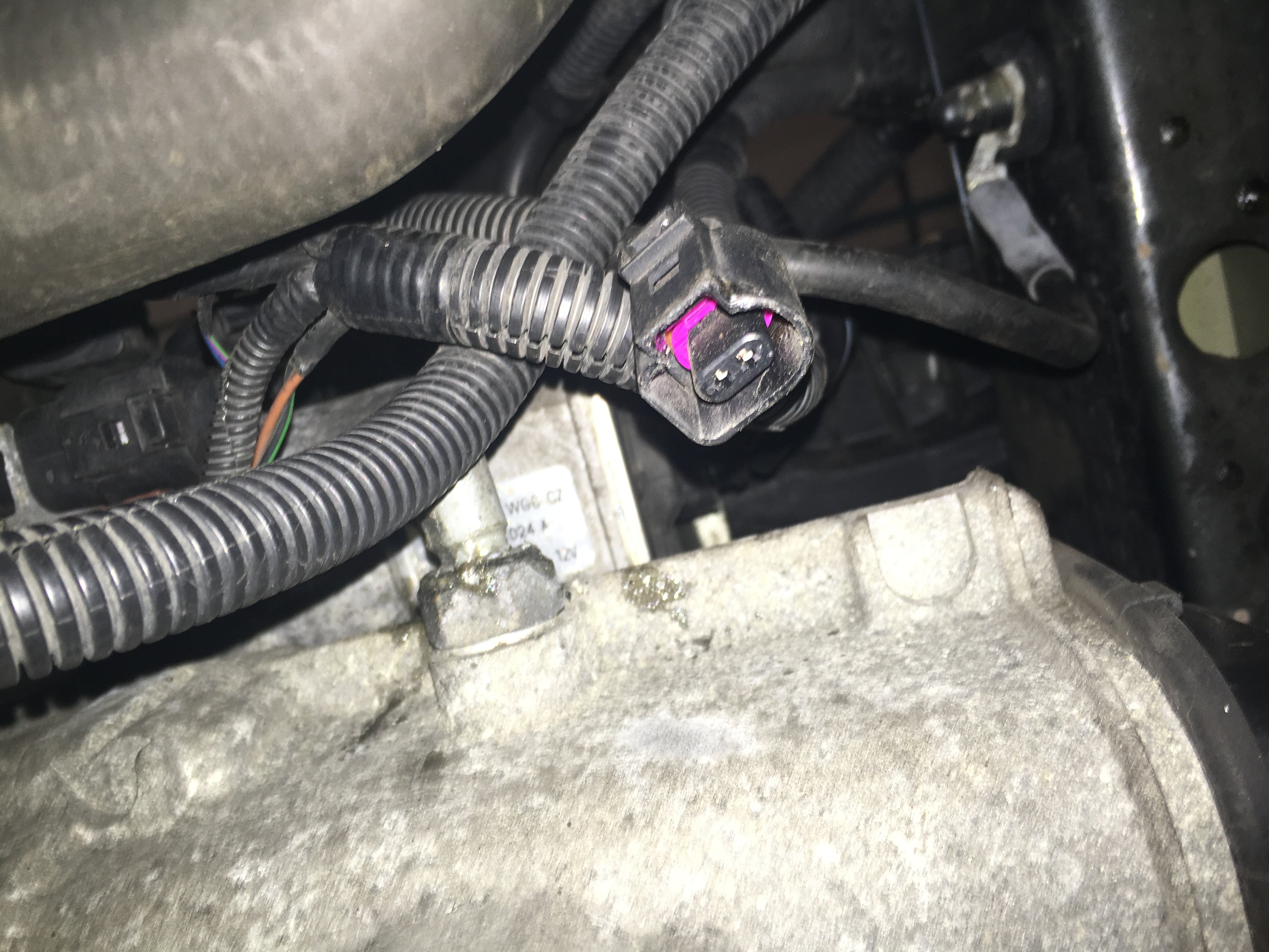

Thought I would check the wiring instead of just setting fire to my car and found a electrical connector just hanging there between the gear box and the starter motor.
Now I'm thinking that should be connected to something..... but can't for the life of me find where to relocate it.  All of the wiring at the bottom of the car is in a shocking state and looks like the garage didn't bother to re fix any of it after competing the work. Not happy.

What colour are the wires going to it?
Is that your reverse light switch just in front of the paper label? Looks like it might belong on that?

Yes you are right, I can see why they left it off now. The shiny residue is glue that they were obviously waiting to go off before re connection after they snapped the switch
