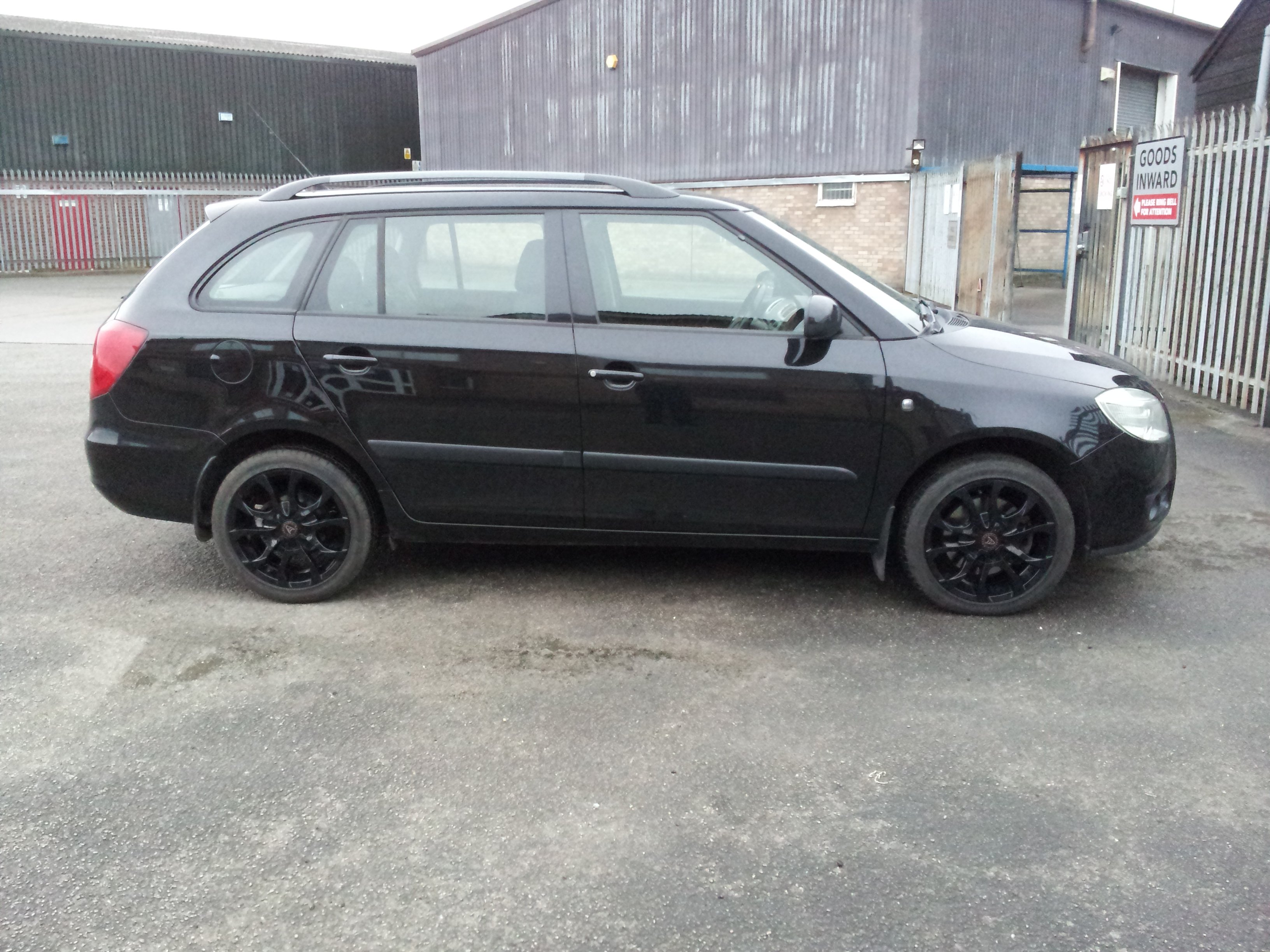

Firstly the tyres fitted are Goodyear Eagle F1 on Wolfrace rims. Checked over no issues there. Tracking and wheel alignment done when tyres were fitted. Could not find any breaks in the springs, and when spinning the wheels didn`t hear or feel any noise or vibes. But I did notice that the inside of the offside disc was more worn down than the other 3 sides of the discs. Would a sticking caliper cause this noise ?  So off to the garage it will go, discs came with a two year warranty so maybe I`ll have some new wheel bearings aswell  while the wheels are off. Thanks for everyone`s  input. Will let you know how it turns out.
