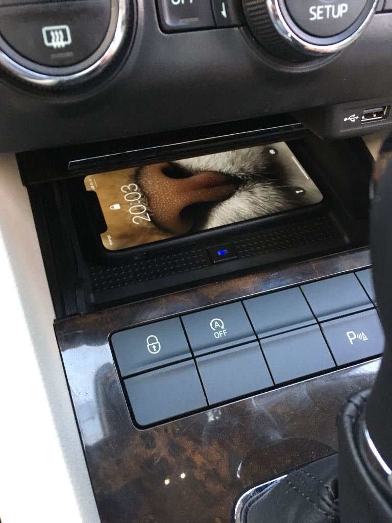

.. and I am very happy with it, so thought I would share my views.
The idea of being able to wirelessly charge my phone was appealing and I was surprised to find that this unit was available to retrofit.
Fitting is pretty easy - it took me perhaps 30 mins, but as always with this sort of job, doing a second fit would probably take 10-15 mins. You need access to the fuse box  for an ignition-switched fuse - 48 in my LHD model.
Also, you remove the plastic panels to either side of the tunnel - a single torx screw on each side, the panels can then be dropped to gain the access. The rubber insert in the phonebox comes out, followed by the panel for the transmission - 3 cables  need to be disconnected and the panel gently levered out.
Then the old phonebox can come out. the base of this snaps off, and the new base with the QI charging coil snaps neatly back on it. There's an extra cable to run from the fuse box to the new base on the phonebox, then re-fitting is the reverse of removal.
In use, it is very simple - a red light comes on with the ignition, it turns blue when the phone is correctly placed.
If you have any questions ... just let me know.

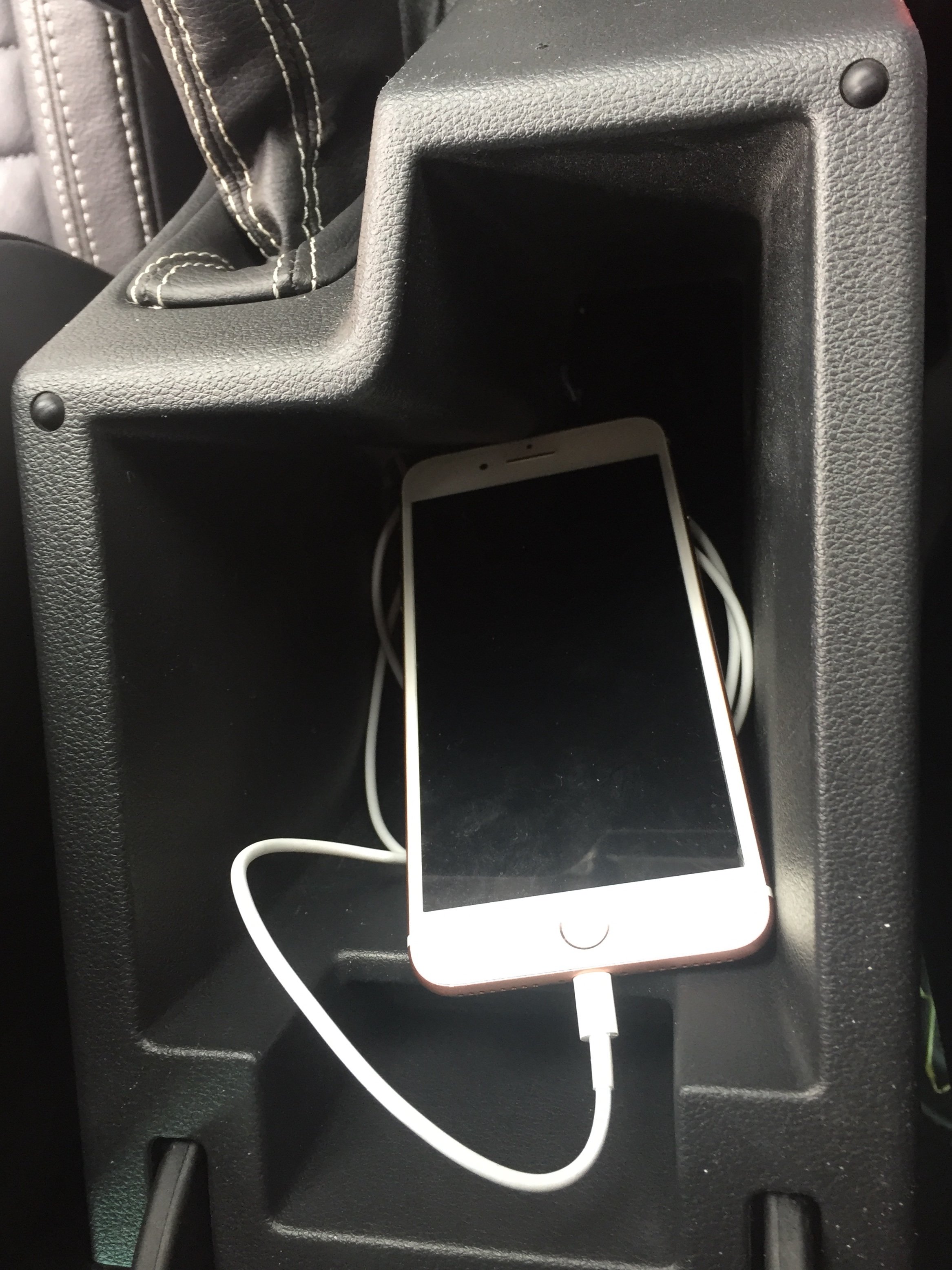

Provided your phone is small enough to fit - my iPhone 7 Plus won't fit :wall:
19 hours ago, Freedom said:
This exact scenario. I was disappointed when I didn't order the QI and then saw the size of the bay and laughed so hard the salesman didn't know what was going on. Glad I didn't waste my money. On a side note, has anyone got a good cabling route for having the phone in the glovebox whilst plugged into the usb socket for mirror link? It's the only sensible place I can fit the phone as i can't close the lid of the arm rest if it goes in there...
