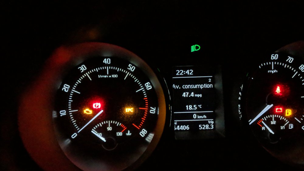

Found this topic because I'd been suspicious of the car's reported MPG for some while. I've been brimming the tank and then calculating manually at each fill up against actual miles done (I get through a tank a week) and I'm actually getting 39-42mpg. Superb 2 with the DSG 175hp diesel. I drive 86 miles a day, 76 of which is on the motorway, often in heavy stop start traffic, or "giving it some welly" when it's clear.
I know if I "hypermile" it behind a truck all the way to work I can get the trip computer (1) to read 60+ mpg so I'm well aware of the difference my driving style makes. If I don't do that it usually reads 44+mpg.
The trip computer on (2) says that it's averaged 46mpg over the last 3000-odd miles.
So the general annoyance here is that I'm REALLY getting about 5-6mpg LESS than the computer tells me. Wanted to see whether this was true for others and from comments on this thread, it seems like it probably is. I'd rather it told me the cold hard truth!
I love my Superb but it drinks like a damned fish... it's too much fun and too comfy to drive very sensibly! :inlove:

As I pointed out earlier in the thread, this can be calibrated using VCDS. You need to keep records of actual consumption per tank, and the average consumption calculated by the MFD per tank. Over several tanks you'll get a good idea of the discrepancy, which can then be used with VCDS to correct the MFD readout. Typically, the MFD on VAG cars is about 15 % optimistic.
On my own car to date, the MFD is averaging 13.6 % better than actual*, monitored over 12000 km. My real world economy over that time has averaged 8.04 l/100 km (35.7 mpg). Best tank was 6.18 l/100 km (45.7 mpg) acheived during a week where nearly all my driving was long trips. Usually my driving is urban, hence the poor economy. Worst tank was 9.34 l/100 km (30.3 mpg), during December last year.
* Calculated as (Real Economy - MFD Economy)/MFD Economy - economy measured in l/100 km.
