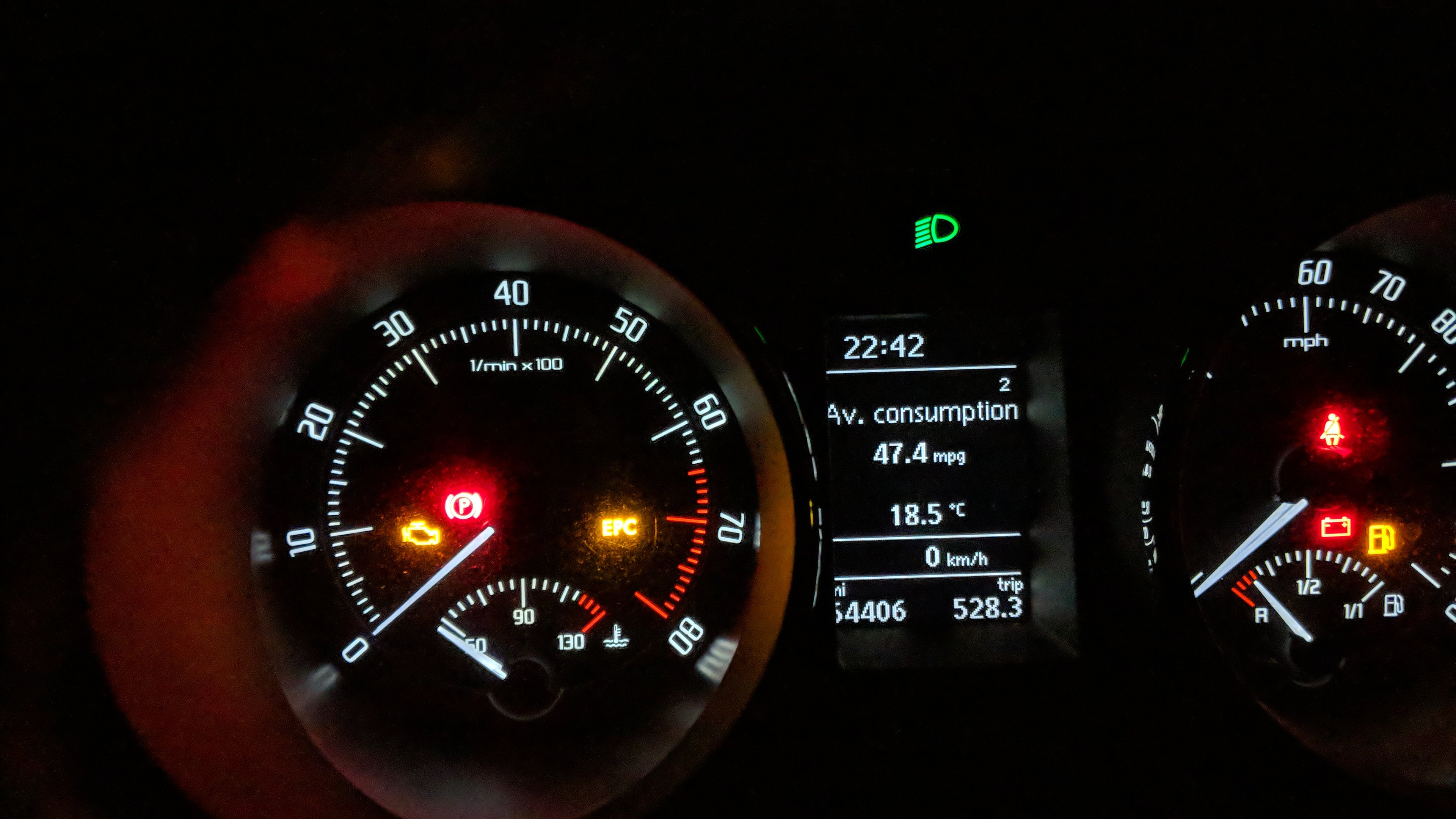

Just been out and checked the latest fuel consumption it's 53MPG (probably 48 actual) over the last week/300miles.  In that time I've not driven it, all the miles have been done by my wife, she normally doesn't get such a good figure as she's doing 16 miles a day to work (and the same back home again) just over half of which is motorway.  I'm wondering if the recent change of brake calipers has improved it.  Perhaps they were dragging more than I thought.
I've got a 270 mile trip on Thursday mainly motorway, be interesting to see what that returns.
Filled up last night and did a 273 mile trip today, when I got back MFD was indicating 64MPG, filled up again, took 22L so just over 56MPG in reality. Seems that the MFD is getting even more inaccurate but as I'll net £113 for the trip, can I be bothered?

The 41 mpg is based on refilling. The cconsensus seems to be that the MFD lies.
My best tank based on refilling in Ireland was 60 mpg, MID said 65 mpg
(My best tank based on refilling in the UK was 65 mpg, MID said 68 mpg)
My worst tank based on refilling was 44 mpg, MID said 46.5 mpg
My long term consumption over 2.5 years, based on refilling calculation, is 48 mpg. The MID averages would have been 53 mpg. Time spent driving  would be 40% urban, 40% rural or 2 lane roads and 20% motorway.
On a separate note - I have been to the UK with my car a few times. I always get a 5 to 6 mpg per tank boost over driving in Ireland. I put that down to the speeds I was kept to (slow but economical) as well as the motorways being busier with far more time spent in SUV/truck/lorries slip streams.
Since I bought mine in May '17 I've been recording MFD average for each tank along with actual economy. After yesterday's refill my data showed that the MFD was an average of 13.7 % better than actual. Using that I adjusted the MFD upward by 14 % using the adaptation channel in the instrument cluster (only whole number adjustment allowed).
On a 388 km round trip today (60/40 motorway/A-road) MFD reported 6.1 l/100 km average, about 46.3 mpg.
