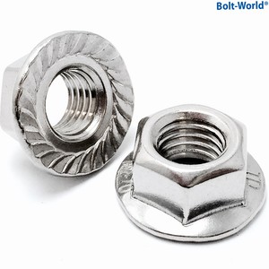

Interesting, what is the "serration" referring to.
That I don't know. That's the wording from the manual. There's probably a PR code for it somewhere that a dealer can check against.
  • Sponsor
Serration refers to the texture (serrated or smooth) of the underside of the bolt head, I think.
My bolt has no serrations so it looks like it needs the big torque, that's nearly twice as high as my torque wrench goes! And then another 180* on top, seems a bit OTT to me.  You'd think it was holding a battleship down!
Had a go at this at the weekend.  The underside of the new bolt is not serrated so should be the 200NM +180°, I managed to get the torque but no way was I going to get that extra 180°.  Managed about 45° that was with an extension on my breaker bar, maybe if I'd had a 10' scaf' pole handy I'd have had a chance, suspect something would have broken first though.
Although the original bolt was serrated this was not very tight, don't think it was even the 70nm.
