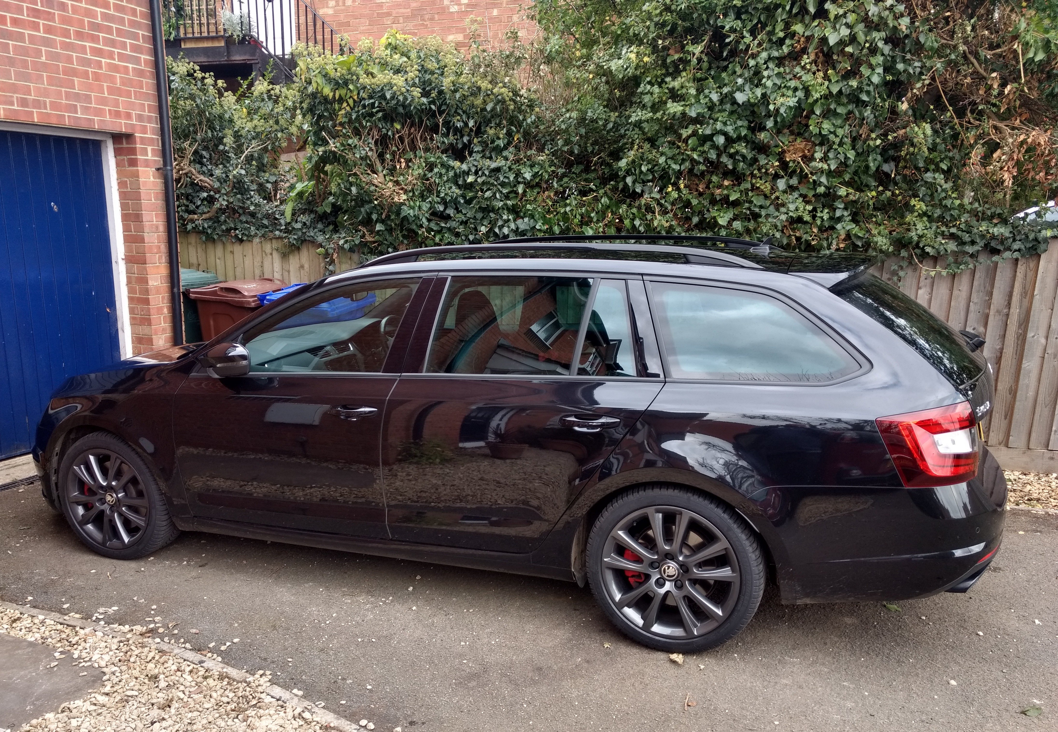

So if I decided to get the 16” Steels for my car (currently 18”) will be a hassle to get sorted as I am not good with wheel size and what tyre size to use etc..

If your vRS is a petrol, 16” wheels won’t fit due to the larger brakes. The diesel should have smaller brakes but that’ll depend when it was made. Double check.

I'm not sure a normal 16" Wheel would fit on the vRS.
I have 17" Dezent TD wheels on mine & the clearance to the front brake calipers is only a few mm's & the tyre fitter had to use low profile weights to avoid contact.
I wanted steel wheels to begin with but after investigation found its almost impossible to find a steel Wheel above 16".

I also have the Dezent TD wheels but in 17" form.
Do you use the spiggot rings because the ET you bought was different that the standard for the O3 ? (worried now because i just fit mine directly onto the Wheel hub....)

Are you sure?  I thought the received wisdom is that the Mk3 (TSi at least) needs 17s, and not all of them fit  (see the earlier thread linked to above)
Certainly my 245 has an 18" spacesaver. My Mk2 VRS had a 16" spare, perhaps that's where the idea came from?
