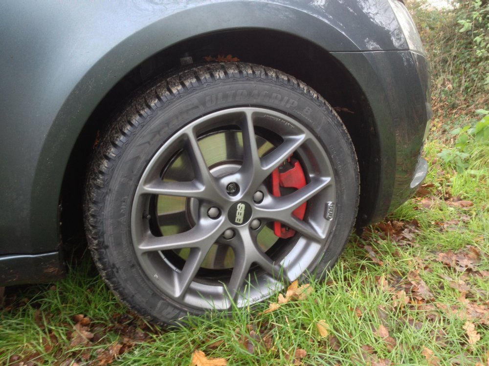

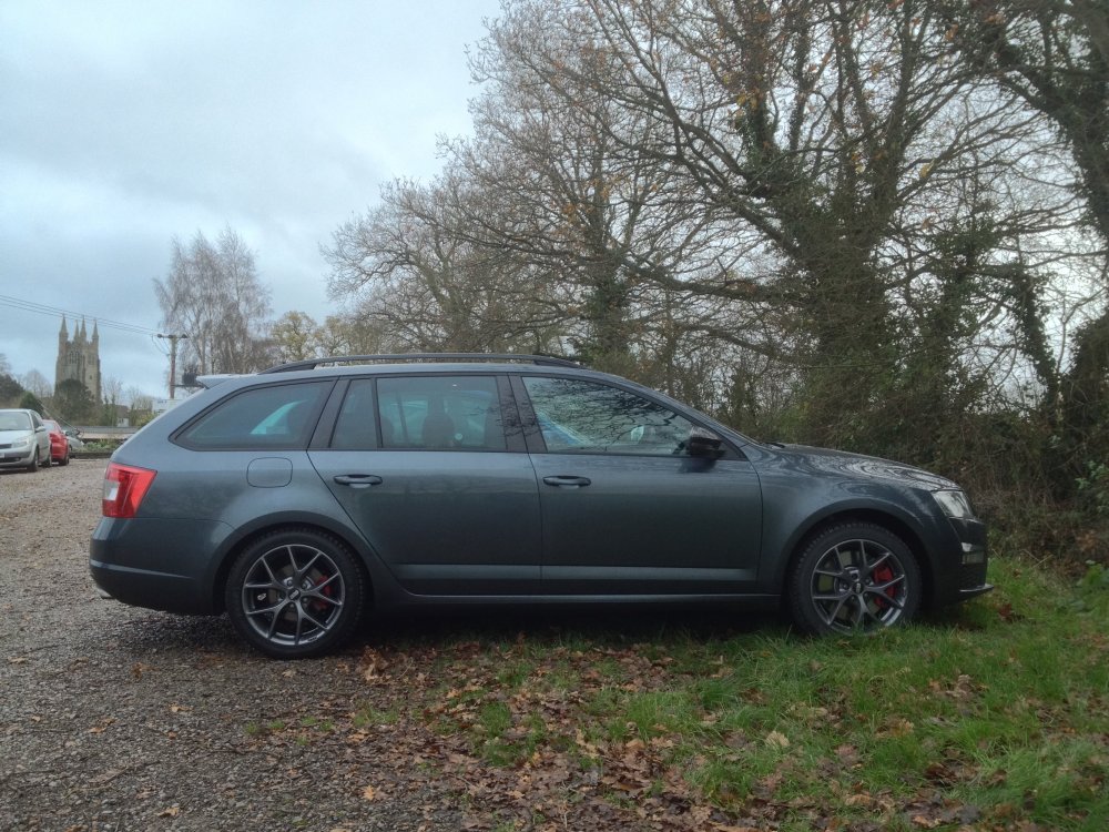

Well AFAIK the MY13 onwards will take 16’s
My Leon FR was a 63 plate, shared the same brakes as the TDI vRS and I ran 16” Winter alloys for 3 years with no issues,  *just* enough clearance.
