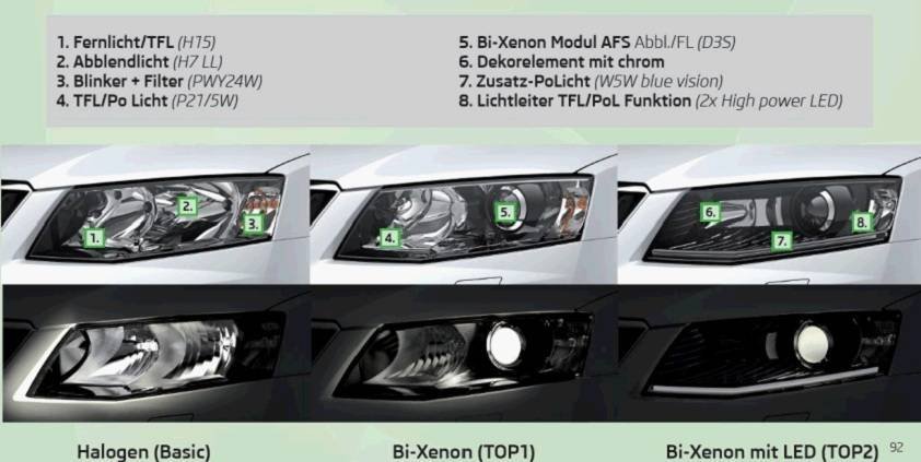

These are the different options for genuine MkIII Octavia headlights.
The middle version appears to have xenon / bi-xenon dipped headlights, behind a projector, but a regular halogen main beam / DRL in front of a reflector.
Note that only the first (all halogen) and third option (bi-xenon & LED DRL) are available in the UK, the middle version was never fitted to an Octavia destined for the UK market...
The pre-FL MkII Octavia also had a headlight option that was never made available in the UK. All MkII pre-FL Octavia's here had projector dipped beam, halogen or xenon, but outside the UK there was a version of the headlight that was without the dipped beam projector, they were all 'reflector'...
