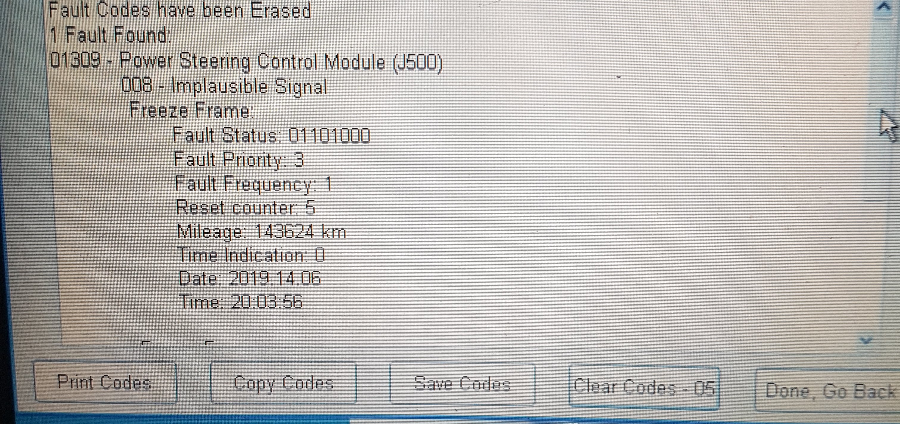

Got my steering rack replaced today due to a clicking sound in the steering traced to the rack. I have scanned the car and have a 01309 fault power steering control module j500 implausible signal. Any ideas how to fix?

It was fitted by a garage , vw Indy, and rack is new. A mate has vcds so he scanned it but all it shows is the error above
I don't doubt the code, it's just hard to offer advice without seeing what modules the car has and how they are configured.
What do I need him to scan for me?
A full vcds autoscan is a good start.
It'll create a text file you can open then just copy and paste here.

Clearing the code doesn't work it came straight back. Haven't had a chance to get to my mates house today to get another scan done, from what I remember nothing else showed up on the scan just the fault posted
