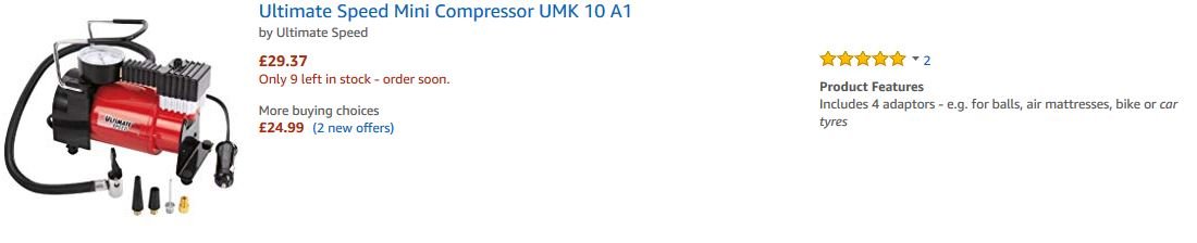

Thank you for your comment and your recommendation for a decent tyre pressure gauge, Delberthot. It looks like a good piece of kit and I should purchase one shortly. Yesterday I bought a mini compressor and tried it out on my winter tyres. The seal was solid on the valves and it effortlessly inflated my tyres to 2.2. After hearing what many people have said on this thread, I will have to deduce that my foot pump that I've used is faulty (seal not tight on the valve, which makes it constantly loose air and the guage not being accurate). I also had problems at several garages in town with their air inflation machine (poor seal especially).
@steva: +1 from me on the mini compressor, although I bought mine from Lidl a couple of weeks back for £14.99 ...
Same here, StickyMicky. I got mine from Lidl yesterday and cost 1,299 dinars, which is less than £10. It was worth the very early start, as over half of them were gone within half an hour of the store opening. I still think that I shouldn't just trust the gauge on the compressor, but should buy a dedicated tyre pressure gauge to ensure I have the right tyre pressures from now on. Is "+1" your rating of the compressor? Does that mean you don't rate this compressor very much?
No, the "+1" means I agree with your comments.  I've had a few mini compressors over the years and this one seems the most robust. Time will tell how long-lasting it is ...
Interesting BTW that Lidl can still make a profit selling the compressor in Serbia at less than £10. Either they're making an obscene markup on their UK offerings or the UK is a much more expensive place to do business.
