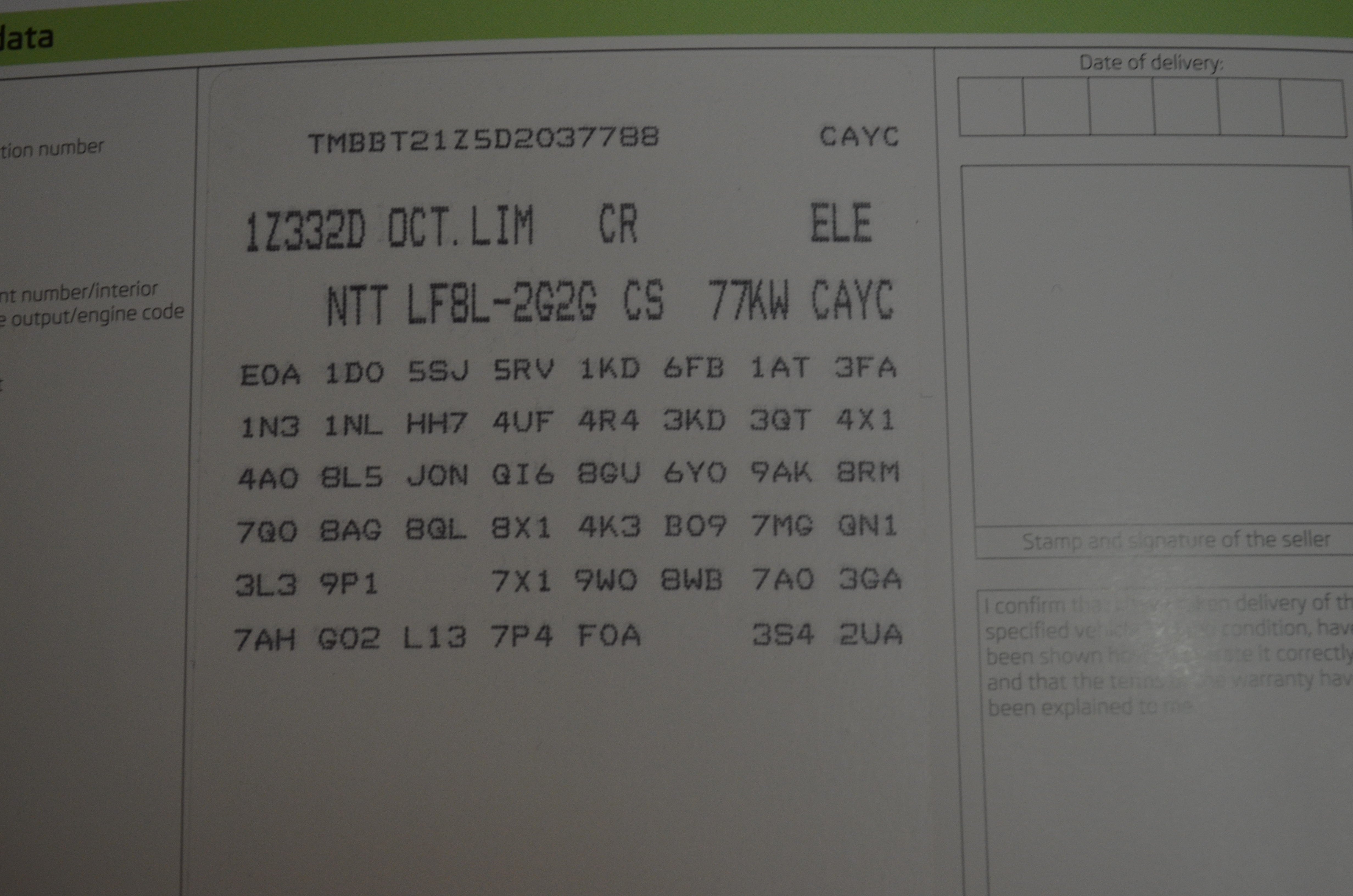

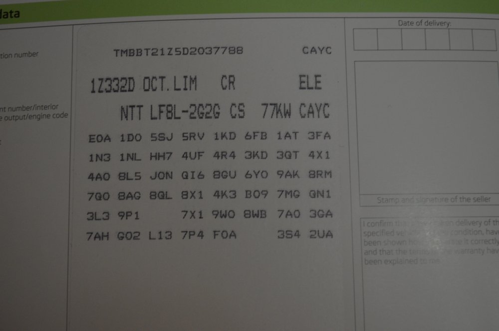

Thanks both for your help. I have a copy of that sticker in my service manual and it doesn't have the code 7GG. I will take a picture of the sticker and post it shortly.
Data Sticker for my car.
7MG = Emission standard EU5

Ok thanks for that, but I am still none the wiser. We used proper words and sentences when I was at school. What is EU5?
Your car has a DPF,  use the engine oil required, Spec to meet is VW 504 / 507,  so that is 5w 30 Full Synthetic.
Euro 5 was and emissions standard, 2009-2015,  caught up in the VW Emissions Scandal, then from September 2015 Euro 6.
Now from September cars have to have the WLTP / RDE test & approval  and will be Euro6 d temp.
the TDI's have SCR which means they use AdBlue.
None of that matters, your car has a DPF.
