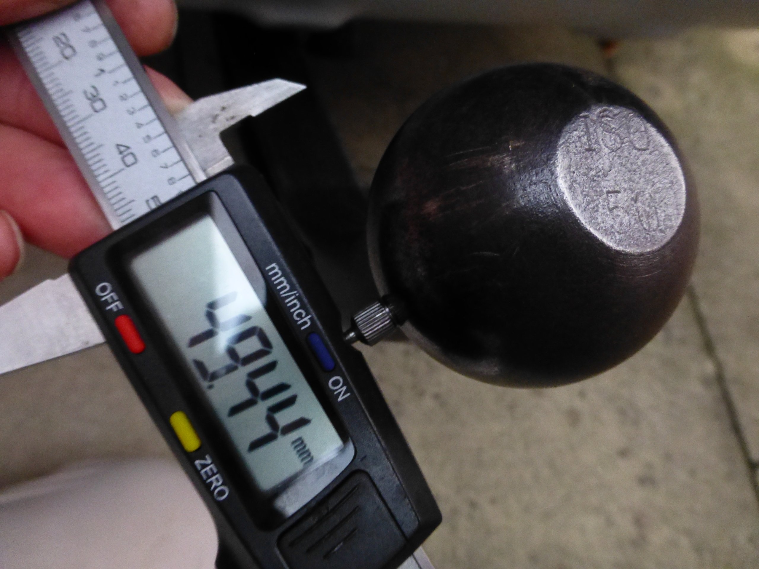

Hi All, I have just bought a new caravan and it didn't tow very well (snaking) at times so while checking everything out I checked the Alko 3005 hitch which has pads inside for stabilising the outfit, everything was brand new so that was OK, so I then turned to the factory fitted towball which is detachable on our 2009 FL Octavia Scout, on measuring the towball size it was 49.50mm and on checking the Alko manual it says the min size for the ball is 49.61mm so it was too small for the pads to lock onto affectively ! I have a replacement set of pads for the hitch that come with some washer shims in 2 sizes 0.3mm and 0.5mm that go behind the pads so I fitted one 0.3mm behind one and it now tows OK. So the question is are ALL factory fitted towballs undersized when the standard is 50mm ? Cheers Stuart

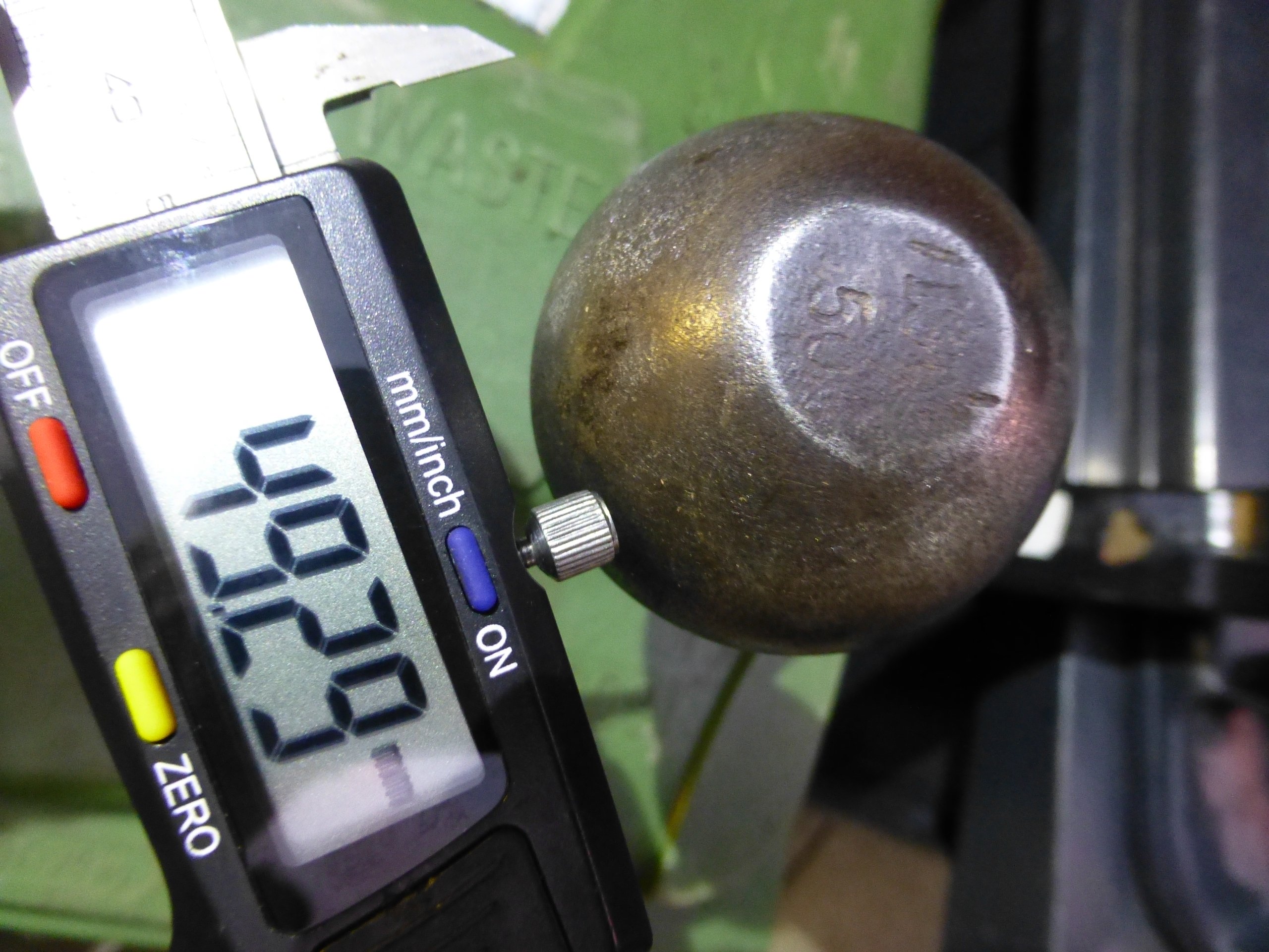

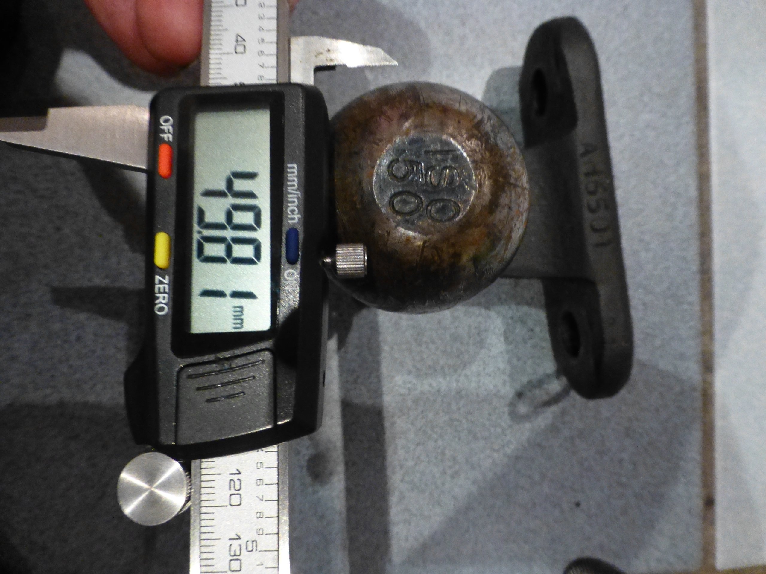

Thanks for the replys, I measured it with a digital calliper today 49.44mm, there's no grease on the ball or pads, it's a new van picked it up in Feb 2018, but it looks like the towball IS smaller than the min ISO of 49.61mm ! I have a spare 2nd hand ball of the same type and that measures 49.29mm which again is smaller, I will attach some pics, I have just measured a normal ISO towball and that's 49.81mm can anybody measure their towball size to see if it's just my type that looks smaller than standard ? I wouldn't have thought the ball itself wears that quickly or does it, or is the digital calliper not brill ? Cheers Stuart
It could certainly be the caliper - if it's a cheapie one what you've measured might be in spec.
I just went out and measured mine (OE detachable swan neck) and the ball is 49.93 mm with my Aldi digital caliper.
Double check you have the jaws across the widest part of the ball when measuring. If you're not sure about the caliper's accuracy check the diameter of a HSS drill bit with it.
