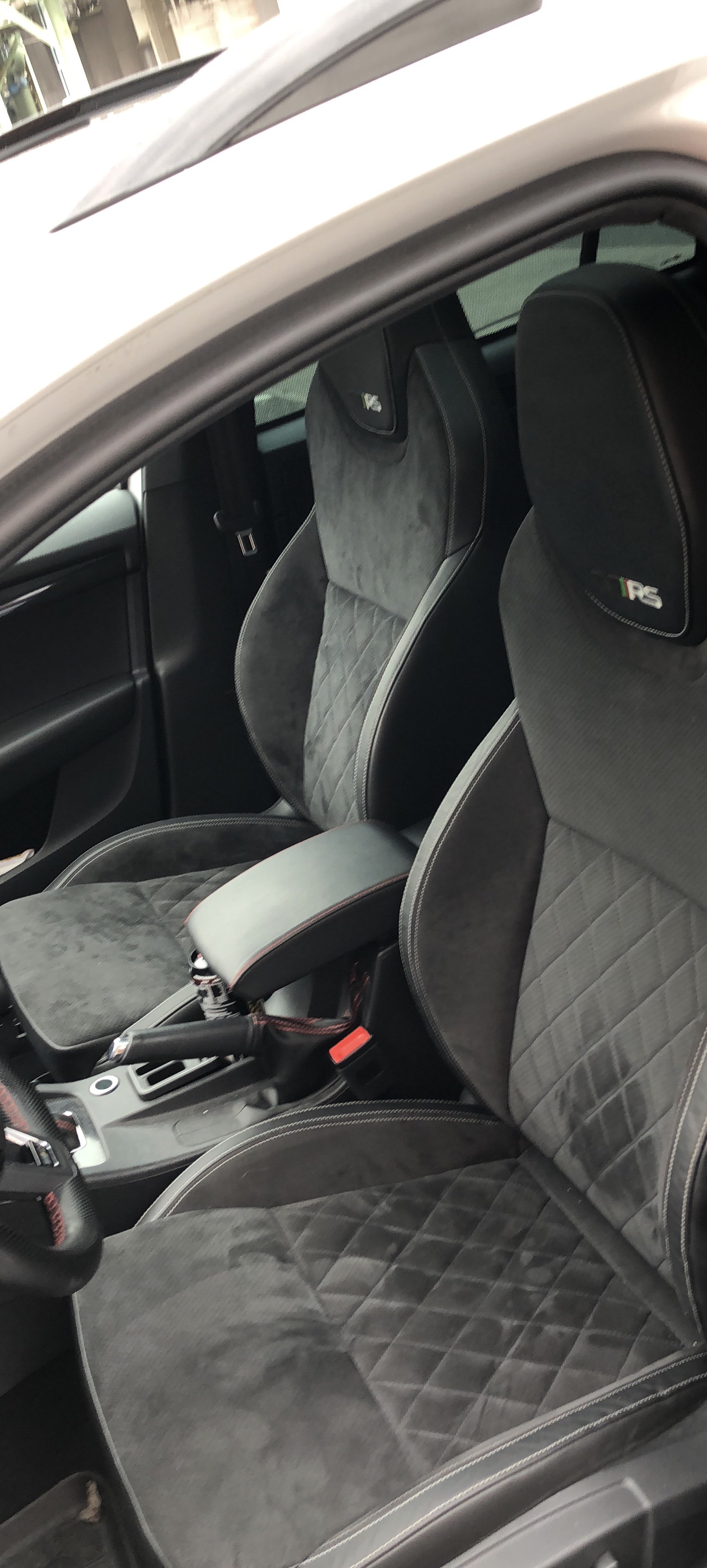

Trust2K - wow, the facelift seats look fantastic, great work!
Did you use a Skoda / aftermarket wiring or did you make your own?
Also, can you advise where the wires connect to at the dashboard end - is it only to the BCM, or are there other wires that are connected elsewhere?
