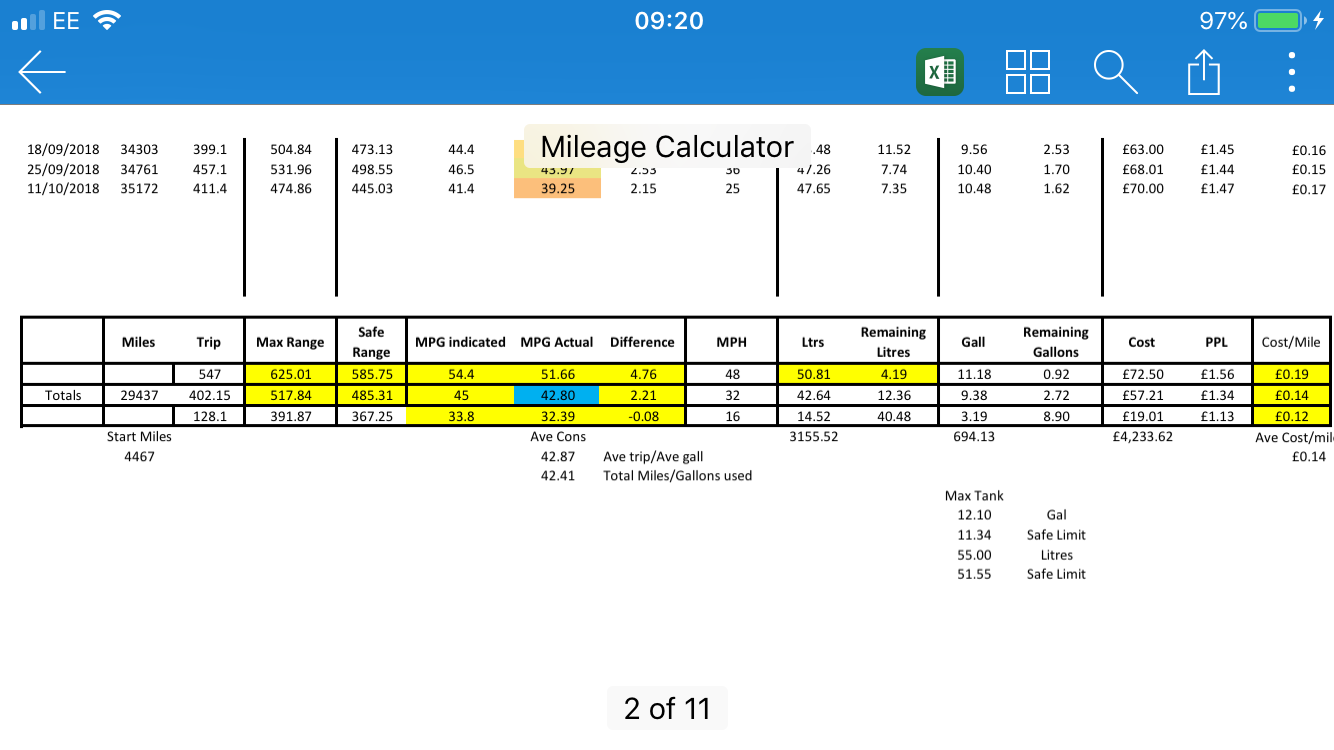

Here you go! After nearly 30k of mainly motorways on Cruise my 4x4 Vrs is doing 42.8 to the gallon. (Actual mpg as dash indicator overreads by 2.21)
Mapping doesn’t improve overall mpg by anything significant. The energy required to keep a car at a set speed will be the same whether it’s mapped or not, all other conditions being equal. Biggest mpg improvements come from driving style and how you get to that set speed.
So mine is definitely a bit low. A 4x4 should be lower than a 2wd.
Hey
I like this excel sheet... Can you share a copy?
