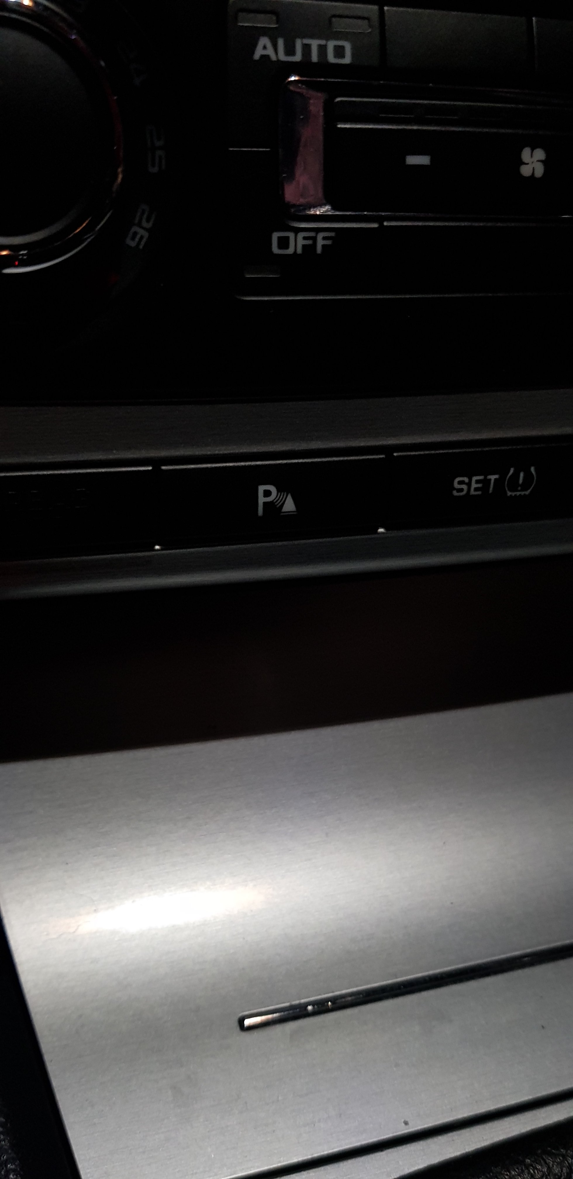

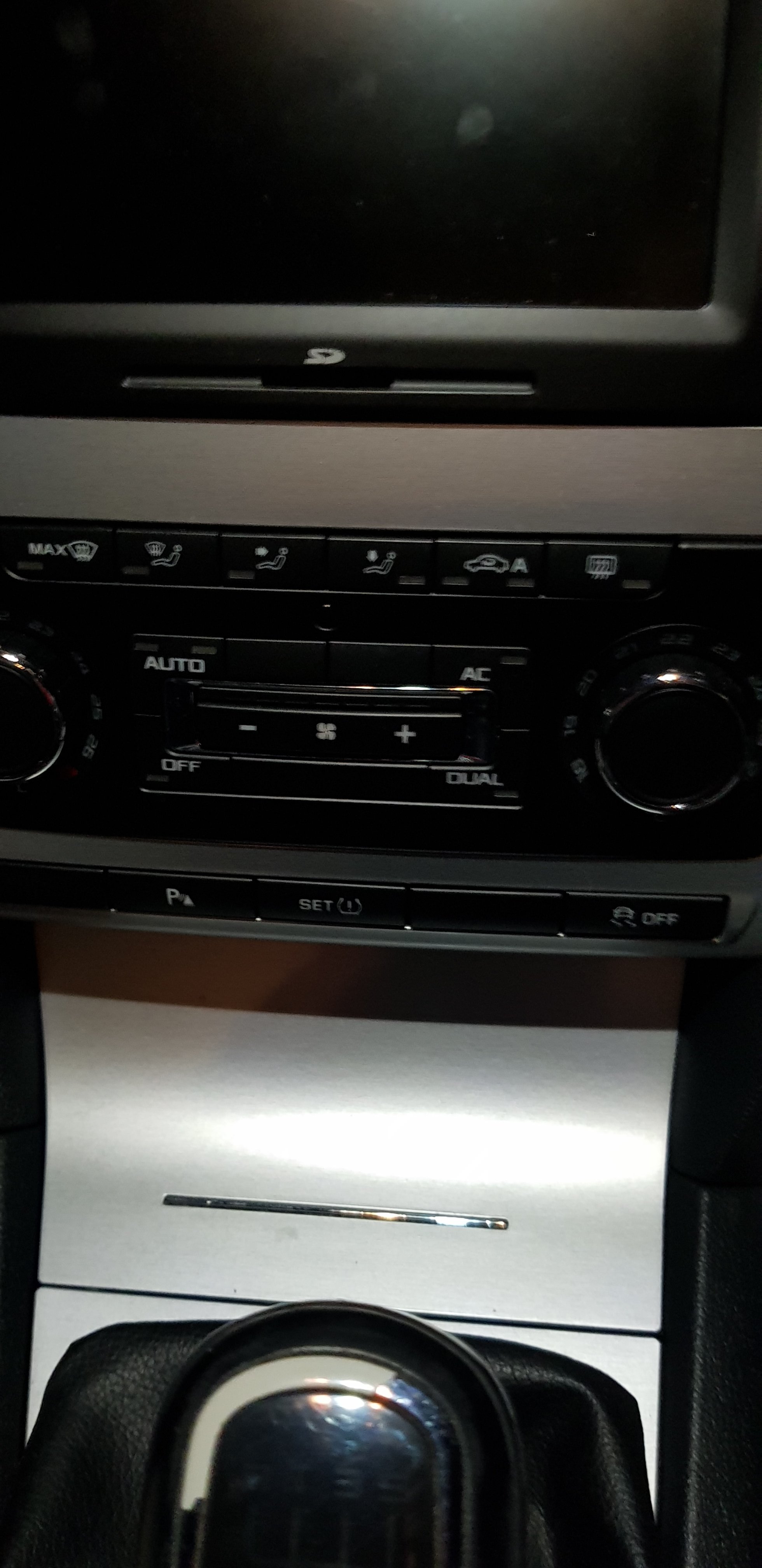

See the attached images of parking sensor button. Just seems odd that the button be there.
That suggests the car had front and rear sensors...
If neither are fitted, I'd be tempted to check if it's actually wired in to anything.
I specified front parking sensors for my Scout (rears were standard fit) and the location of the 'P" button in that image is different to where mine is located (directly next to the TCS button.
Unless the button was located differently in the vRS, it could be possible the rear parking sensors were installed by a previous owner and have subsequently been removed.
Does the button illuminate when you put your lights on?
I had a VRS estate with rear parking sensors and I did not have that button on mine so it is not to do with the rear sensors.
As said above, the button was only ever fitted if there are also front parking sensors.
With rear only sensors they are automatically engaged when putting  the car in reverse. They disengage when you then start going forwards.
When you have front sensors too, they are also activated when putting the car in reverse, but they don't disengage until you are going over about 10mph or you press the button.
You can also press the button to enable them when driving forwards into a space etc.
Maybe that button was placed afterwards but seems not to be connected anywhere , could be for cosmetic reason?
I checked with Erwin as suggested and it seems the car did not originally have reverse sensors.
No idea what the superfluous button could have been used for. But the car has been a police fleet vehicle so maybe a blues n two's button? Who knows.
