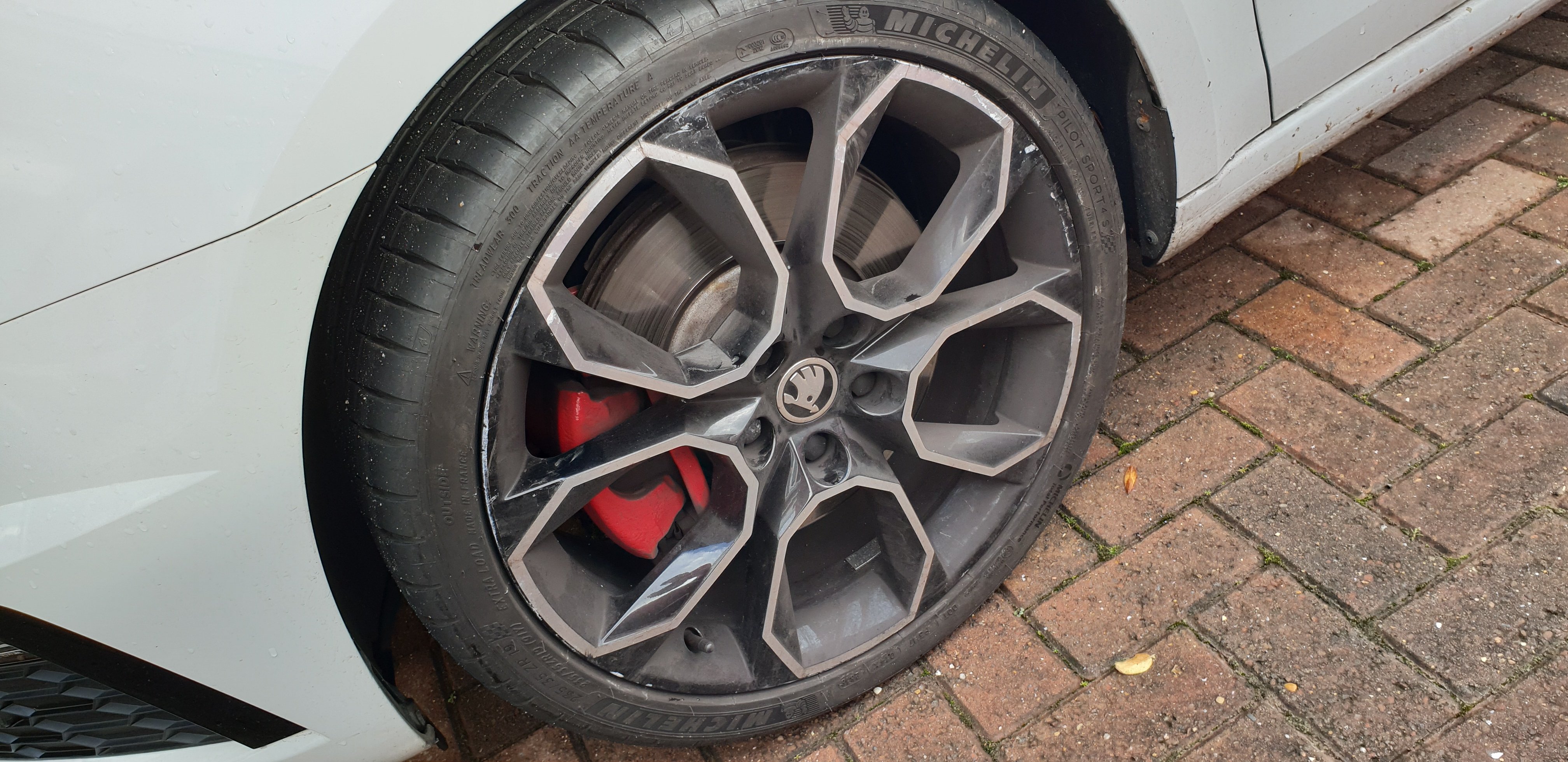

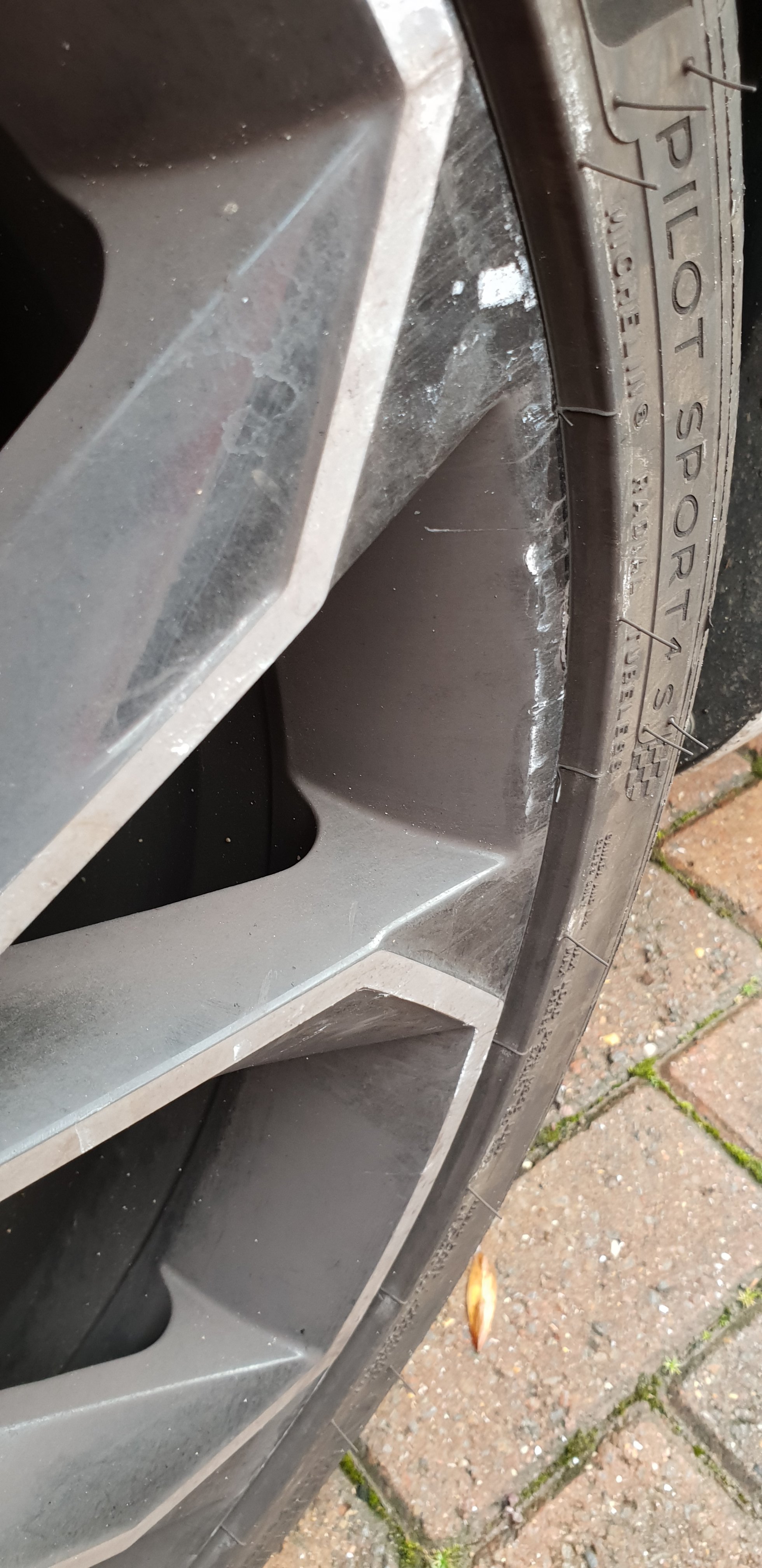

Don't know if the pics do it justice, but here you go...!
...and I still haven't got round to washing the tyre grease off... :blush:
Looks pretty much the same with extra protection.... Might need to see the whole side on view to be sure but these look good... Thanks
Yeah, you can't tell how much wider they look unless you see the Michelins side-by-side with the Pirellis. The P-zeros look like they're pulled tight over the rims in comparison.
