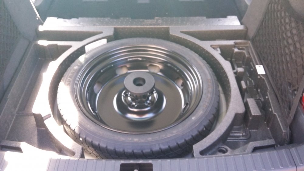

I bought anaftermarket space saver with jack etc. and the foam insert that wraps around the wheel (less than £10 from Skoda), jack sits in the centre of the wheel and it all fits nicely, if you have the full sized spare doesn't raise the boot floor up ?

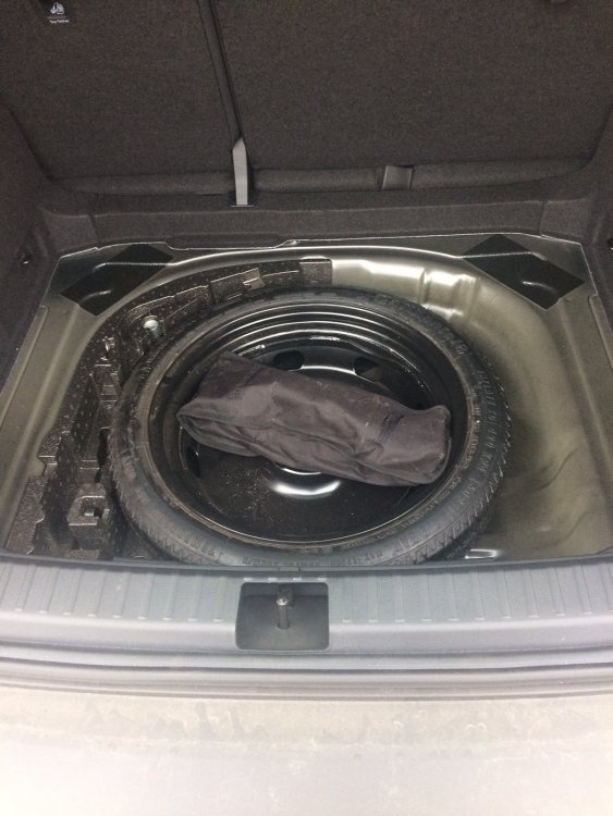

I recieved my Karoq 1.0 and it has a smaller then normal tyre. Its size is 215/60R16 99v
That was to save space, but it is not a 'Space Saver' and obviously not a 'Full Size Spare' for your car, but would be on a car with 215/60 R 16's.
VW Group only do limited sizes of Steel Wheel Spares with Tyre Sizes.

When we purchased our Karoq there was a choice of wheels to buy, depending on trim level.  For the SE only, a full size spare wheel was available.  For the SEL and above a temporary steel wheel, 215mm width, and for 4x4 models a space saver wheel, 125mm width.  I presume that the spare wheel well is shallower on the 4x4 and the varioflex seats encroach slightly, dictating which wheel fits in which variant.  As mentioned previously, only a very small range of spare wheel sizes is available so the spare may not be a perfect match.
I noticed mine states a space saver spare size on the label inside the petrol flap, something like 125/70 x 18, mine didn't come with a spare, so I assume this will be on all models

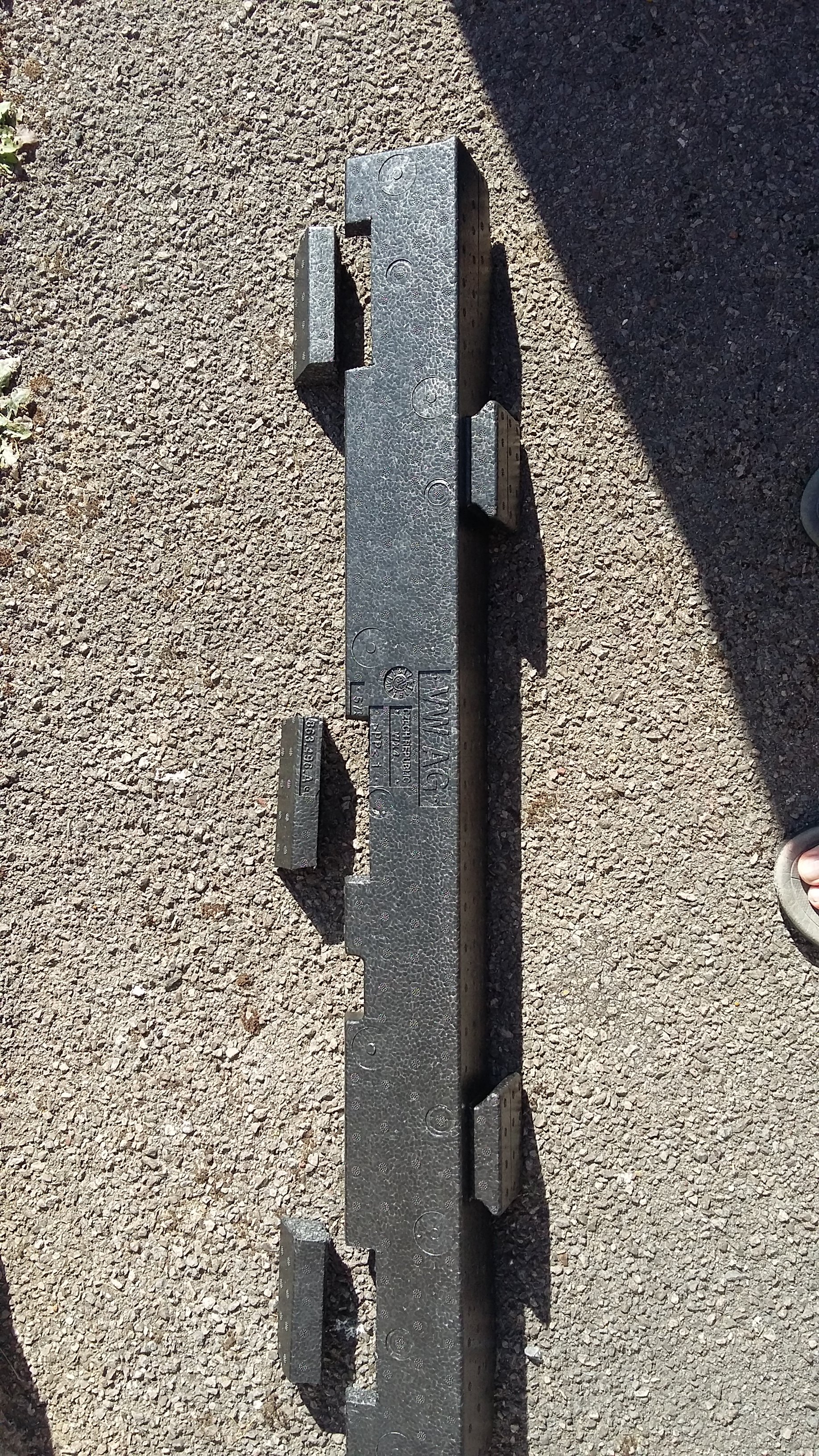

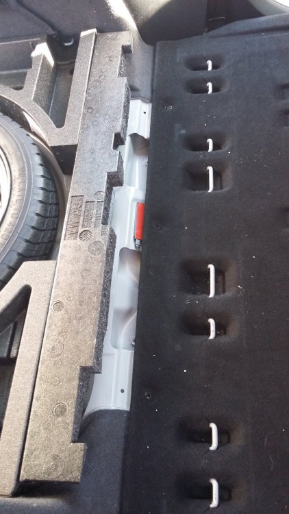

The space saver wheel is needed for the 4x4 versions - they only have a shallow well for the wheel as the space under the floor is needed for the Haldex unit. The tool kit and polystyrene casings say they are for fixed seats only - however the problem is that there is no cut out for the Varioflex handles. This is easily rectified with a craft knife and careful cutting,
A bit off topic, but (I think) that red, rectangular device under the seats in your last picture is the signal booster which is causing all the hassle and butchering. Someone please correct me if I'm wrong. Out of interest, if it is, when was your Karoq registered and when did you get it John?
You know - I wondered what the red rectangle was when I did the work but never got round to asking on the forum!!
My Karoq was one of the first - a launch model at my dealership. It was built in November 2017 and first registered in Jan 2018. I bought it in Feb 2018. All pre booster controversy.
