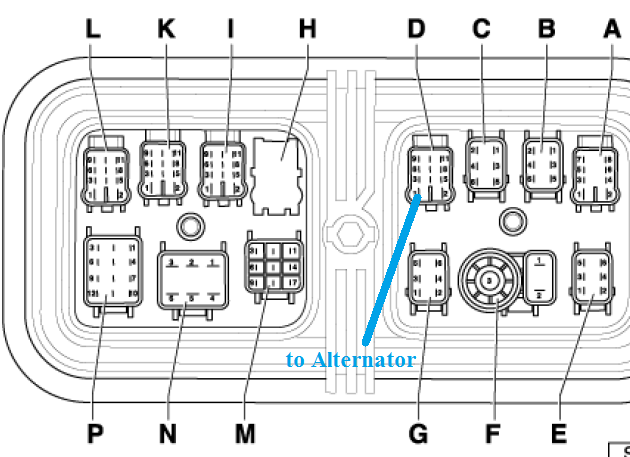

Have you found that blue wire from the cabin yet, to connect the alternator to?
On your car it should run from pin 1 of connector D at the firewall, to pin 3 of the 14-way connector near the main battery earth connection to chassis.
Firewall end:
Firewall end:
Thanks for pics, I'll look for that once I got time.
