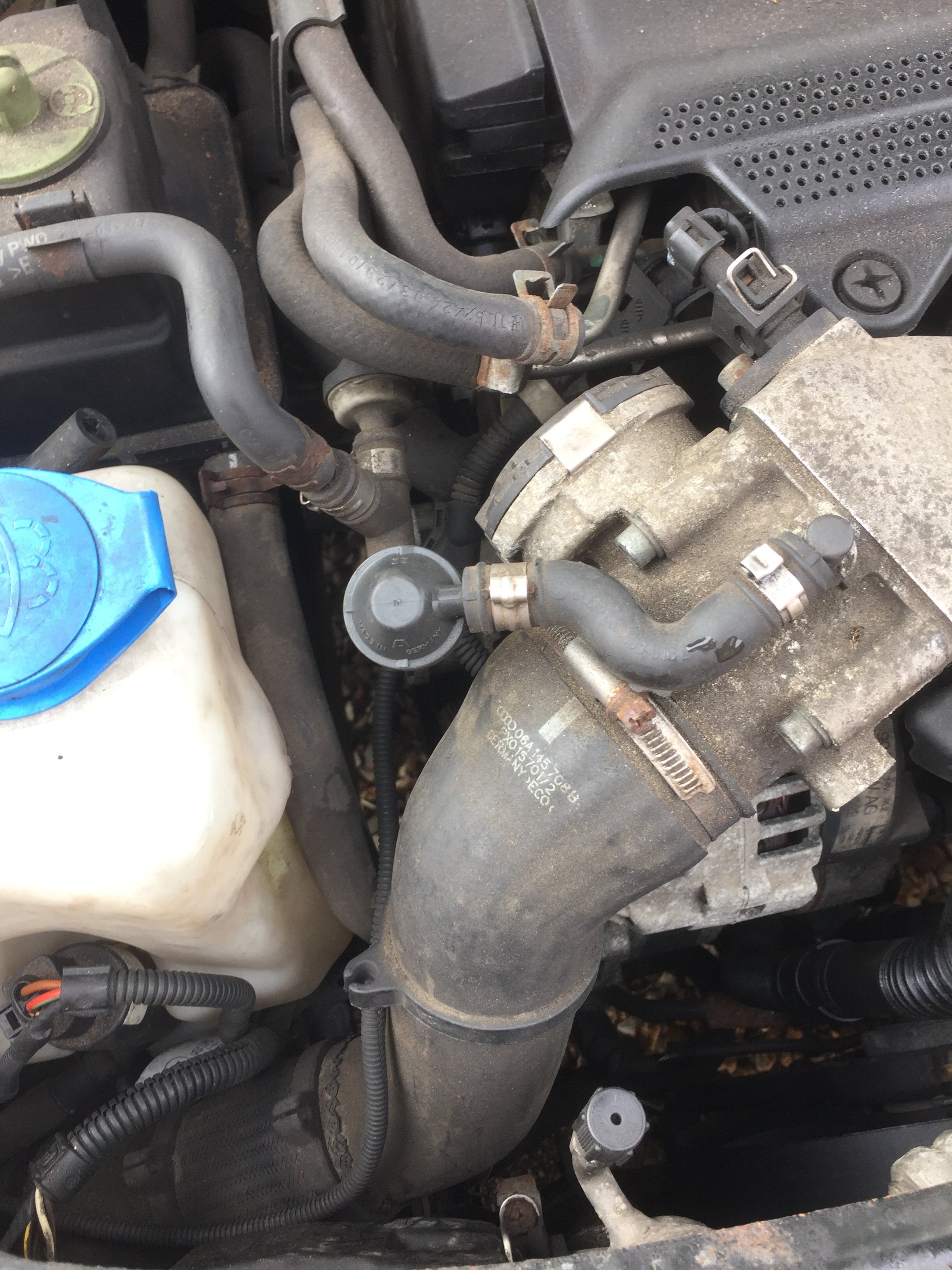

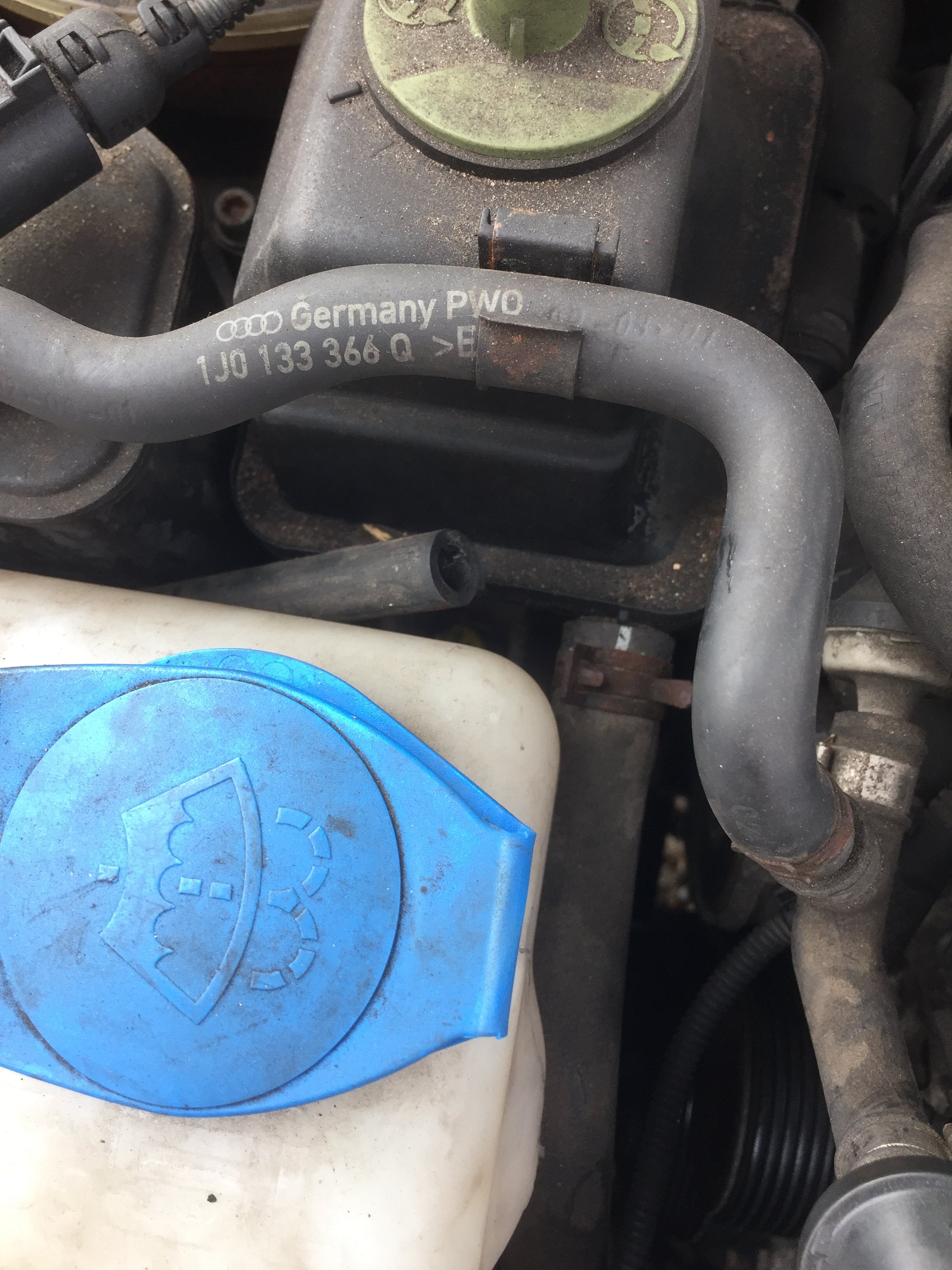

I've had a good look at the hoses etc, and saw something I have never noticed before - behind the washer reservoir, the is a rubber pipe protruding, apparently going nowhere. If it is meant to go somewhere, it isn't obvious to me... I'll attach a couple of photos. If that is not the cause of the problem, I guess I'll have to wait until I can clean the throttle body. Any thoughts or information on this pipe would be most welcome .
