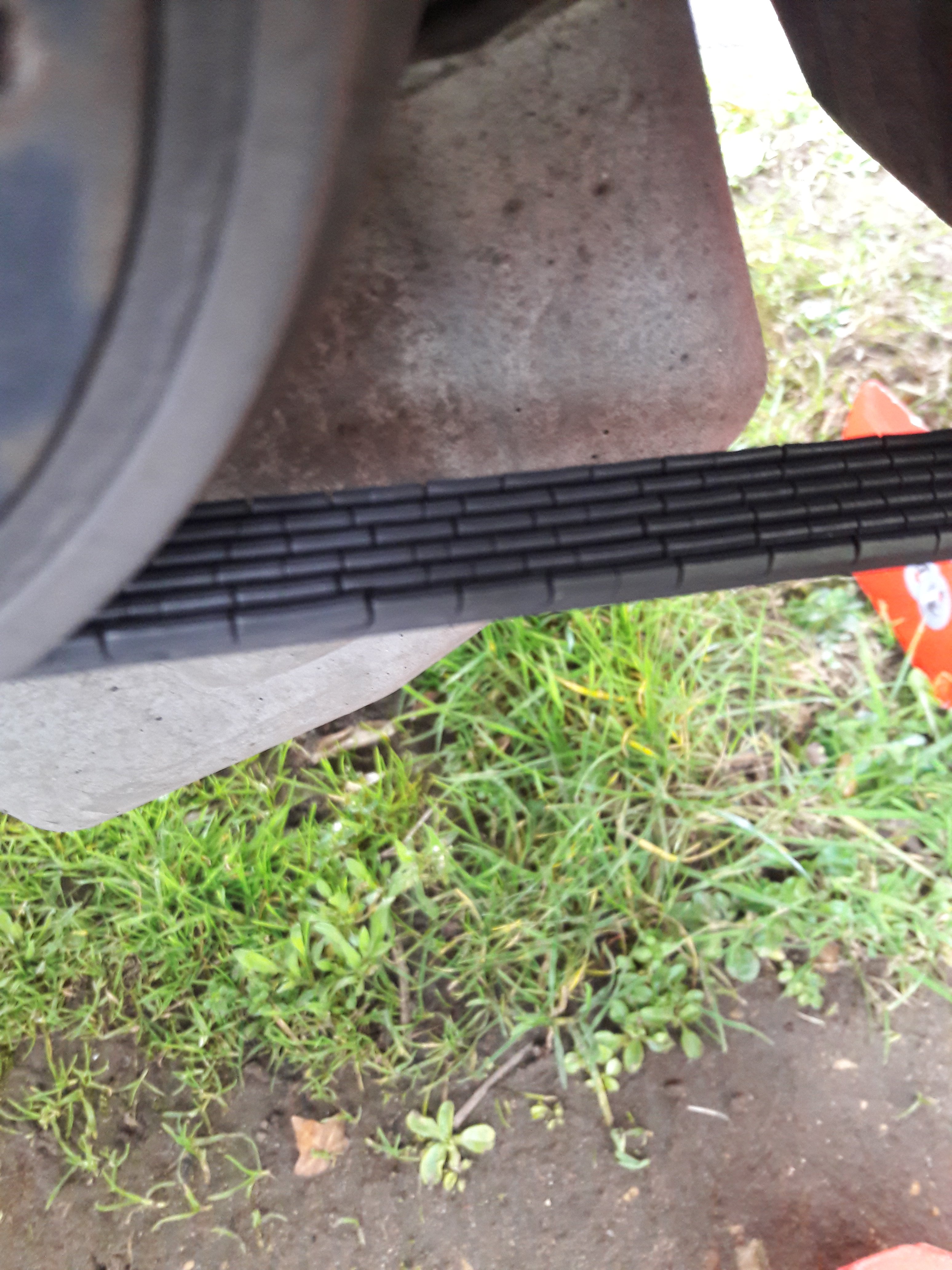

So now I wonder what's the service requirement of the belt & pulleys I can see ?
  • Sponsor
Depends how long you're keeping the car. Might be worth inspecting now or on the tenth birthday of the car, look for cracking  and bits falling out between the cracks on the peaks of the 'vee' pattern on the inside of the belt.  I changed one on a 2002 Golf recently that I'm pretty sure was the factory fitted one, it was still working fine but looked well dodgy:
