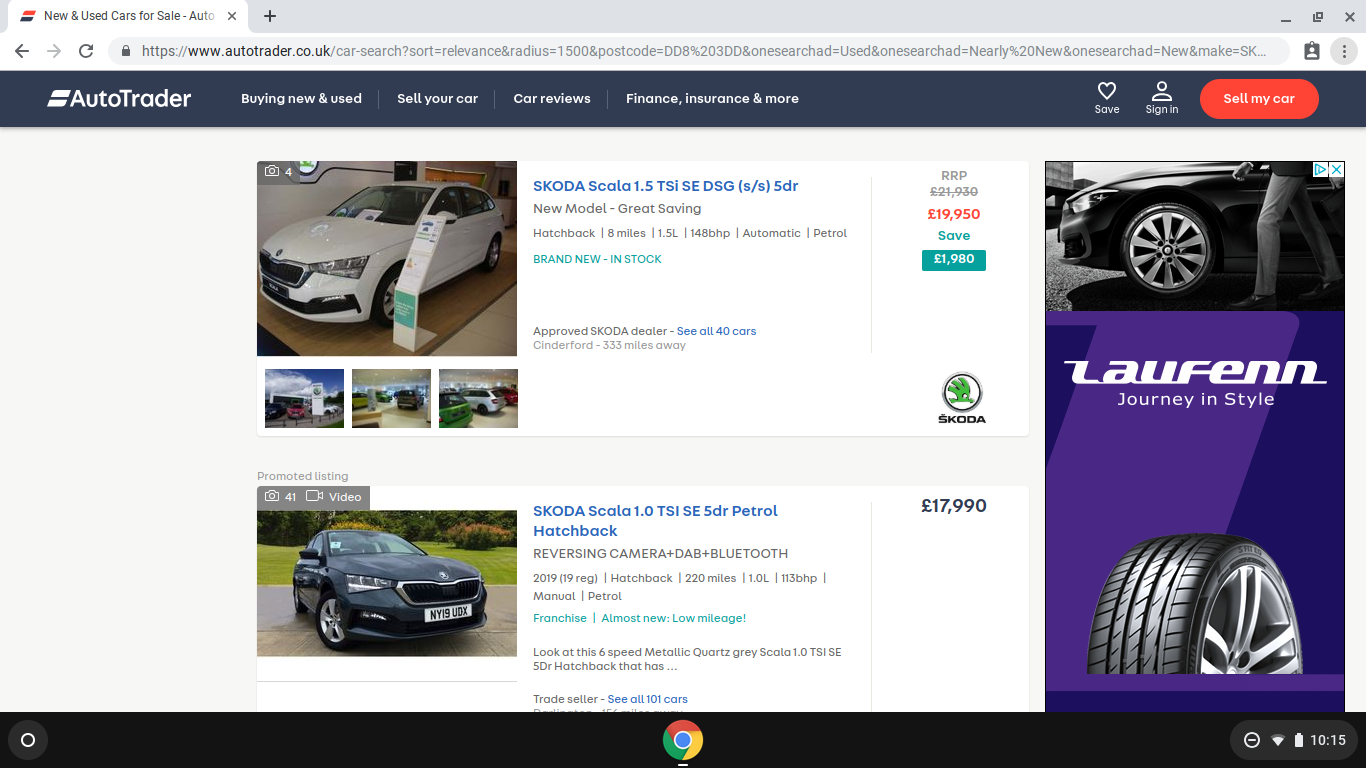

Local Skoda dealer in Derby currently has 4 1.0TSi and 3 1.5TSi Scala's for sale. The interesting fact is the bigger engine cars are all DSG almost as if Skoda UK has told dealers not to order the manual 1.5TSi as demo's.:D
Derby car 1.5TSi DSG reduced to just £19,000 already.:thumbdown:
The 7 speed DSG is often 5 grams/km better on CO2 and a couple of mpg better so less chance of it being reclassified later and getting a bill to SUK/VW of incorrect tax on selling it.

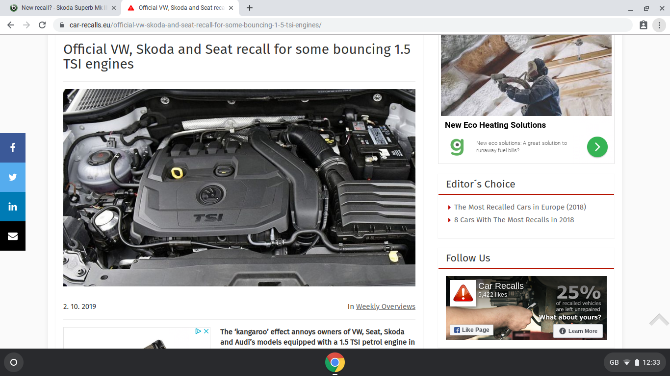

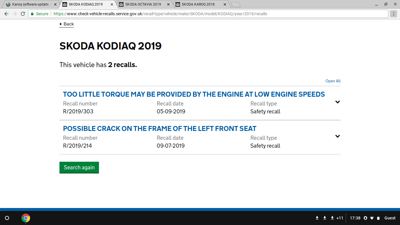

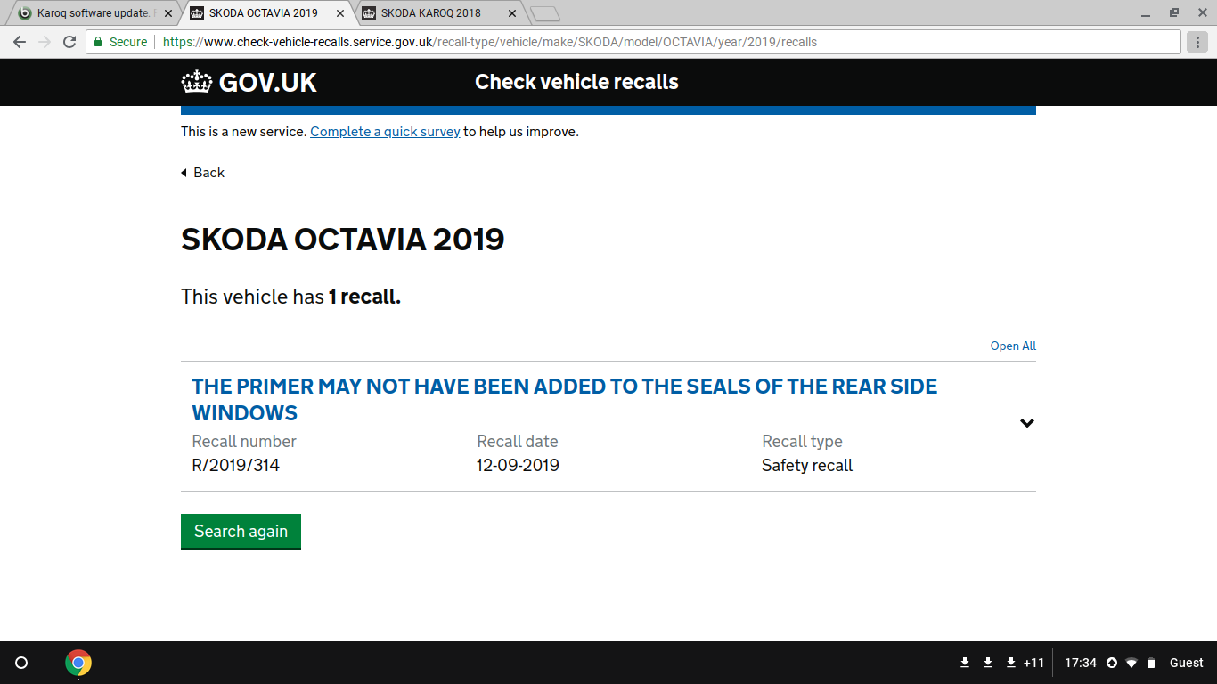

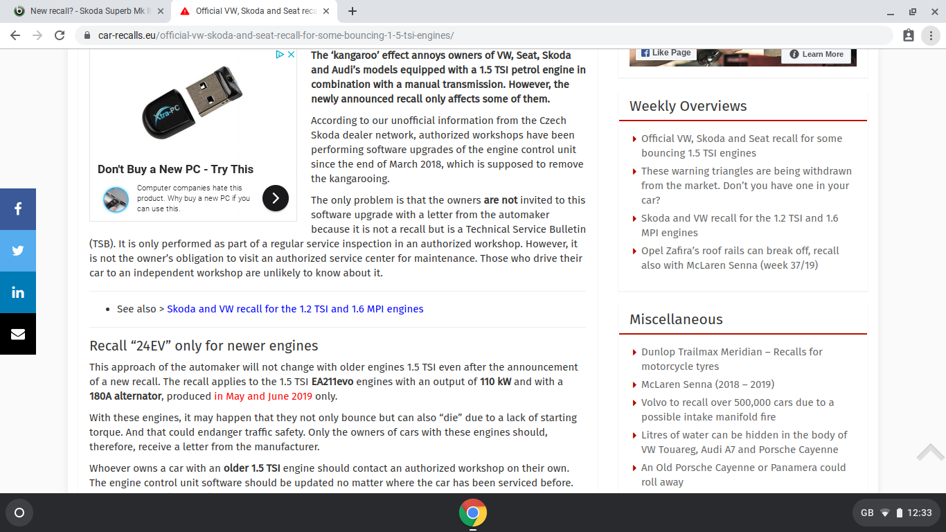

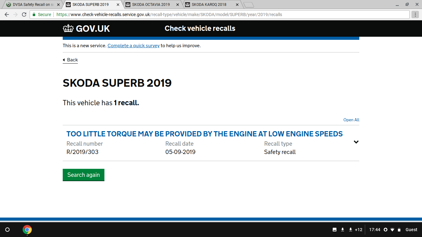

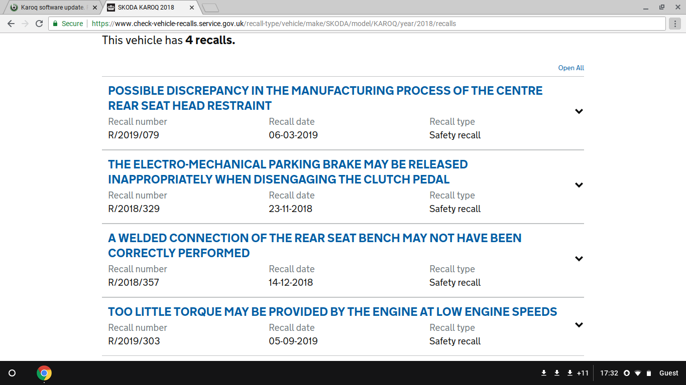

Recall or Recall Action / Service Campaign.
If VW Group have a fix for faulty ones, this is what you might expect from the latest ones with the Characteristic 1.5TSI EVO.
@ 8 Minutes.
Edited by Roottootemoot

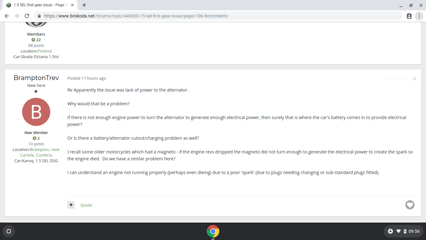

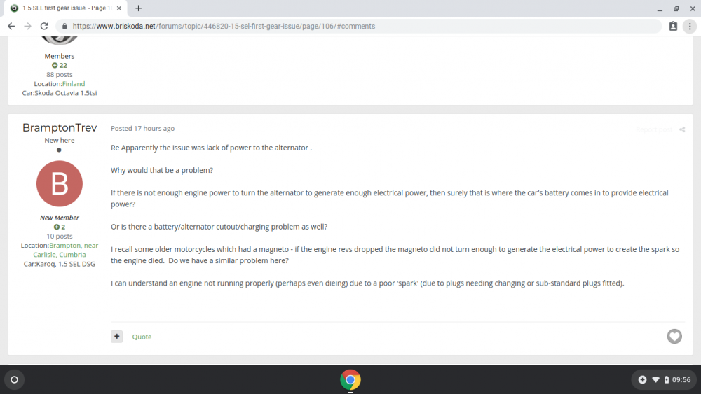

33 minutes ago, Roottootemoot said:
@pint6x

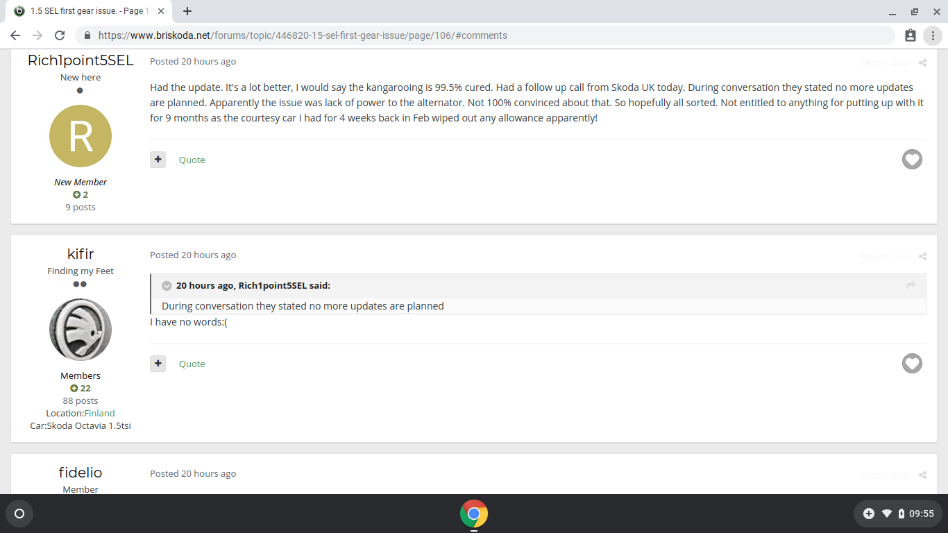

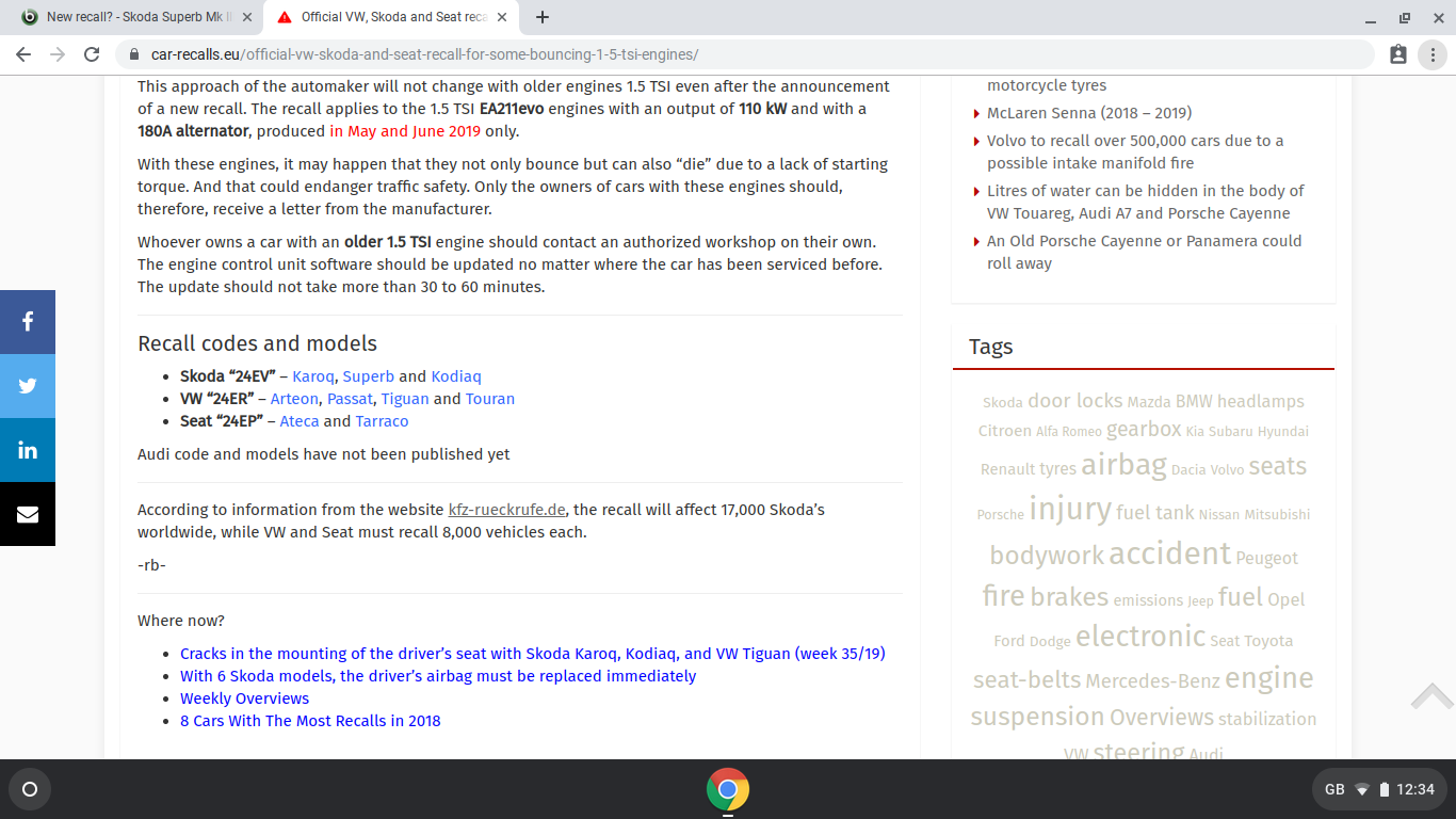

Correct, there was the 1.5TSI Manual issue that was known as Kangerooing, and then denial, and it was said not in the DSG, but it was just not as obvious.
Eventually there was a fix for some, and a 2nd fix for some, and no fix for others, and then someone from the factory says it is an alternator issue.
Point being that was then and this is now and brand new cars hitting the road. So if it is just the DSG's and not manuals that will be nice.
MauMauM.jpg.a730f8af9f11981f15b1387419a3b965.jpg.3d0cd25182f29ac829db4d9064ddc2cf.jpg.35e827417bcf600273cbd4a4ebdb8799.jpg
Ex-FIL just recently rejected his new A1 35 TFSI with this engine.
Weirdly when you look at the number affected individually  for the Superb, Karoq and Kodiaq they all say 1231!!!
