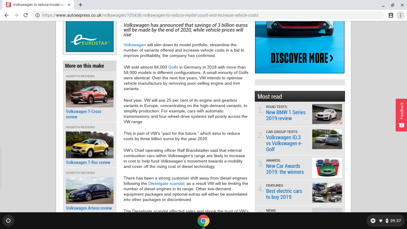

Finally Autocar  (Haymarket Media Group / Publishers) & Auto Express will have to wake up and smell the coffee and discus any issue or faults and why so many vehicles for MY20 will not have 1.5TSI EVO engines.
Is there an underlying issue, is it about WLTP Approval or RDE test results?
http://euronews.com/2019/06/26/large-carmakers-including-vw-fca-could-face-2021-eu-emissions-fines-study
Truth will be that VW Group can not get the the average low emissions under tight test regimes with some of the vehicles they got through before or after summer 2018.
