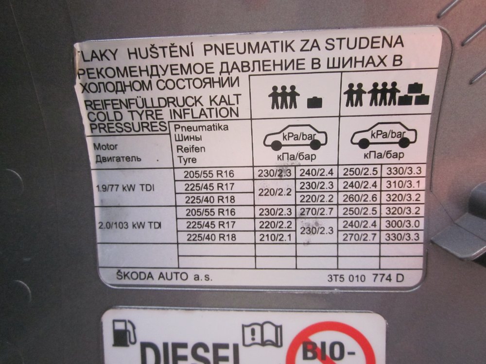

P.S: Can anyone suggest good 16 inch rims? Also, I have all four Michelin Primacy ST3 205/55 R16s. What happens if I 'plus zero' to 215/55 or 225/55 besides increased grip?
These are the only (UK) approved tyre sizes for the MkII Superb...
There are quite a few more than that: the list inside the filler flap is the most common sizes for your model but it's far from complete.
I've posted the full list of type approved sizes here:
5 hours ago, vredesbyrd93 said:
Thanks a ton, mates. The dealer owned up and it is now being fixed at a minimal cost.
If you go for a wider tyre with the same profile you'll end up with a larger rolling radius, which will throw off your speedometer and odometer. The profile is the percentage of the tread width: sidewall height of a 205/55 is nominally 113 mm (205 x 55/100) while a 225/55 is 124 mm. If you want to maintain the rolling radius, 225/50 is about the same as 205/55.
