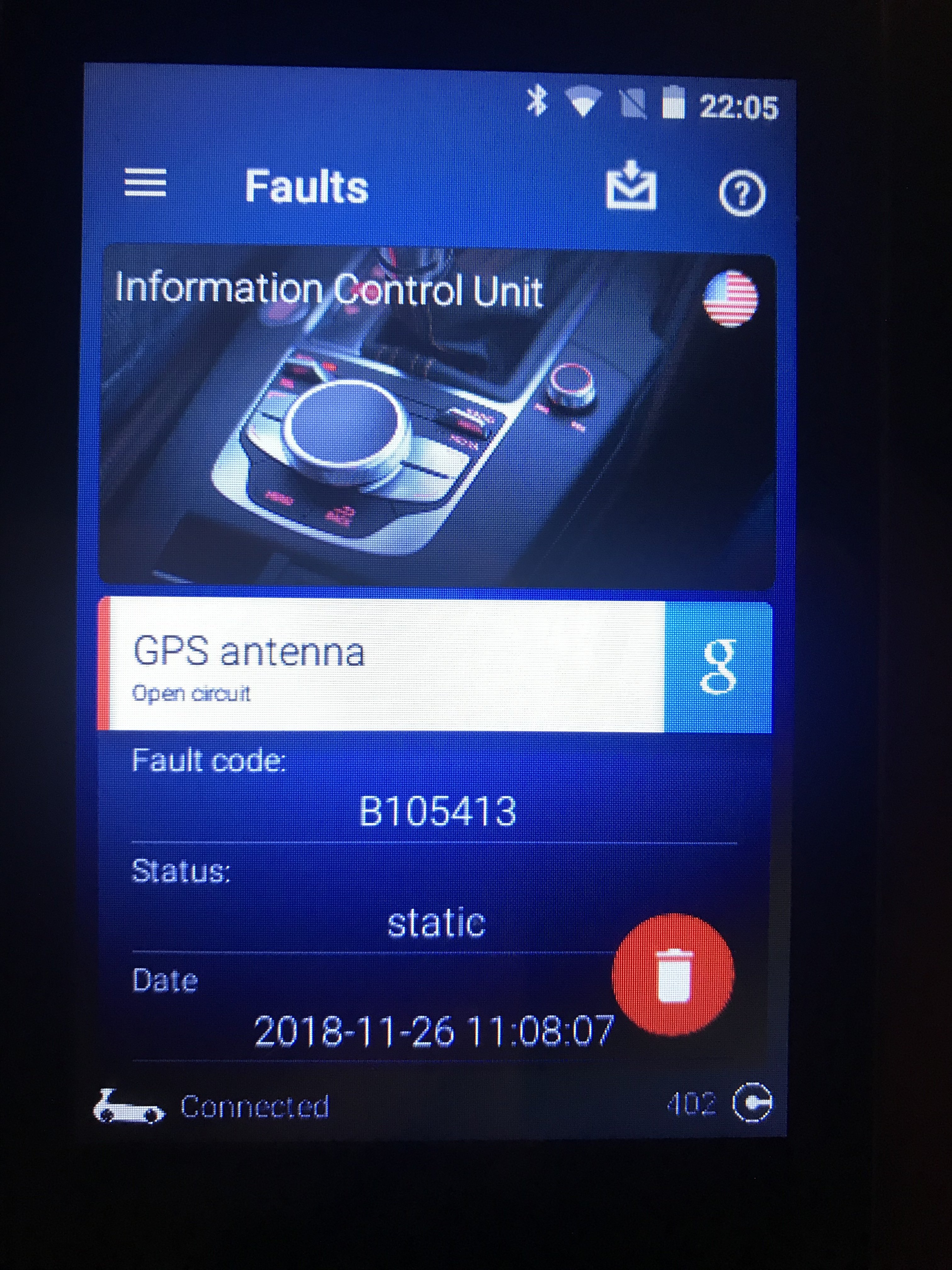

I scanned the car today and this is code, not much help to you I’m afraid, but my nav works fine even with this code showing.

Been told by skoda doesn't seem to be an antenna problem seems to be a wiring issue they said they will be having a look at the wiring from the antenna they charged me £93.00 for a diagnostic which still could not pin it down, car goes back in on Friday 14th and I get a courtesy car they say they will take the head lining down from the rear, they said they don't know how long that will take, I said my mate who owns a removed the head lining from the rear in about 10 minutes, as I said my mates diagnostic equipment said gps antenna not grounding, I asked if it would be covered by the warranty she said they don't know until they have a look, I'm dreading the price lol
Just an update good people, skoda now say it is a shark fin gps antenna problem it's in there now going to cost £178.00 all in parts under warranty, wiring not, did not charge for diagnostic check, they said they would have to reboot and reset the ecu back to factory settings pick it up this Friday afternoon as I'm on an awkward shift this week so can't get down there until then,

All sorted good people regarding the satnav they replaced the gps antenna
