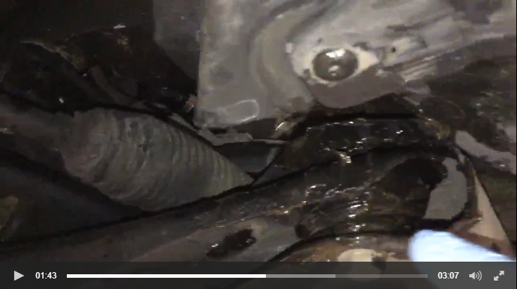

They provided evidence of the work, here's a (fuzzy) still taken from the video:
Looks like they went a bit nuts with the grease!
That is a rubber to metal bonded bush, unless the bolt has not been tightened there will be no metal to metal movement, they should never be greased because it would degrade the rubber at least in the old days before synthetic compounds.
A complete bodge in my opinion, any creaking will be due to excess deformation of a tired or failed mounting causing metal to metal contact which they are trying to avoid by the bodge of slapping grease all over it, I am shocked that they would give you a video recording of their bodging, even more so if there is a TPI (another acronym I dont know but am assuming its a technical service instruction) suggesting it but nothing about VAG these days would surprise me.
On reflection another possibility is a design fault that allows metal to metal contact during certain combinations of steering angle and suspension loading, slapping grease all over a modern car to cover up design faults, what next? - Grease nipples, total loss chassis lubrication systems?

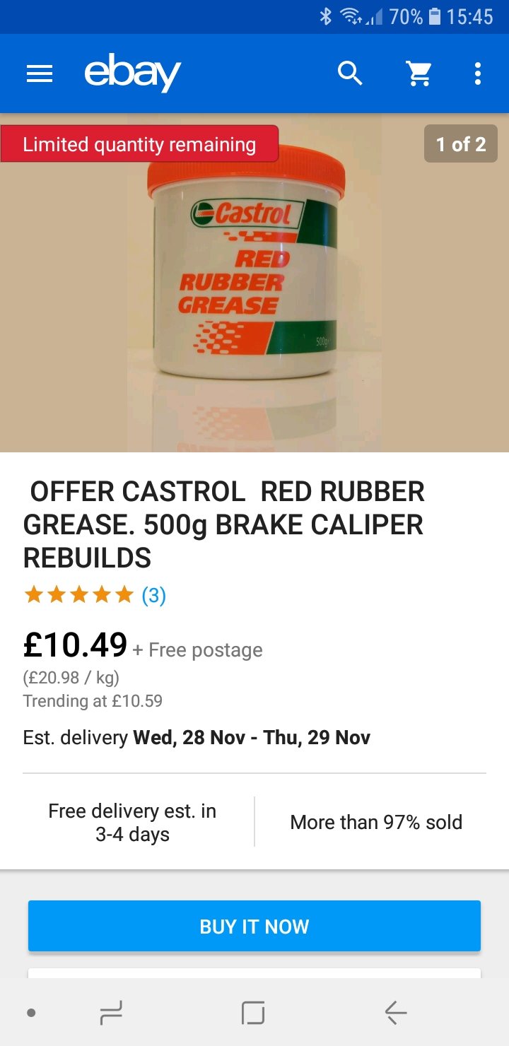

J.R. stop talking nonsense.
I'm not sure if that was a tongue in cheek comment but I will bite anyway.
There is a world of difference between a brake piston seal which is a moving part running against a steel bore and will need initial lubrication before the brake fluid is introduced and a rubber to metal bonded bush where there is only flexion of the rubber, no moving parts in contact.
