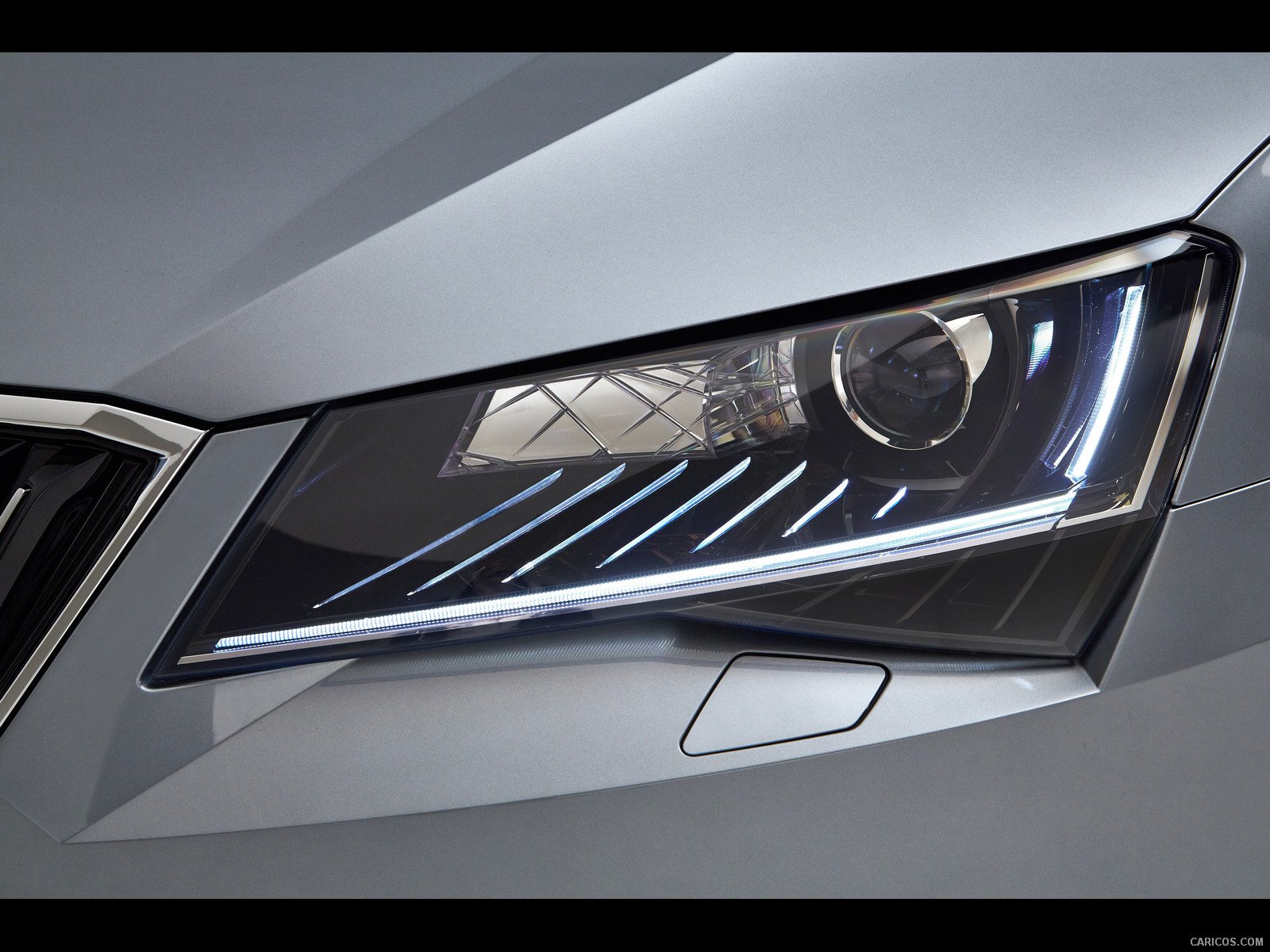

So, my SportLine has xenon headlights that move when I steer. I have noticed that it has transparent ‘whiskers’ in the headlights but they don’t seem to lights up, is this normal?

The whiskers only come with the 'smart light assist' option, the all singing all dancing shadow technology ones not the simple light assist which simply switches between high/low beams.
i dont know the sportline spec but I doubt it gets the smart light assist as standard.
Only L&K gets smart light assist as standard.  And even that only after 2019 model year.
I’d be interesting to see how they light up the whiskers. They are translucent so light should shine through them. Probably more hassle than it’s worth but so many things are, yet we still do it!

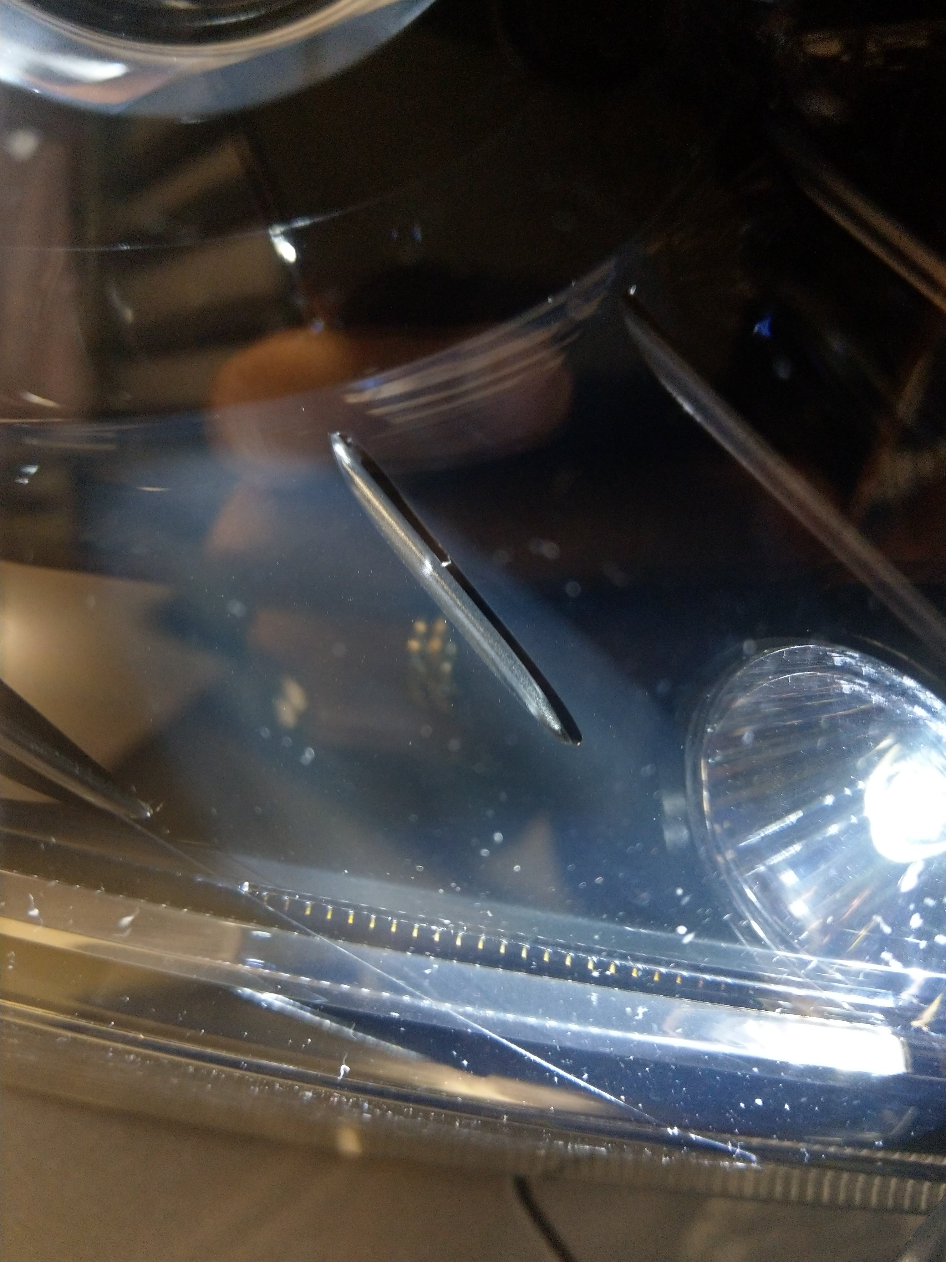

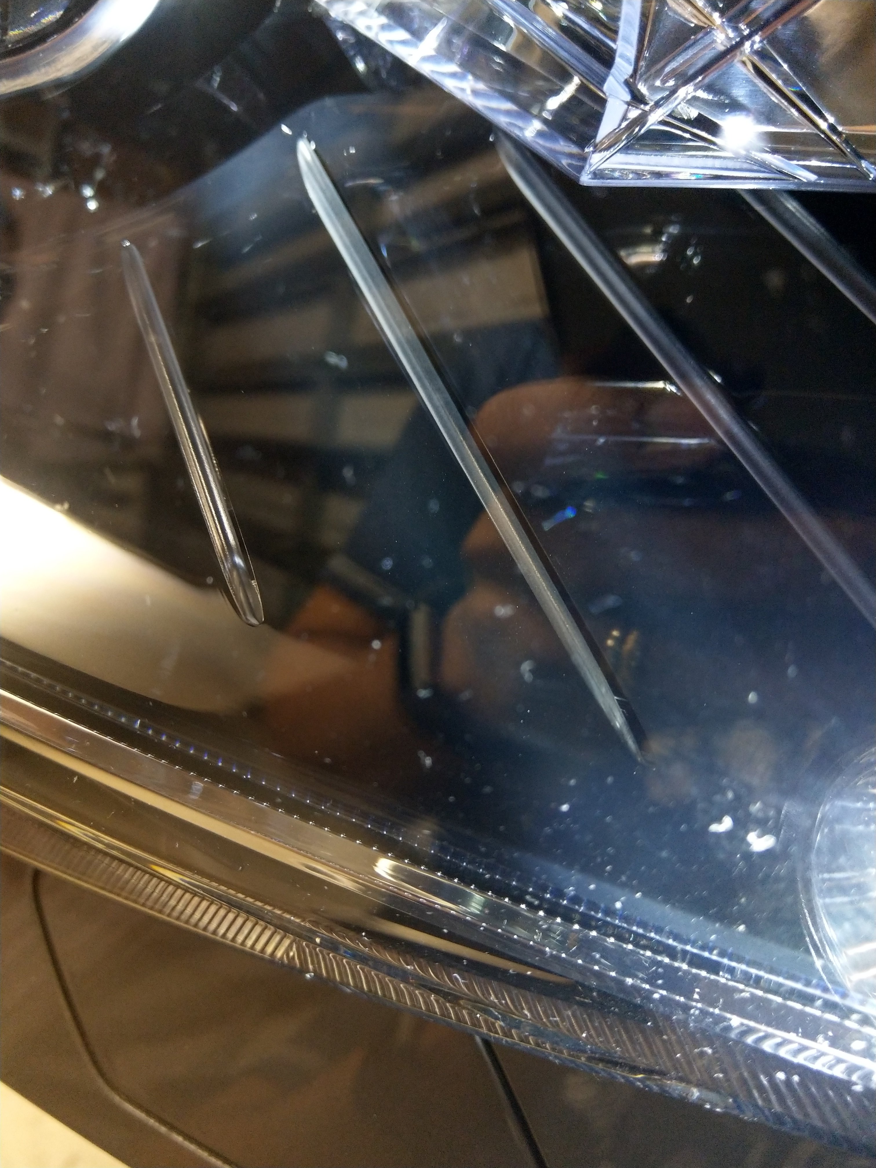

Here's mine.  You can see it's translucent, and it's separate to the black bit of headlights.
I currently have the "A" version of headlights.
I'll b retrofitting a set of "B" versions this Xmas holidays.
I'll also b experimenting with the LED controllers that come with the B version, by putting it on my existing As, to see if they get the whiskers going.
Actual SLA will require the hardware of B.

can't b enabled just via VCDS - i tried.
i'm assuming there is something to with the LED controller under the headlight and/or the wiring harness.
