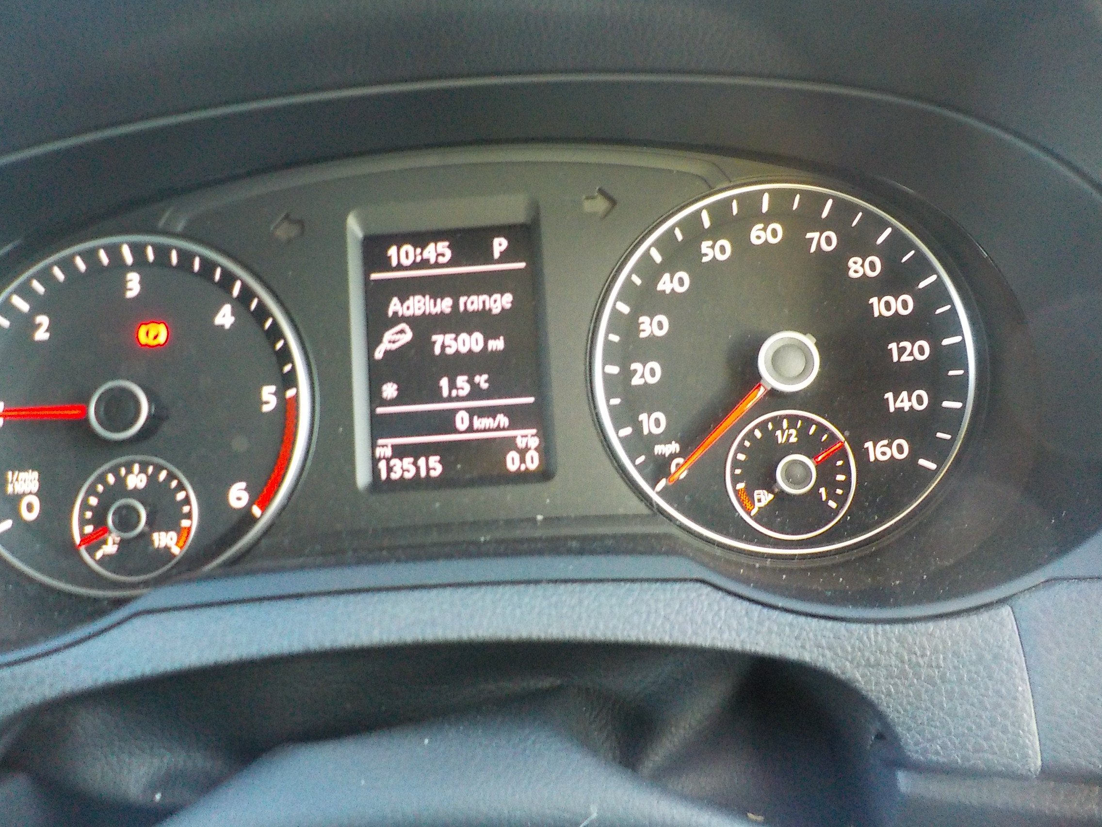

My 1.6 TDI was down to 1500ml range
Put 3.5 ltrs and range did not reset
Just put another 9ltrs in making total 13.5lts and it’s reset showing 7500 range.
DONT forget to switch ignition on for 30 secs but don’t start engine or reset won’t work.

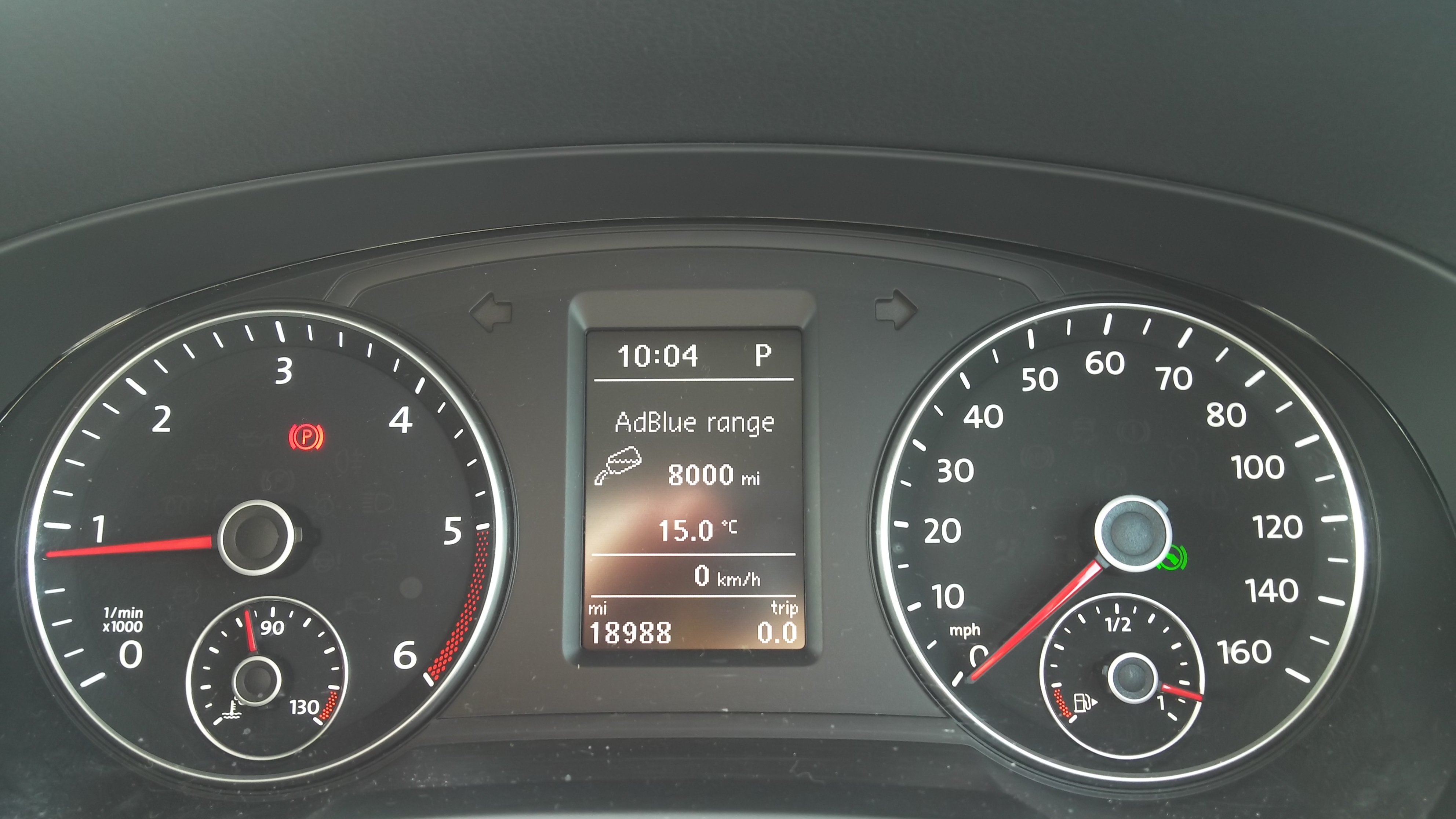

Anyone got a handle on how many thousand miles per, say, 10 litre AB container?   My car started at 5,500 “range” when new and has been counting down pretty faithfully, but no idea how much was in the AB tank when I collected her.
@DSL
If it showed 5,500 miles when collected you might find when you top up to capacity or near it then shows 6,000 range, then next time 6,500, then maybe 7,000.
VW Group continued with 'cheats' in the software and making the AdBlue get sipped as the miles go on the vehicle.
It does depend obviously on how a TDI is actually used.
As will be the case of maybe or maybe not getting Blocked DPF' warning lights. Depends even with the latest vehicles on how often driven and how many cold short trips the engine / emissions system is doing.

Mine seems to go about 6500 - 7500 on a tank of AdBlue. It uses more over the winter, probably because of lower exhaust temps.
