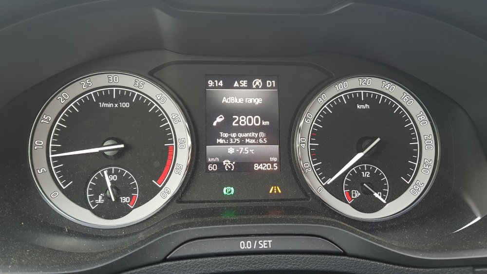

Hi,
Can someone tell me how to interpret the Min and Max top-up quantities of AdBlue?
How much liters can I refill?
Thanks,
Gabi
Edited by Gabi4
You need a minimum of 3.75 litres to clear the reminder, and the tank will accept a maximum of 6.5 litres.
You should add 6.5 litres, or any amount between 3.75 and 6.5 litres.
-7.5 degree Celsius, where are you!?
Edited by silver1011
Thank you, silver1011! I'm in Romania.
