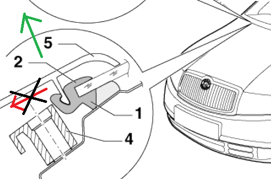

If you're pulling that trim off, be careful when you detach the windscreen edge of it.  It's tempting to look at it and think that the whole trim slides off the windscreen, but actually the detachable bit pulls off at 90° to the glass surface. There's a tongue in the removable trim (5) that fits into a groove in the part that's left behind on the screen (2, 1).
Maybe it's obvious to others, but I spent a while failing to spot it recently. A picture's worth a lot of words:
Edited by Wino
^ this. For me it was hard to click trim 5 back into profile 1,2 (despite groove was clean). Profile bounced down (and there’s no way to support it) and no click! Tried to tap trim fast & gently, cm by cm- and till middle all worked fine... till I made crack in windscreen with this tapping. So without serious reason will not touch that trim again.
Debris under trim? Strange, but after many years everything here was quite clean. So I broken windscreen for nothing :-DDD
A bit of washing up liquid on the tongue that pushes into the channel helps a lot. Washing up liquid is incredibly slippery.
